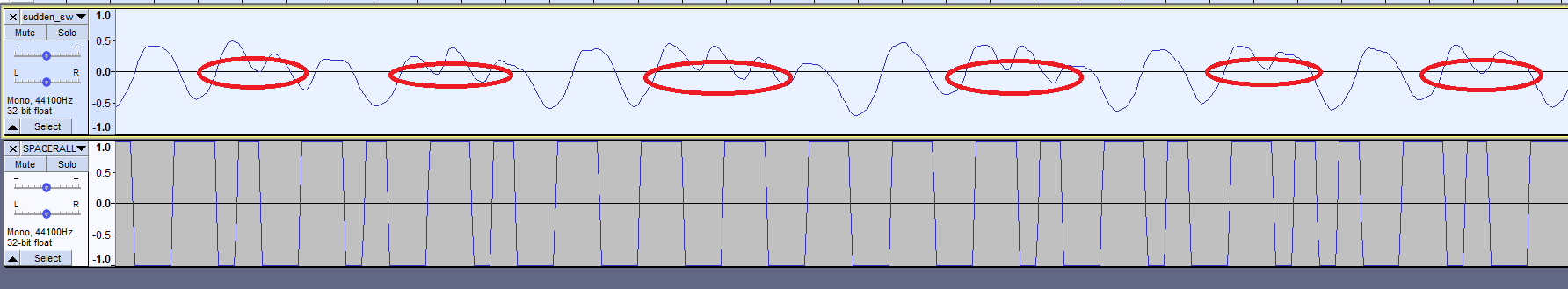

On the other hand, "sudden_sway.wav" which sounds very much like a MZ80 K program is un-extractible:
LONG:20;tick0=34.1;tick=21 <--- LONG20!?
SHORT20:19 <------------------- then SHORT20!?
And it exits with no further informations.
Looking at sudden_sway waves, they are bad (see circles) so saturating them to ease transformations is almost impossible. it needs to tracks peaks and square them to 1.0 when max and to -1.0 when min.
