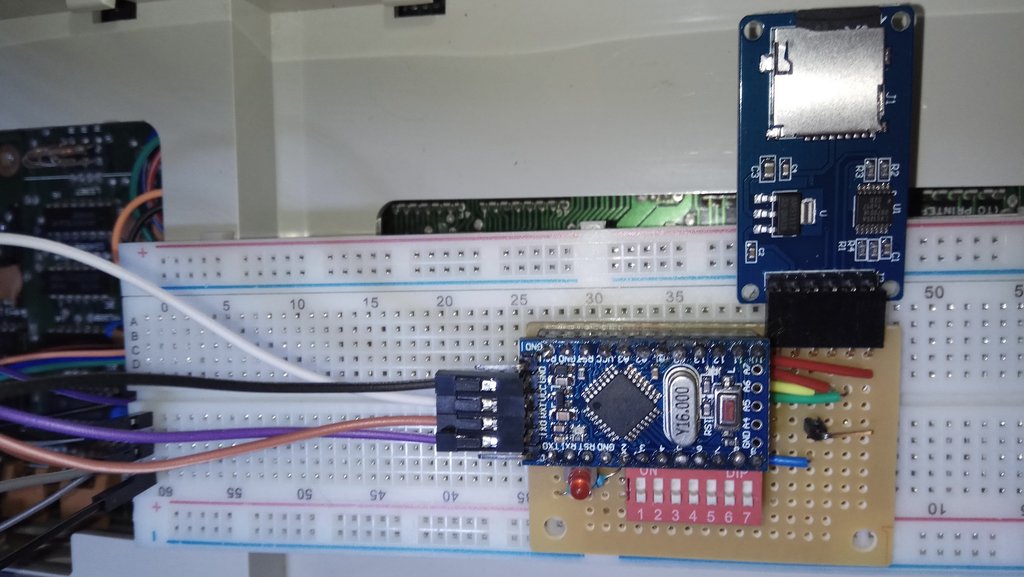

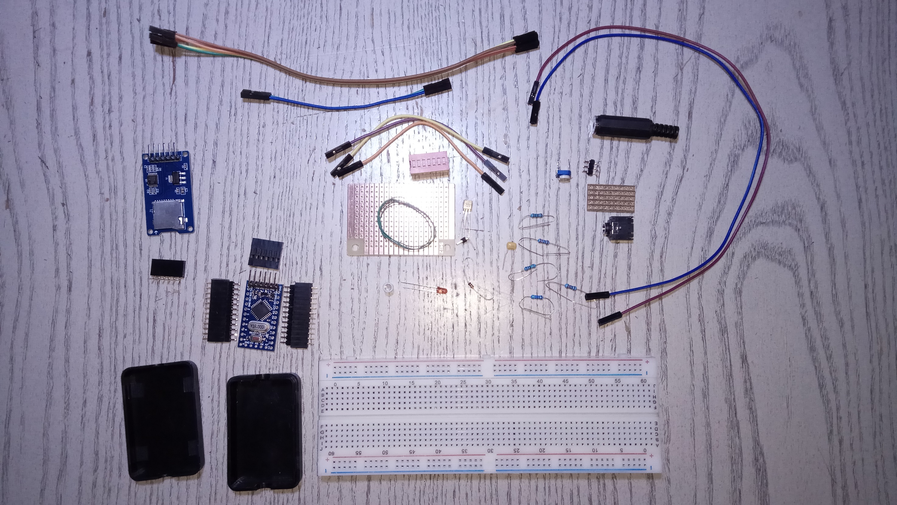

So I received some components (breadboard excluded):

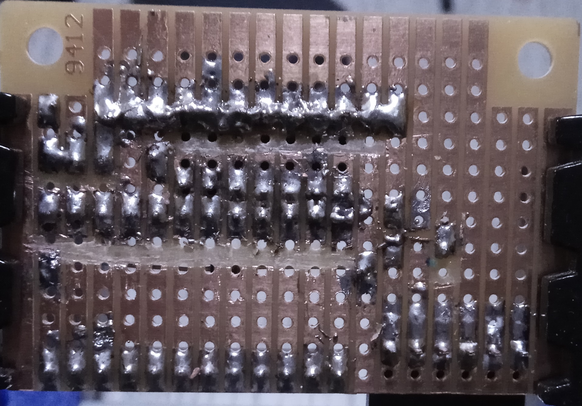

Starting soldering:
First try:
Right now, I need to connect MOTOR and SENSE signals to GND so SDLEP-READER can transmit contents but that's not the way it should be done. So, I ordered an Arduino programming tool so can modify the firmware to handle the signal MOTOR the right way.
The delay granularity used by the Arduino firmware is 50 µS which excludes the ability to handle 3600 baud for instance. I hope the granularity can be finer to allow higher speed than 2400 baud.
