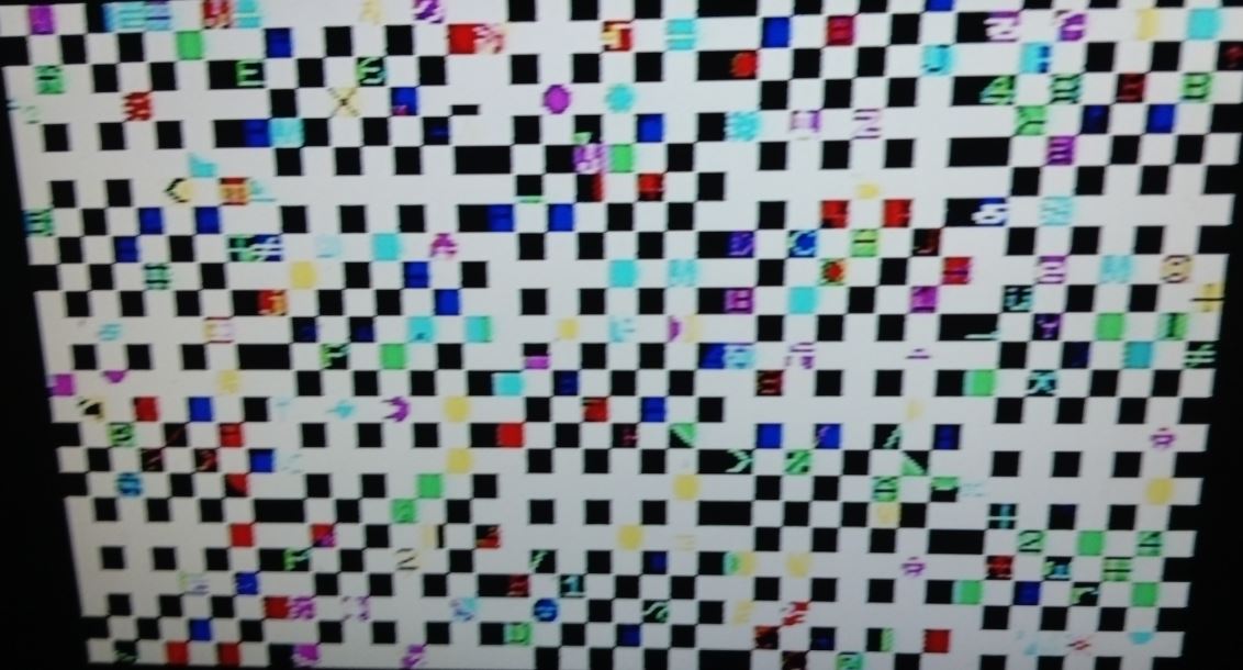

I'm trying to resurrect an old MZ700. Have got the power supply working but the video output is scrambled - see photo.
Note that the picture is not entirely random, it's identical each time I switch the machine on.
I was thinking RAM maybe?
Any ideas?

I had a similar problem with one of my MZ-700 and removing, cleaning the connectors and reconnecting the CG ROM re-worked.

I have a similar issue with my fourth MZ-700 (bought as such). I tried to swap every IC (CPU, ROM, CGROM) to a working MZ-700 and they work. In the meantime, the PSU on the problematic MZ-700 broke. So I suspended my trials. Pacman, I'm surprised it was an issue with CGROM because you can see characters well, which means address decoding and output data seem good on the CGROM. I would think it might be an issue with VRAM which gave random attributes (apart from a periodical $FF or $00 to give that checkboard?) and characters.

It is quite possible that it is VRAM. For my part, I juggle the CG and Monitor ROMs that I reprogram, and I only say what I see. Besides, we must add in my previous message the same thing for the ROM monitor this time.

I made some tests, and those that reproduce a blow on the problem, it's a defect in the MONITOR ROM, i.e. when I remove the ROM and I restart the machine, it locks in exactly the same way on the random display of characters and colors on the screen without doing anything. I'm investigating a problem with the ROM MONITOR to be replaced by a freshly programmed ROM. (MONITOR 1Z-013A)
It makes sense since the MONITOR does not run, and the VRAM memory is not initialized.
Certainly the machine is working properly.

Hi Pacman, you are correct. If I remove the ROM it's exactly the same.
