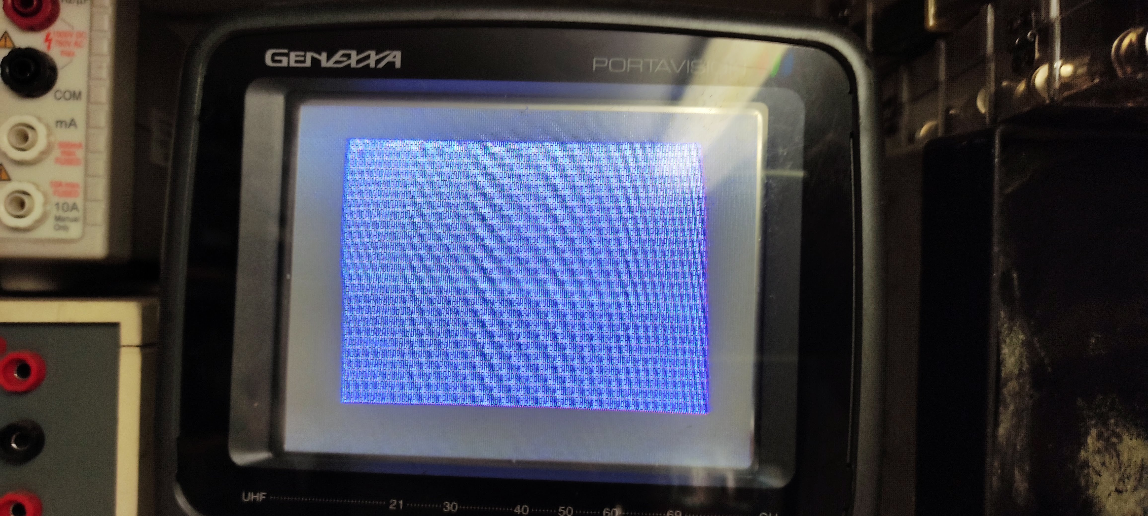

Thanks, sadly the link returns PHP error, bad file/directory permissions or invalid site software configuration
I was going to attach the bin of my rom, but that's not allowed either.
So it's here: https://1drv.ms/u/s!Aq35rJMV1i5Fgu8vCWd ... w?e=DXmzYO

Wild goose chase I'm afraid, your rom is fine.
Do you see some kind of flashing on the screen, reminiscent of a cursor and if you press keys does the screen change? This is what I was getting on the 80A hence the CGROM being the culprit. If your just getting random characters up then like hlide points out, could be DRAM and the monitor isnt starting up and clearing the screen, albeit in saying that, on the MZ-700's I have, if you remove the CPU you get multicoloured and multi character output not a blue pattern like you have (blue is the value written into the attribute ram). This in itself is a good pointer as the monitor rom, in order to fill the attribute with blue background/white foreground makes a call so the stack appears to work and by association the DRAM.
The only other culprit would be the 2016 static RAM chips used for the video (check by pressing many keys and seeing if the screen changes but to random values) or IC 8D (74S245) which reads/writes to the video ram but given you have a blue background it is less likely to be this IC.The rasterisation of the character is done by the gate array driving the lower CGROM address lines so a possibility.
Simple quick test, remove the Z80 and power on, what do you get on the screen, if multicolour and multi character (clearly visible characters) then it shouldnt be the video output circuit. If a mush of pixels then I'd say potentially the gate array Q1-Q3 lines as the CGROM isnt faulty. Try some of these checks and we can analyse further from there.

Just rechecked the circuit and the attribute ram is driven by IC AD (74LS245) and the video by IC8D so this could be a potential candidate. Your screen output is white on blue so the attribute ram must be getting written to under software control.

Thanks again. I can see the characters changing as I type, and there appears to be some sort of cursor.
Thanks for checking the ROM. The 74S157 multiplexer should be here today. I've got a dirty great Luxman amplifier to finish and get off the bench, so hopefully I should get to it again at the weekend.

Well, that took a little (a lot) longer to get done, but I'm back. I've fitted the new 74S157, and the display is still corrupted, but it never changes now on reset or power up, so that's something...
No I need to know where to start looking next .. We know the CG ROM is good, so where do I need to investigate next ?
