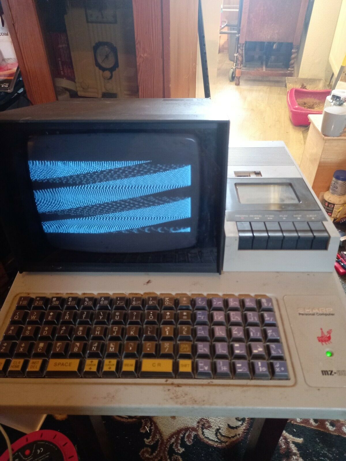

I have just purchased a MZ-80K from a well known auction site and waiting for it to come but it has got issues I am wondering where to start first to get it up and running this is the picture he has posted for selling it so dont know if anyone can get any ideas from it he describes it as screen full of lines.

when you open the case, you can see under the screen some potentiometers to control horizontal and vertical synchronizations.

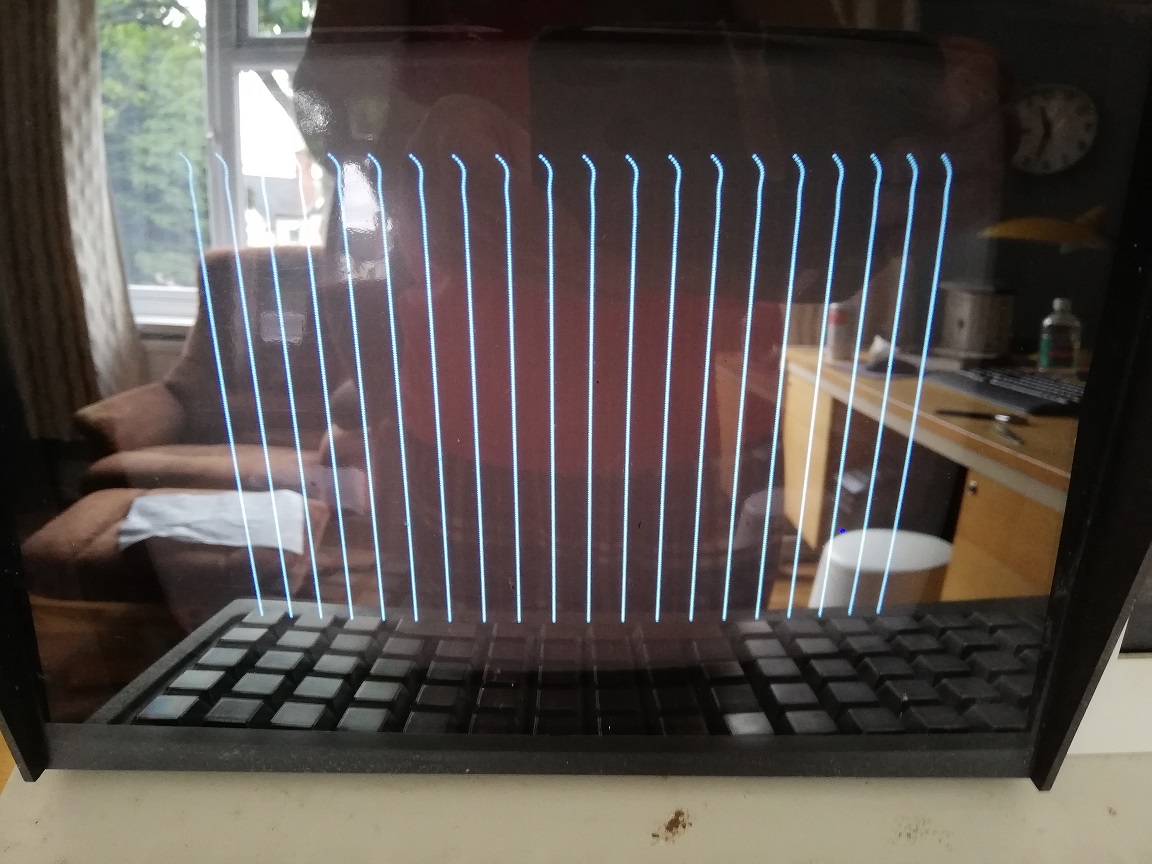

Now sorted the power supply by replacing some of the caps and getting correct voltages so now when I turn it on I get straight lines that move side to side any ideas?.
Posts: 681
Re: MZ-80K where to start to repair
That doesn't sound as regular characters. Could you make a short video to see how they move? I count only 20 lines.

Can I suggest you to unplug the CGROM temporarily to check what the screen displays?

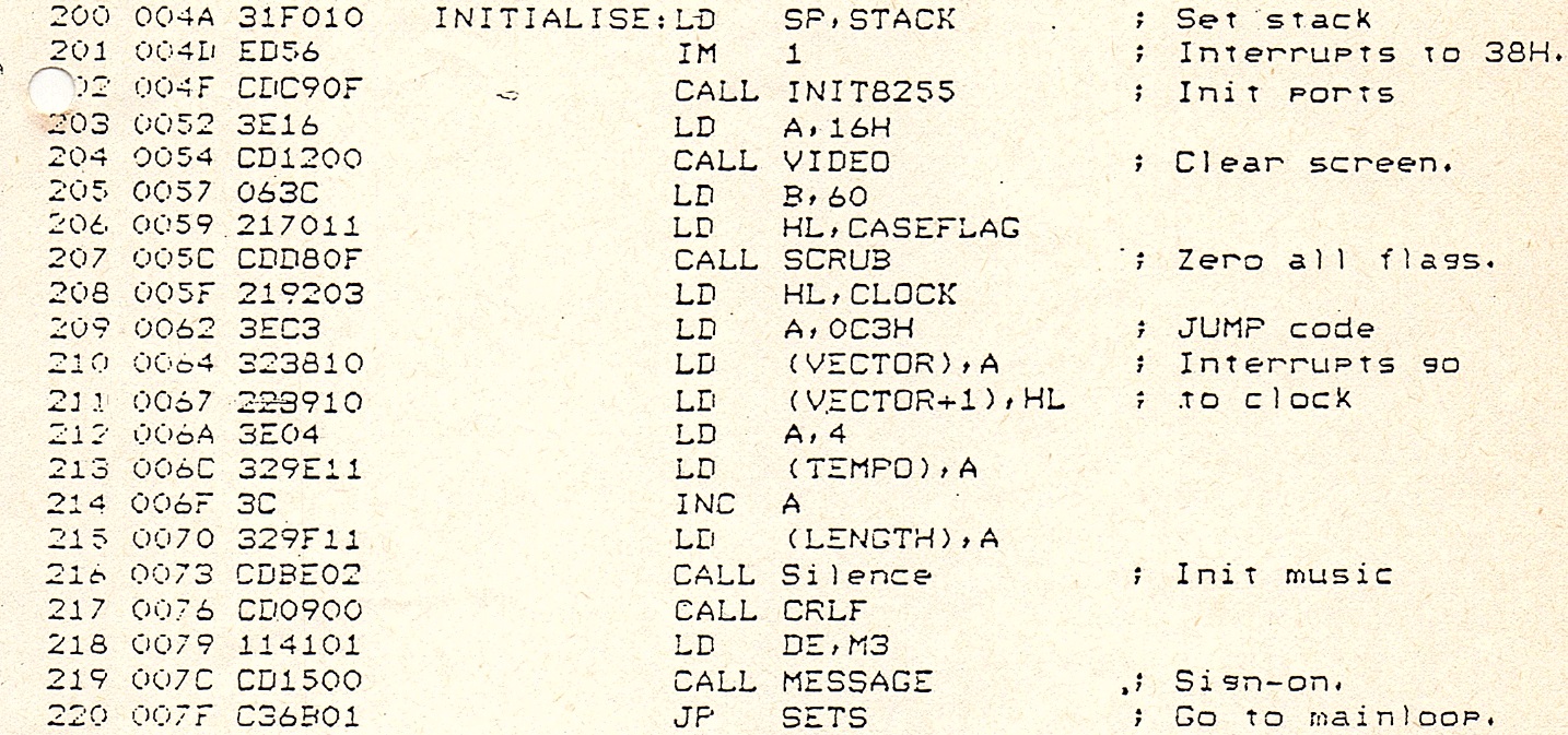

I included part of the K's start up code to show the subroutines called.
As the start up message is not displayed the Z80 may be hung in the Call silence subroutine.
