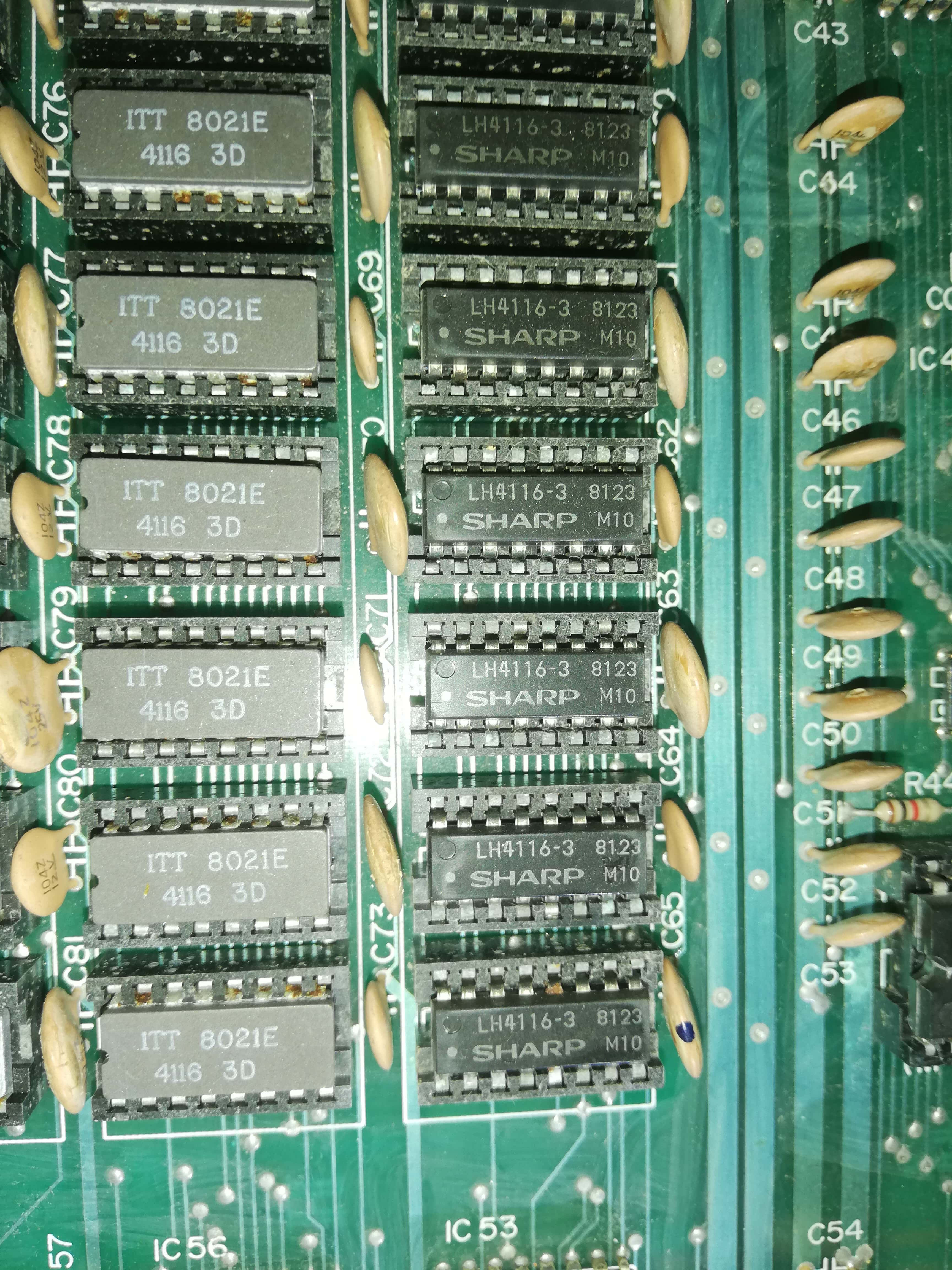

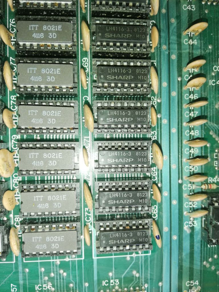

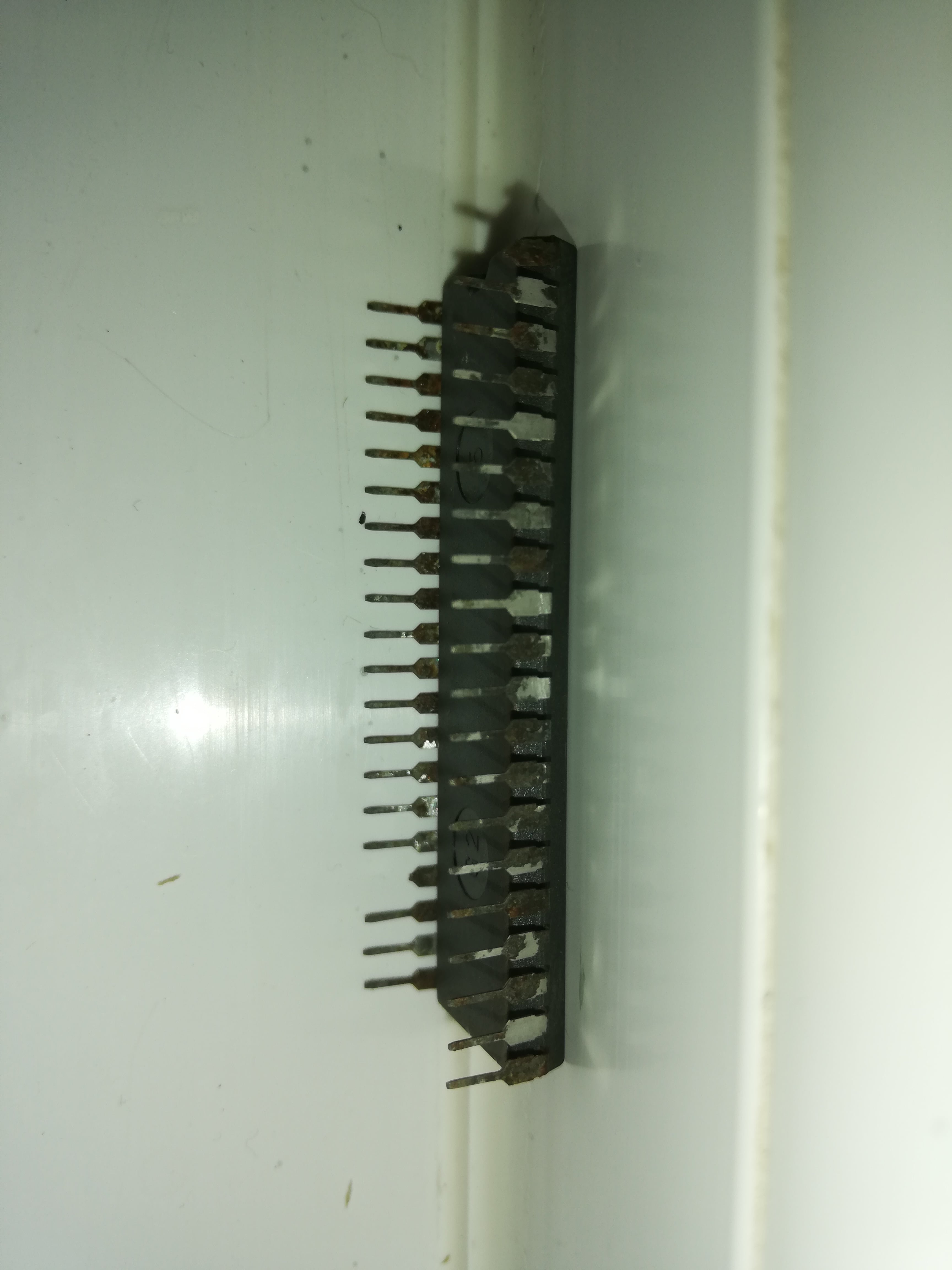

most of the socketed chips are like this and when trying to give a light clean legs fell of some of them so not ideal
Re: replacement parts for MZ-80K help needed
There might be few ways of cleaning this kind of corrosion. Bath in ascetic acid (sometimes helps), and scrubbing it with some kind of abrasive material... fiber glass or brass wire pen. You might easily bend or break those pins though, especially those heavy corroded, so watch out.
As others already said before, replacing sockets.. and checking for corroded tracks.
Fortunately most of those chips are still available. Though many as new old stock/used chips with chance of fakes.

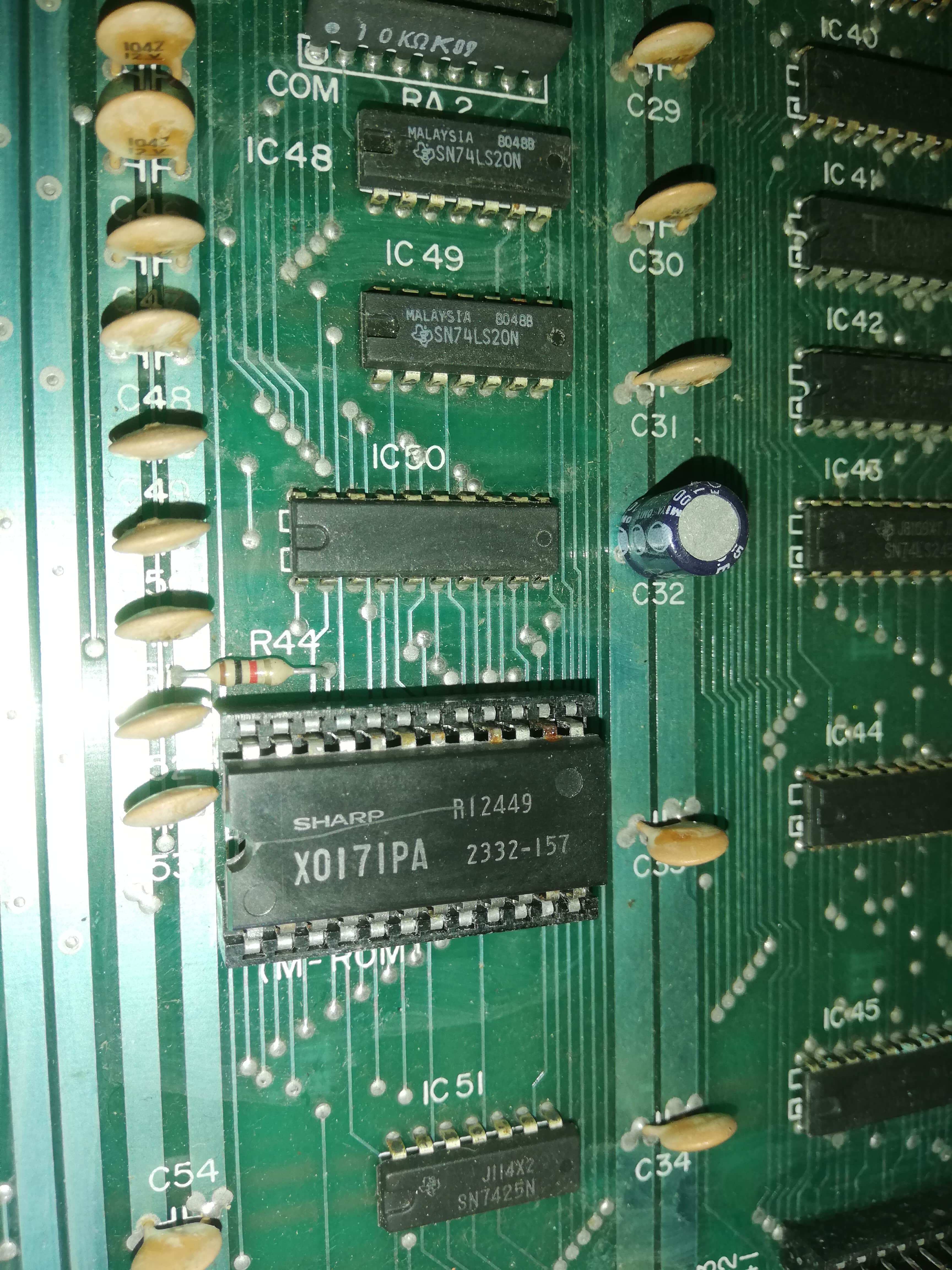

On the Roms I see that the CG-rom is a HN462716G epprom but what is the M-rom thinking about getting a epprom burner if I need to replace these but are there any images for these roms out there or does anyone have them.
M-ROM is monitor rom 4KB prom that looks like 2332. Finding pin compatible (e)eprom replacement for it might be a bit tricky.. adapter might be needed
