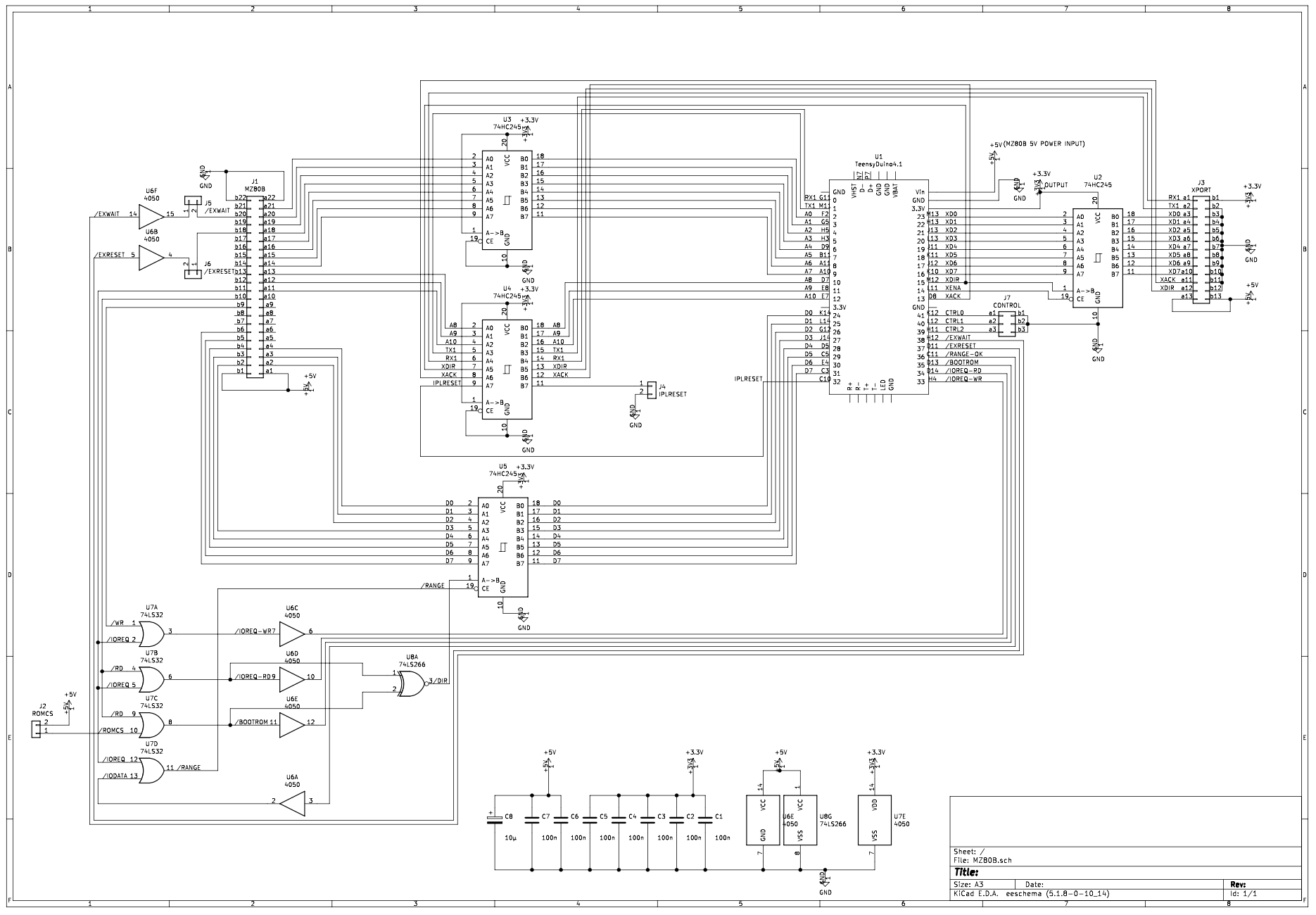

I already have made an interface card with a teensyduino 4.1 to allow access to usb, sd card, flash memory. It's already communicating
properly, but i need some more documentation and tools to reverse engineer the way the disc is accessed. I already made the emulation of the
floppy disc controller chip, but without a copy of the assembler, disassembler, linker, and other tools, it's difficult to debug and progress.
But generally, i search any software that could run on it...
The card i am designing will also fit normally 800, and 2000 models

Thanks, should be great if you can end me that, by the way, i don't have the floppy disk interface (it is originaly the reason why i began to work on an interface with a teensy 4.1 to get floppy disk emulated with a sd card at the back.
P.S. you can find in attachment a first version of my teensy interface (working one...)
Have a nice day

I like the teensy devices, pjrc were the inspiration for me using the K64F on the 3.5 module rather than the usual ST32 mpu suspects! Would be good if you complete the project to share it. The MZ-800 and MZ-2000/2200 share the same floppy interface so very useable. I'm just in the process of completing a replica SFD800 Floppy card, boards have arrived, GAL re-designed and tested, just waiting for some parts: viewtopic.php?f=3&p=2078#p2078 - Once I have a working SFD800 card anyone who wants a PCB I'll post at cost.
