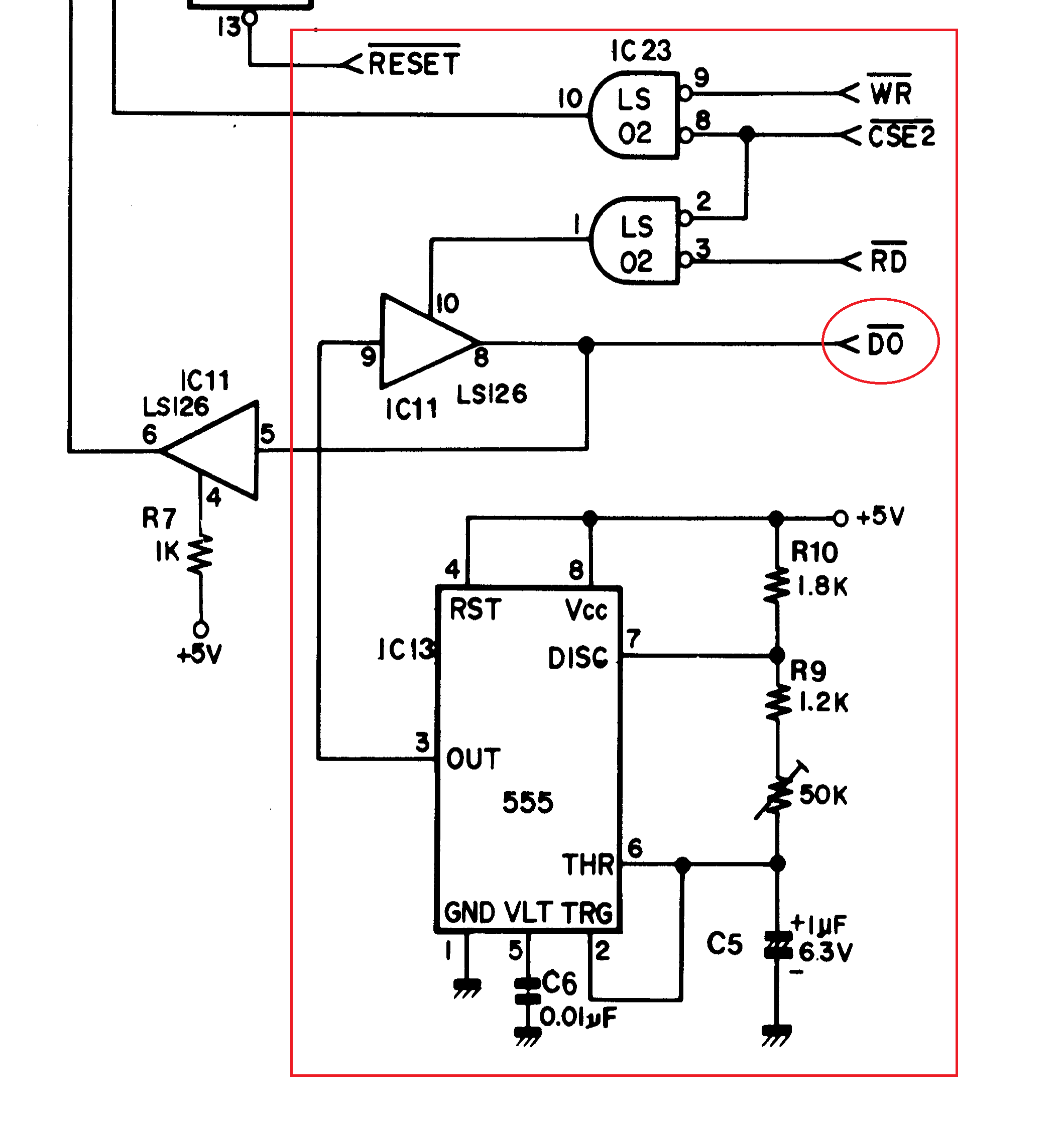

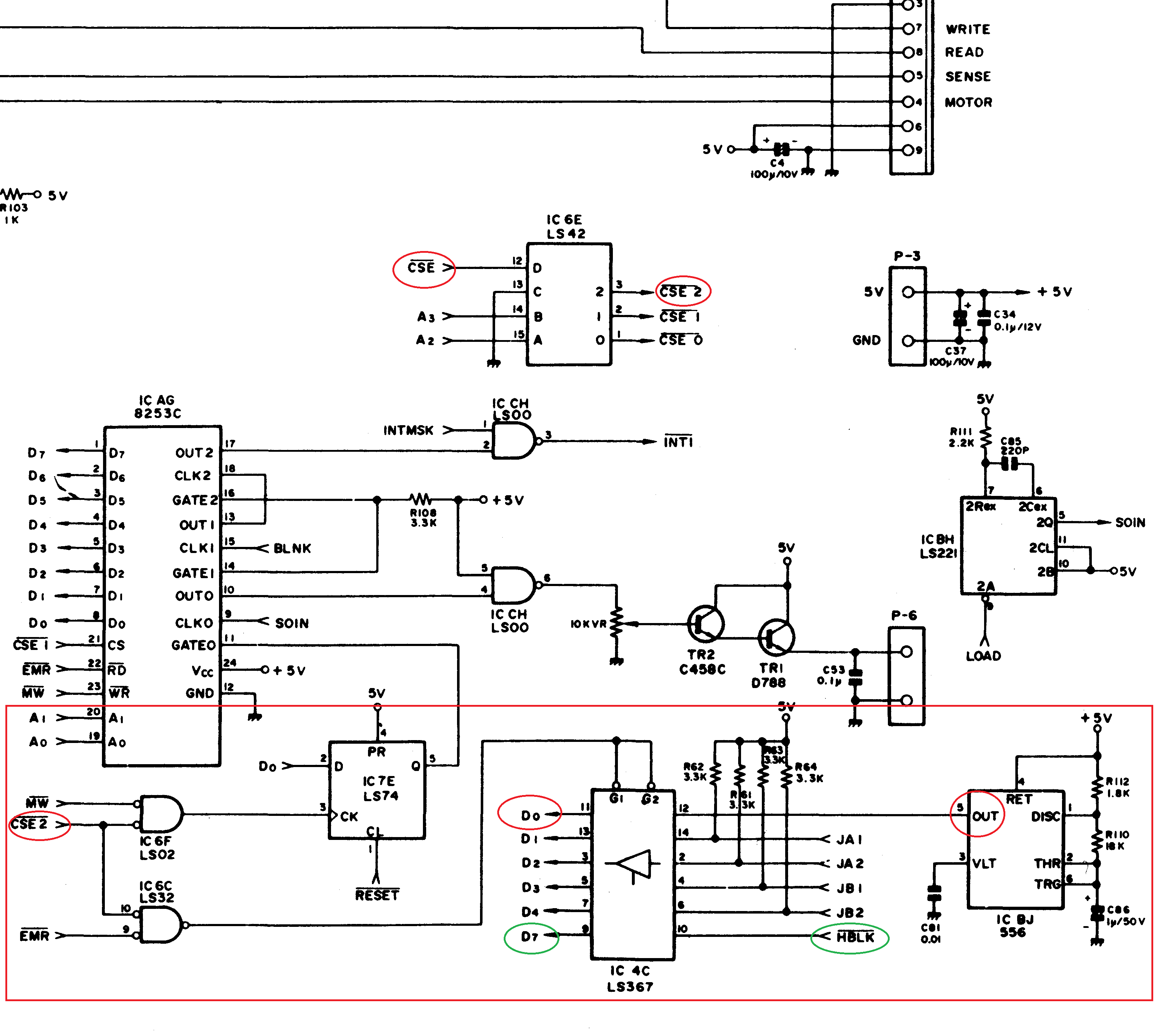

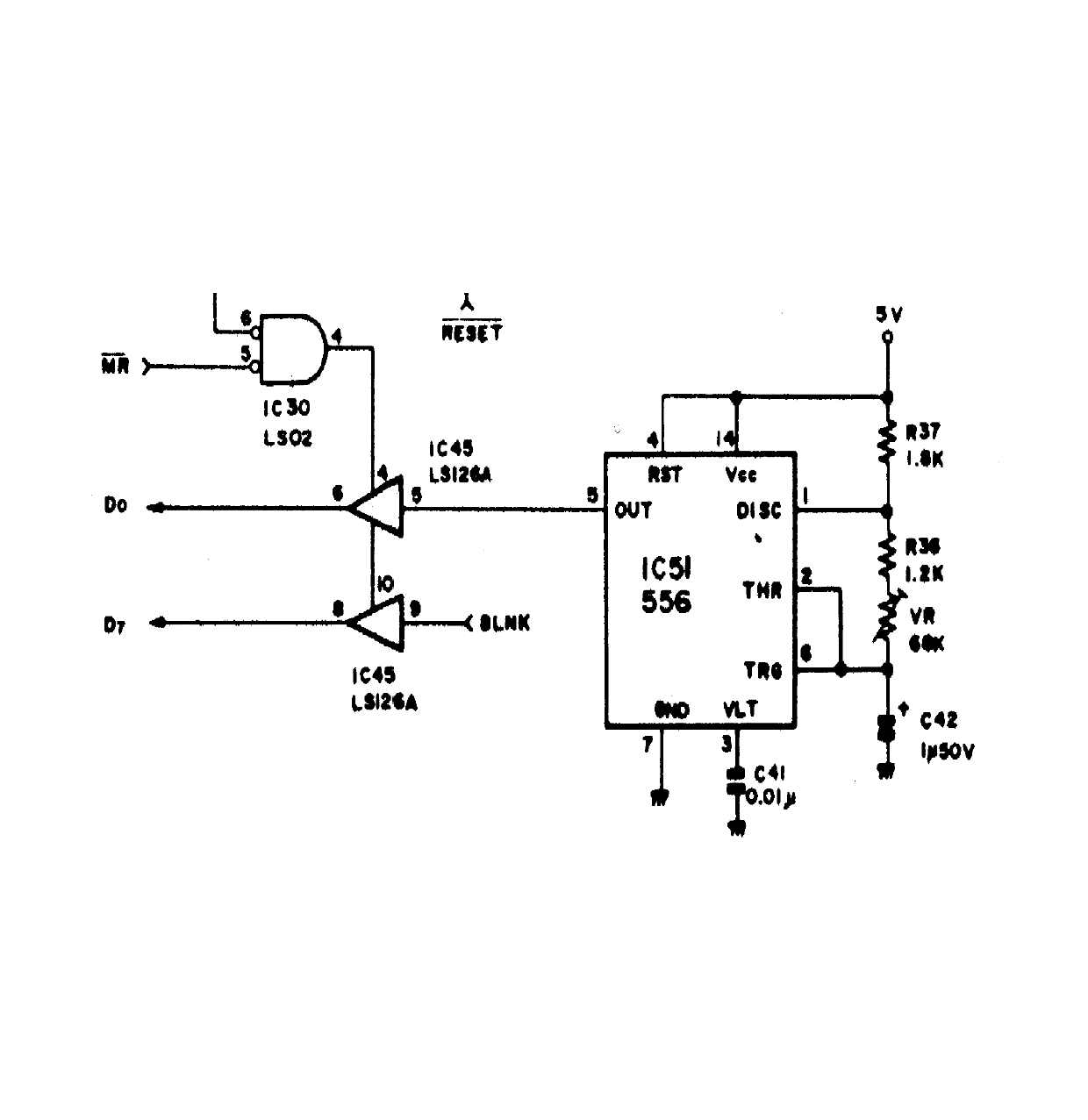

Also, I'm surprised : isn't $E008.D0 in input supposed to give use a 32Hz pulse for TEMPO? On MZ-700, D0 is 32Hz pulse and D7 is BLNK pulse.

MZ-80 K:
MZ-700:
Posts: 685

I am not saying you can not detect a pulse with your code but it is the tempo signal from a 556 timmer for the sound not the video Hblank
See page 163 of the Owners Manual .
The Hblank signal from the video goes through a re-triggerable mono-stable to generate a fixed length pulse using capacitors and resisters.
