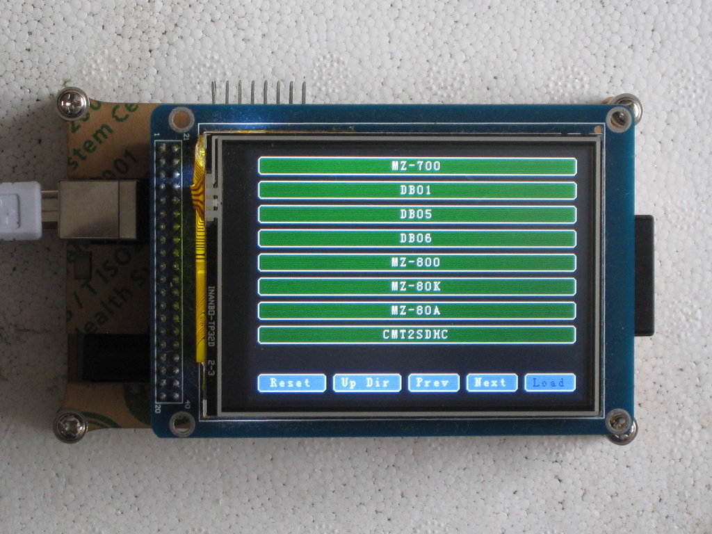

Machine/model Selection
DL select1.jpg (70.79 KiB) Viewed 22931 times
Program Selection

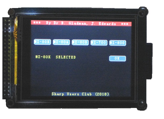

Directory Selection
Select Machine/model

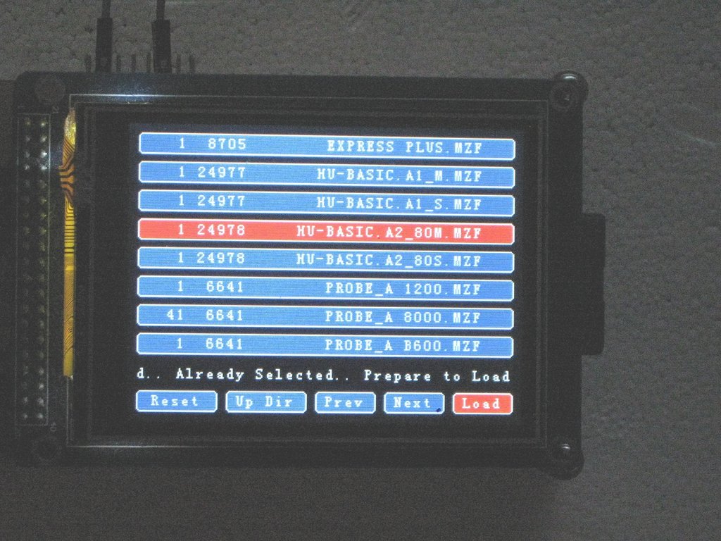

File Selection
Re: [MZF] MZ7: MZF file compressor using ZX7 algorithms
it appears i got a wrong image this is image 2 select program
DL SELECT2.jpg (76.26 KiB) Viewed 22931 times
