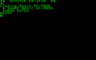

Has anyone got a way of converting from MZ-1200 BASIC to MZ-80A? The 1200 one is SP-5030 I think and MZ-80A's one is SA-5510.

Try SP-5030 on a 80a. As I remember, it should work. Tell me if I'm wrong, please.
You also can try the converter 80k to 80a:
https://sharpmz.org/mz-80a/dldutils.htm

I forgot to reply to this! Yes, it does seem to load on the 80A.
