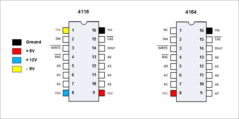

Here is the schematics about the differences between 4116 and 4164:

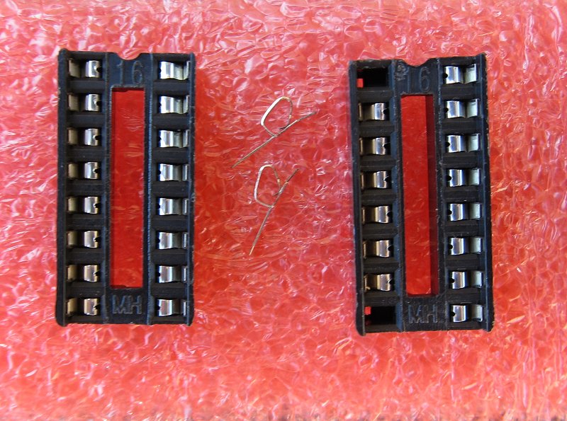

Note that 4164 are 64Kbit and not 16Kbit so the MZ will use only a quarter of memory. For this, pin 9 (A7 which doesn't exist in 4116) is set to Vcc. We also need to disconnect pin 1 (Vbb -> NC) and pin 8 (Vdd -> NC) from the motherboard so there is no -5V and +12V rampaging around the DRAM:

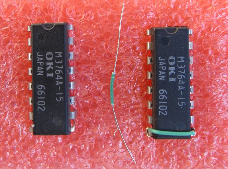

Then to connect the pins 8 and 9 to Vcc (+5V) so pin 8 can get +5V:
If you don't want to modify the sockets, you can simply bend the pins 1 and 8 of the DRAM chips so those pins won't be inserted in the socket, making them not connected.
