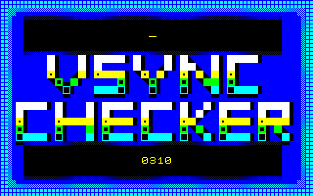

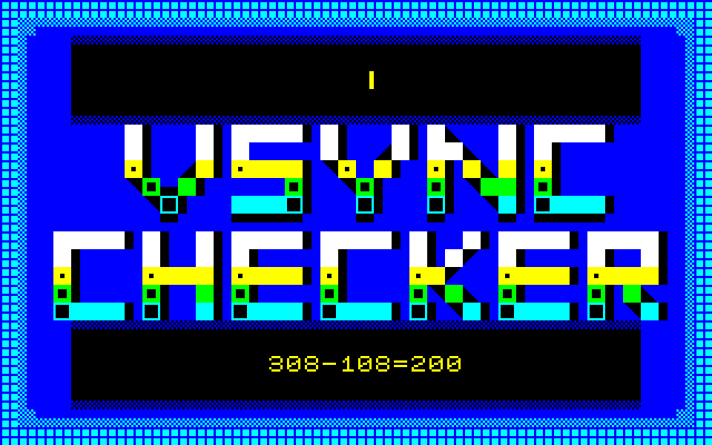

@Jo Even
I coded a VSYNC CHECKER (fully assembly code) to use the timer #2 to count BLNK and so to determine how many lines between frames.
Here is what I got with EmuZ-700 NTSC (262 lines):
And here is what I got with EmuZ-700 PAL (312 lines):
So I have a stable difference of 2 lines for both.
With mz800emu, I got something unrealistic like 33xx.

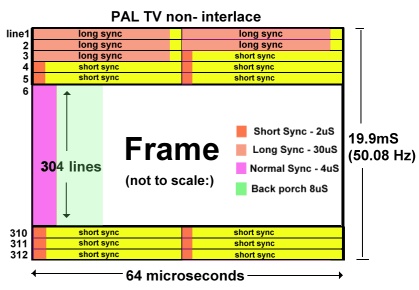

I'm starting thinking that 306 may be the part when /HSYNC is normal and we really got BLANK.
If you look at that picture:
You can see some lines where /SYNC has different values (three here). From the service manual, /HSY is around 4 µS when we get /HBLK and BLNK.

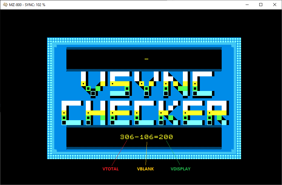

I now try to count VTOTAL and VBLANK to check if VDISPLAY (= VTOTAL-VBLANK) equals to 200.
Note that the usual values are:
Pixel	PAL	NTSC
VDISP	200	200
VBLANK	112	62
VTOTAL	312	262
It seems BLANK is only output when sync is normal (not long or short) so our VTOTAL and VBLANK are missing the lines when sync is not normal.
For mz800emu (stock mz-700 has the same result so far):
Sans titre.png (26.98 KiB) Viewed 66337 times
For EmuZ-700 PAL:
For EmuZ-700 NTSC:
Conclusion: For me, stock PAL MZ-700 tells me we get 306 BLNK signals per frame (or maybe 307 because I count two BLNKs as a unit), so I could write up to 306*14, that is, 4284 characters per frame.
Results for NTSC stay consistent with the table if we add 4 to VTOTAL and VBLANK.
