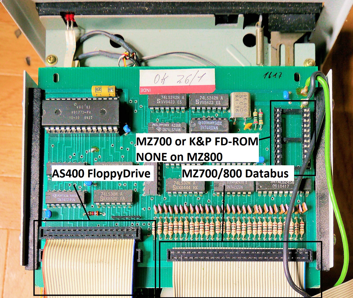

The K&P rom has the same functionality as the original from sharp. In addition, it has a few extensions, or still in minidos. It is possible to operate the KuP rom in a normal interface and vice versa, the original one in the K&P. The connections for the floppy are 1:1 for an AS400 Shugard drive.
In this case, someone put the original sharp and the K&P in an e-prom and made it switchable. I did similar things in my MZ800.
The picture shows the K&P controller, without ROM, since I run it on the MZ800.
Re: MZ-700 + MZ-1U06 Help needed
What is an "AS400 FloppyDrive" in this context? The only thing Google turns up when I search for it are the IBM MidRange machines. Somehow I doubt that theyr are relevant here ...
