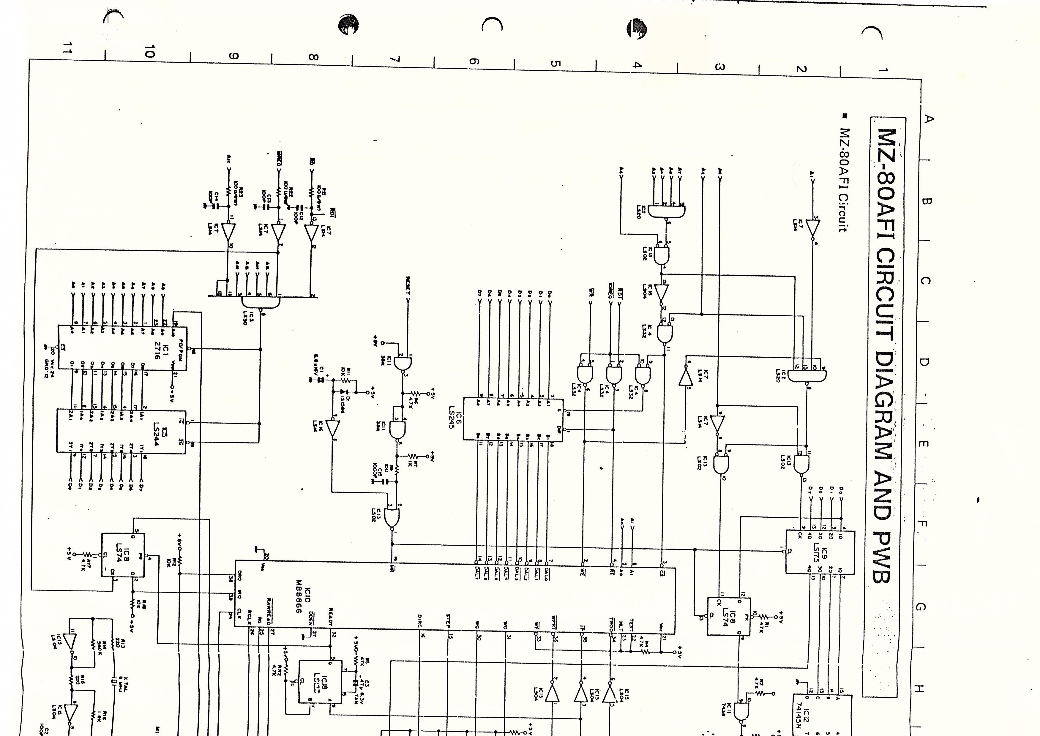

The Mz-80A FD card will work in the B, you have to remove the EPROM and I think but not certain that there is one wire that has to be cut.

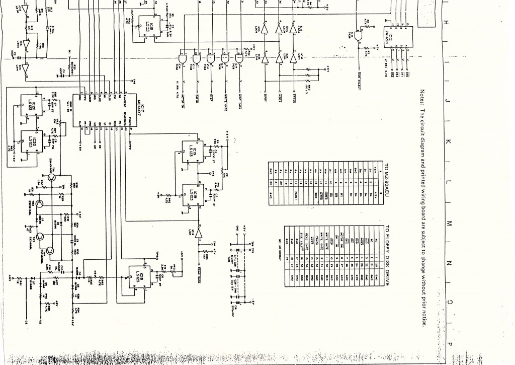

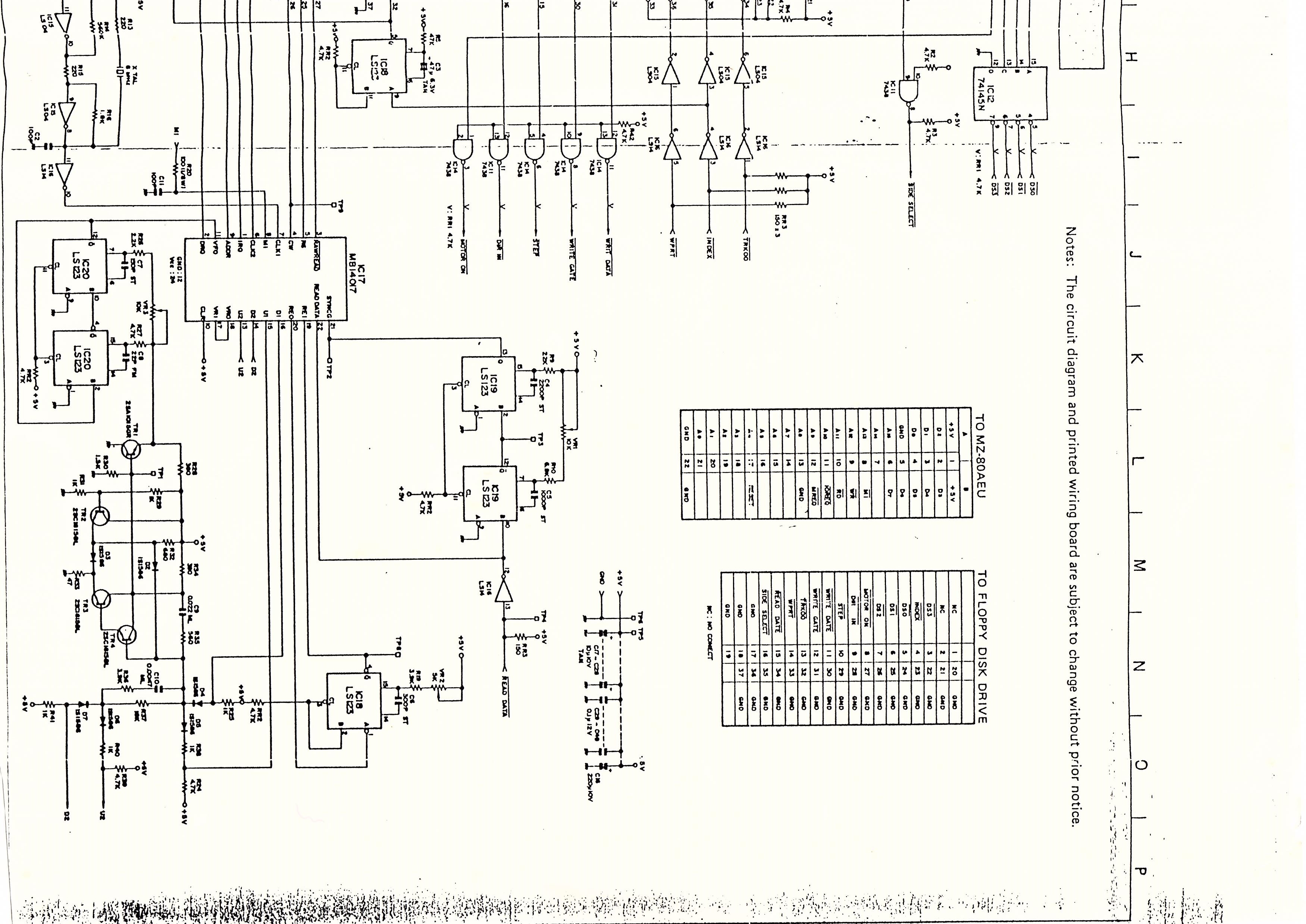

I was correct there is one track that has to be cut to convert the A card to a B card the EPROM's CS/CE signal IC 3 PIN 8 to IC 5 PIN 1
IC 5 PIN 1 will need a pull-up resistor adding. see images
