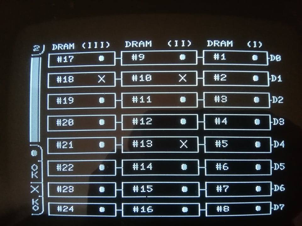

Hmmmm ... i do not understand how to use the code ?
i can download an *exe, but this doesn't make sense.
Do i need to replace my system rom against *what* ?
Could you please declare how you got upper screen ? I would like to check my spare chips :D

Re: [SHARP MZ-80 K/K2E/K2/C, 80 A, 1200] DRAM Tester ROM
1) Retrieve IPL.ROM in Assets of the last release : https://github.com/SHARPENTIERS/MZ-80K- ... r/releases. Just click on IPL.ROM to donwload it.
2) Burn the IPL.ROM image on a 4KB (E)EPROM.
3) Plug this (E)EPROM in the M-ROM socket after removing the M-ROM chip.
4) Launch the MZ-80 K and it will start the program. The first screen will be garbage to tell you the screen is okay and displays.
5) Then a "PacMan" intro displays and waits for you to press [SP] to start the four tests.
6) The first three tests are fast and the last one is slow. For each DRAM chips numbered from #1 to #24, there are 4 pills or crosses to tell the result for each tests. A pill means successful and a cross means a failure on the chip. On the motherboard, you have three rows (they are showed as columns I, II and III on the program). Each row has 8 chips.
7) Once you write down the chips having a cross at least, you switch off the MZ-80 K to replace the defective chips by new chips then you jump to step 4 back.
