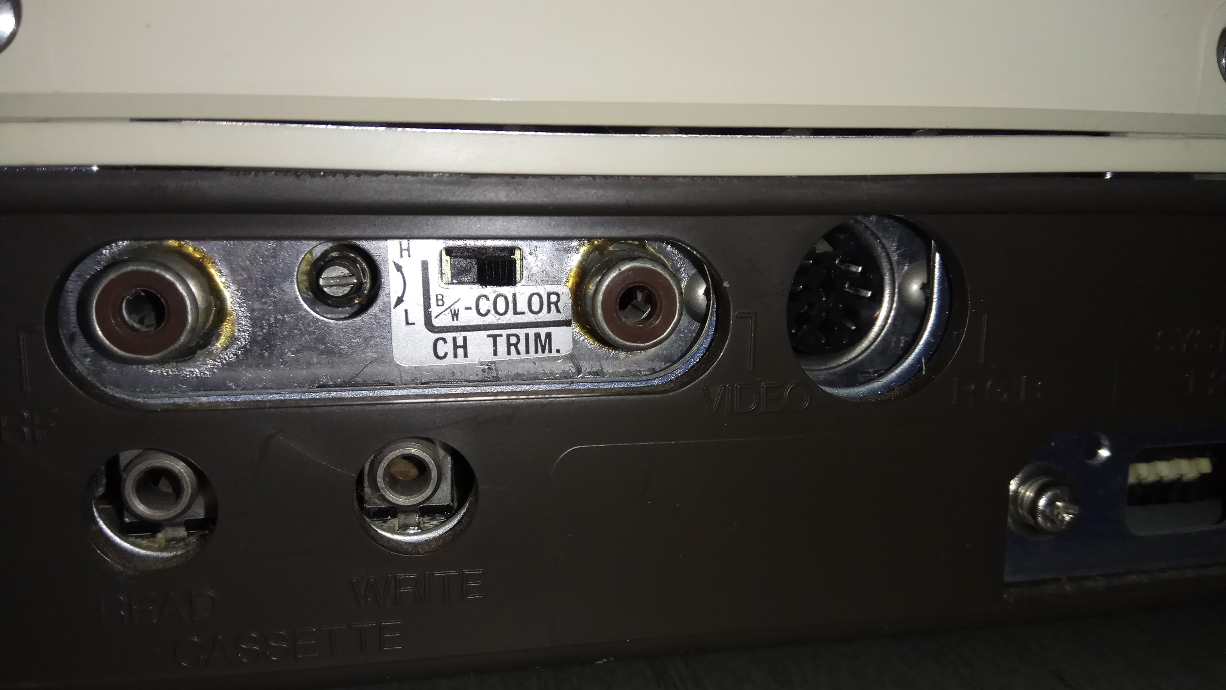

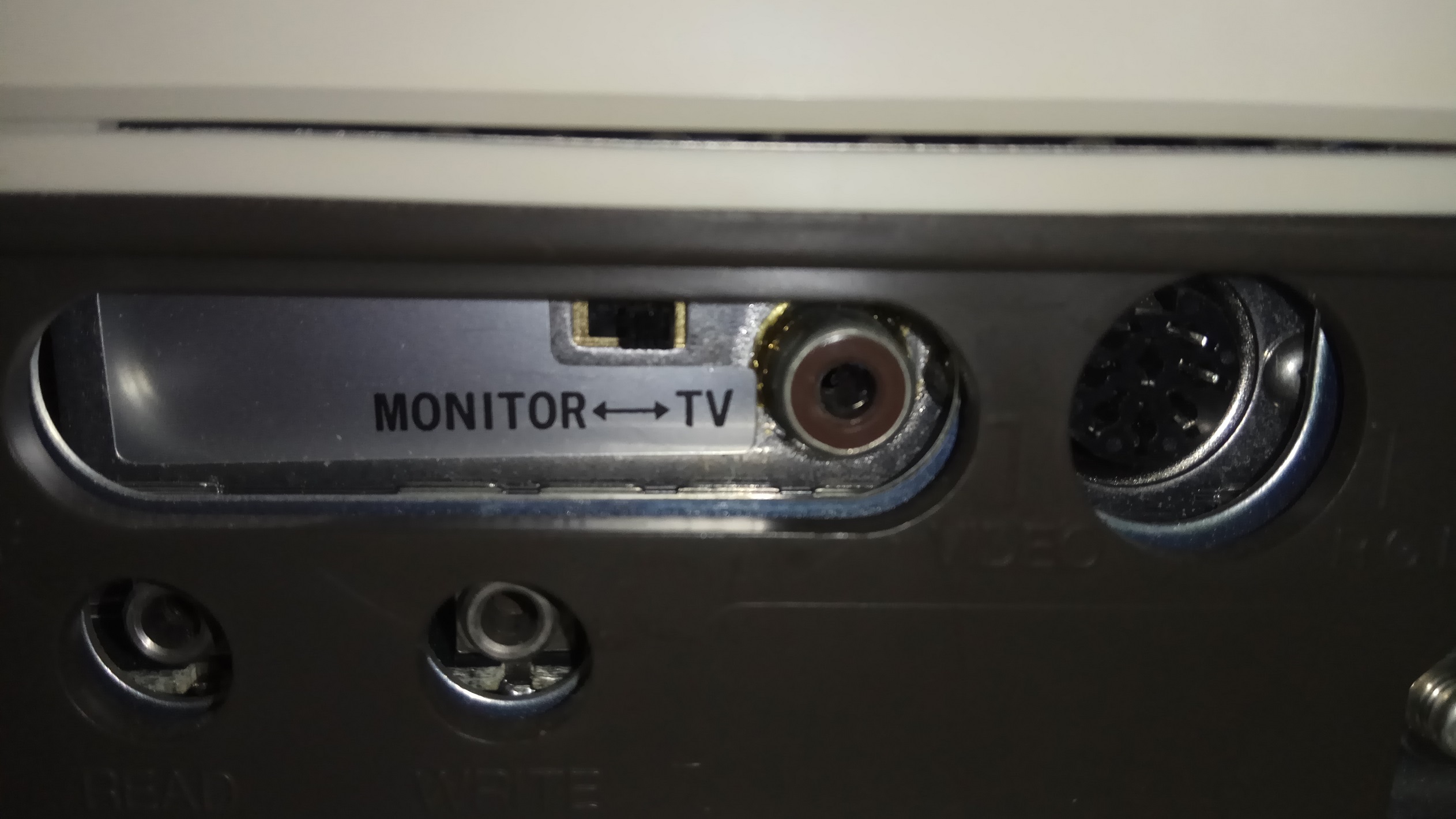

So I have two MZ-821 now. The first have the usual video outputs : DIN8 + RF + composite. The second has no RF output and no composite as well: the expected composite plug appears to be just a video output for some SHARP monochome monitors.
The one with composite signal:
The other without composite signal:

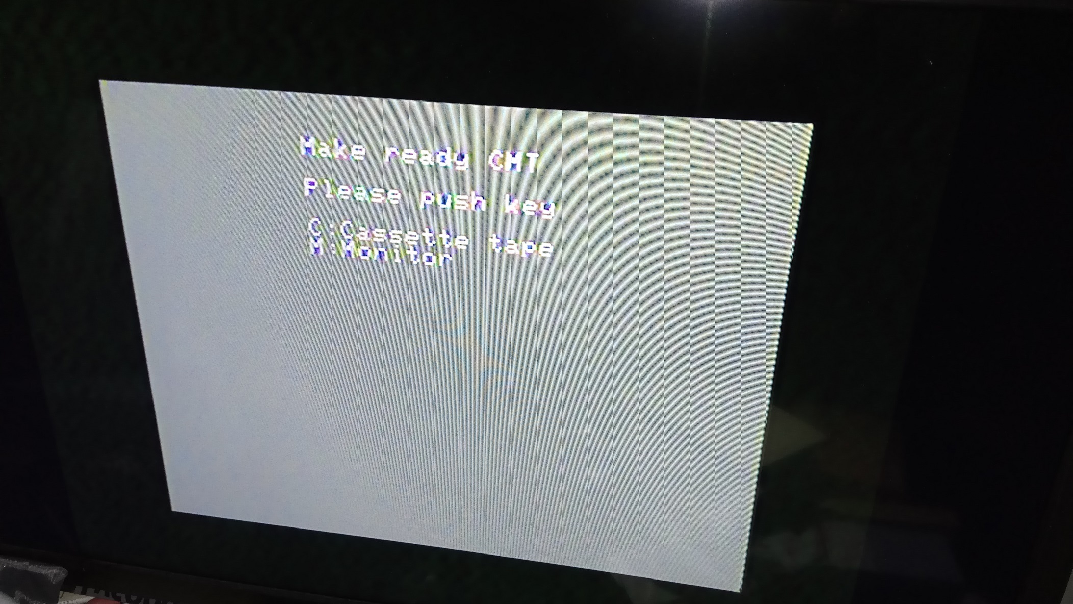

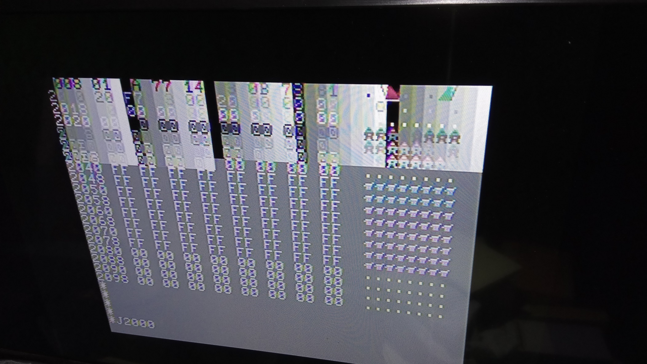

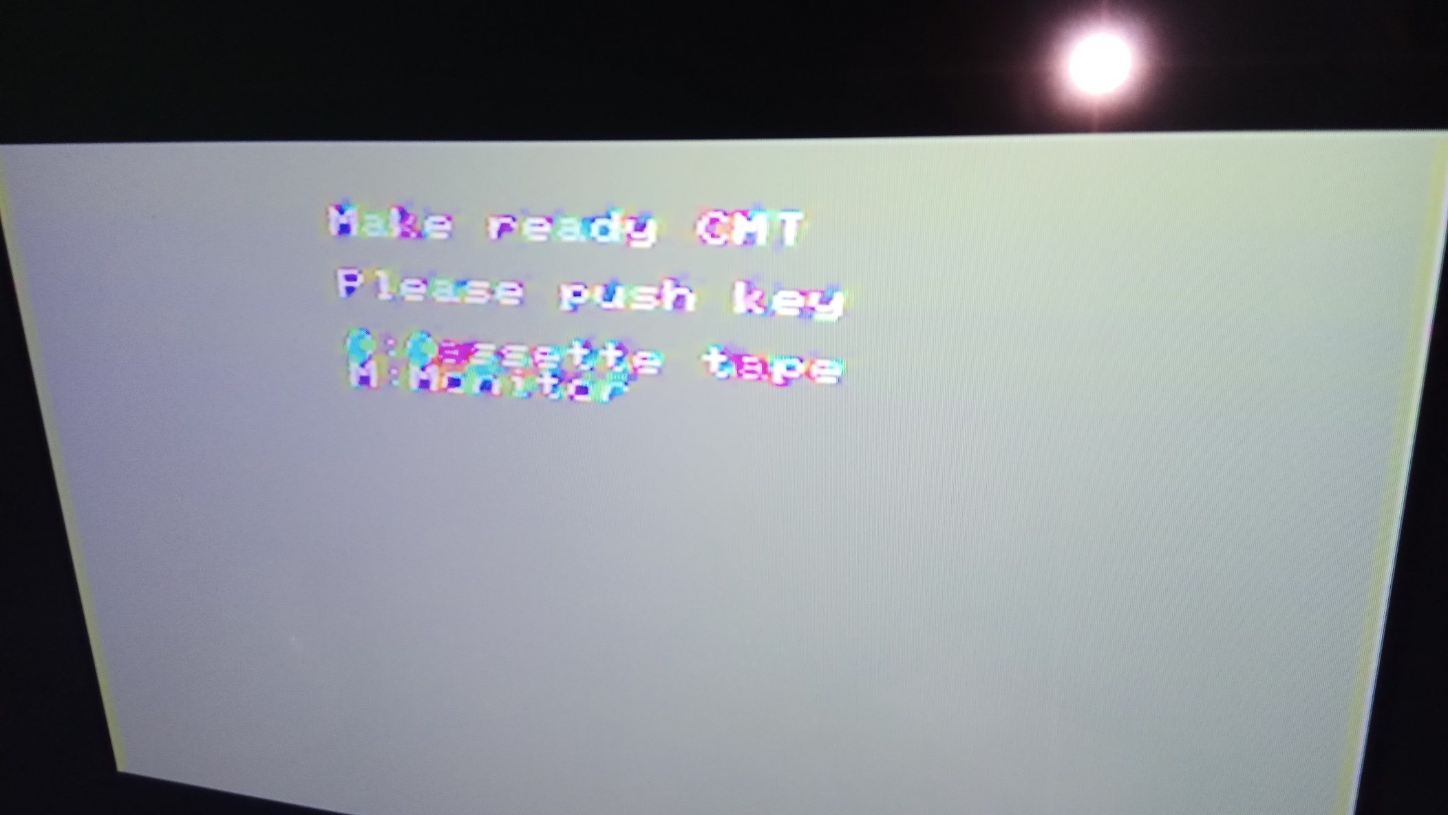

Here is what I get trying to get it as a composite:
Not so great, right?

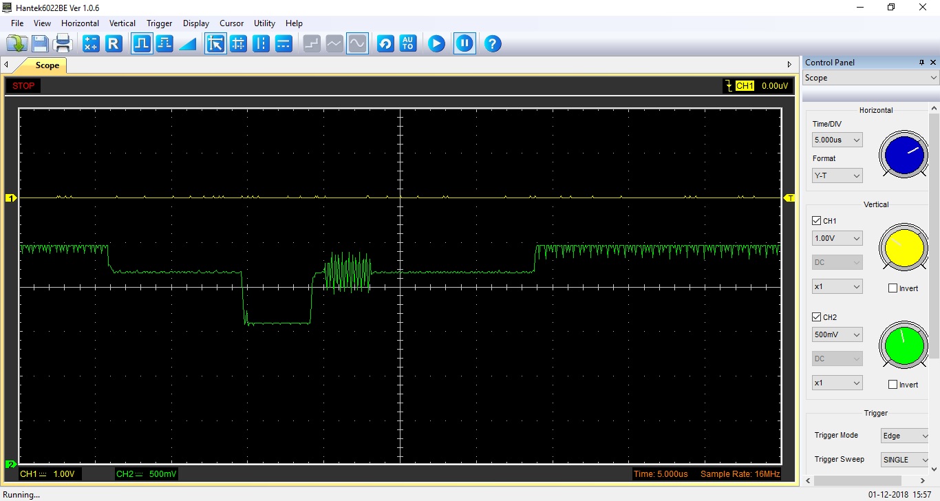

I tried to capture the video output signal to see how it is.
First a real composite signal through my first MZ-821 (with composite signal) :
The signal has a color-burst and looks like a composite one.

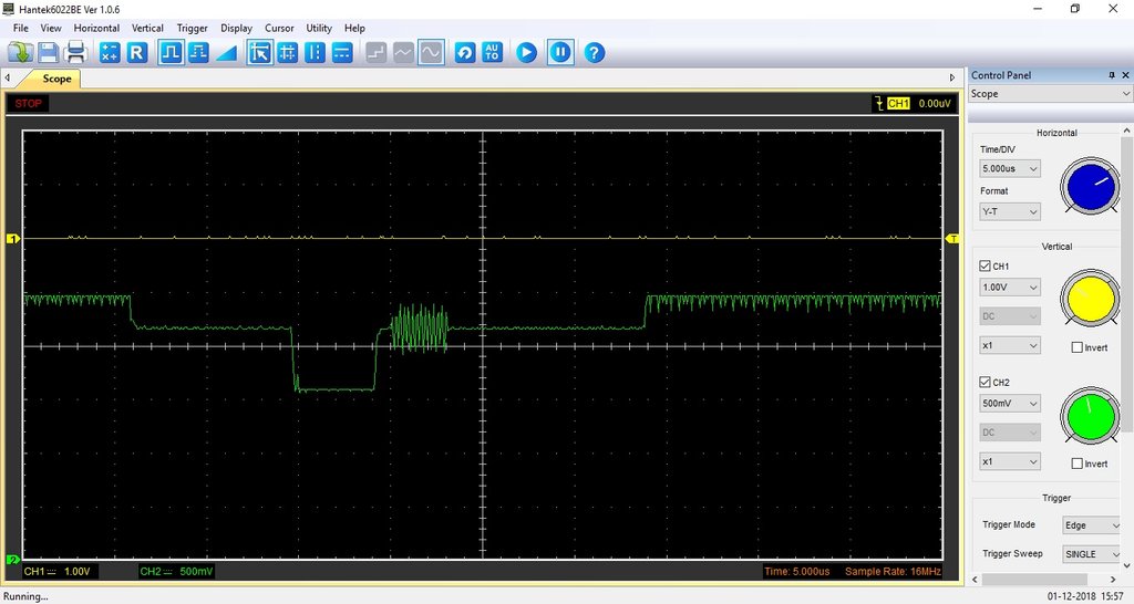

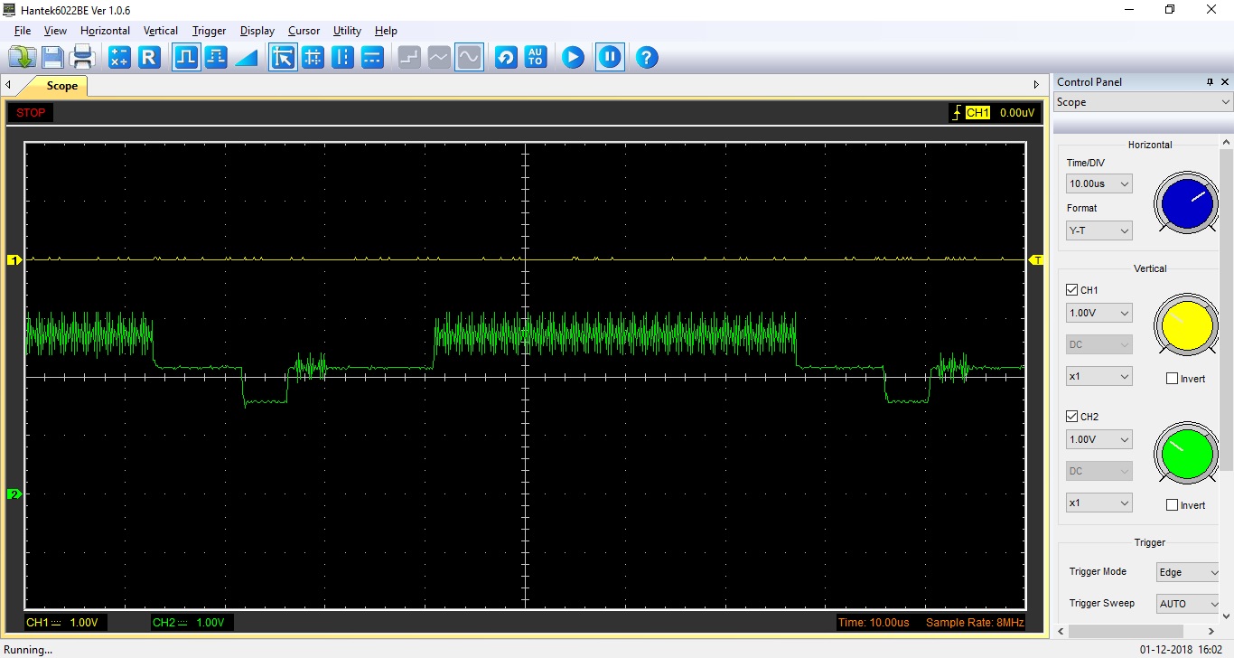

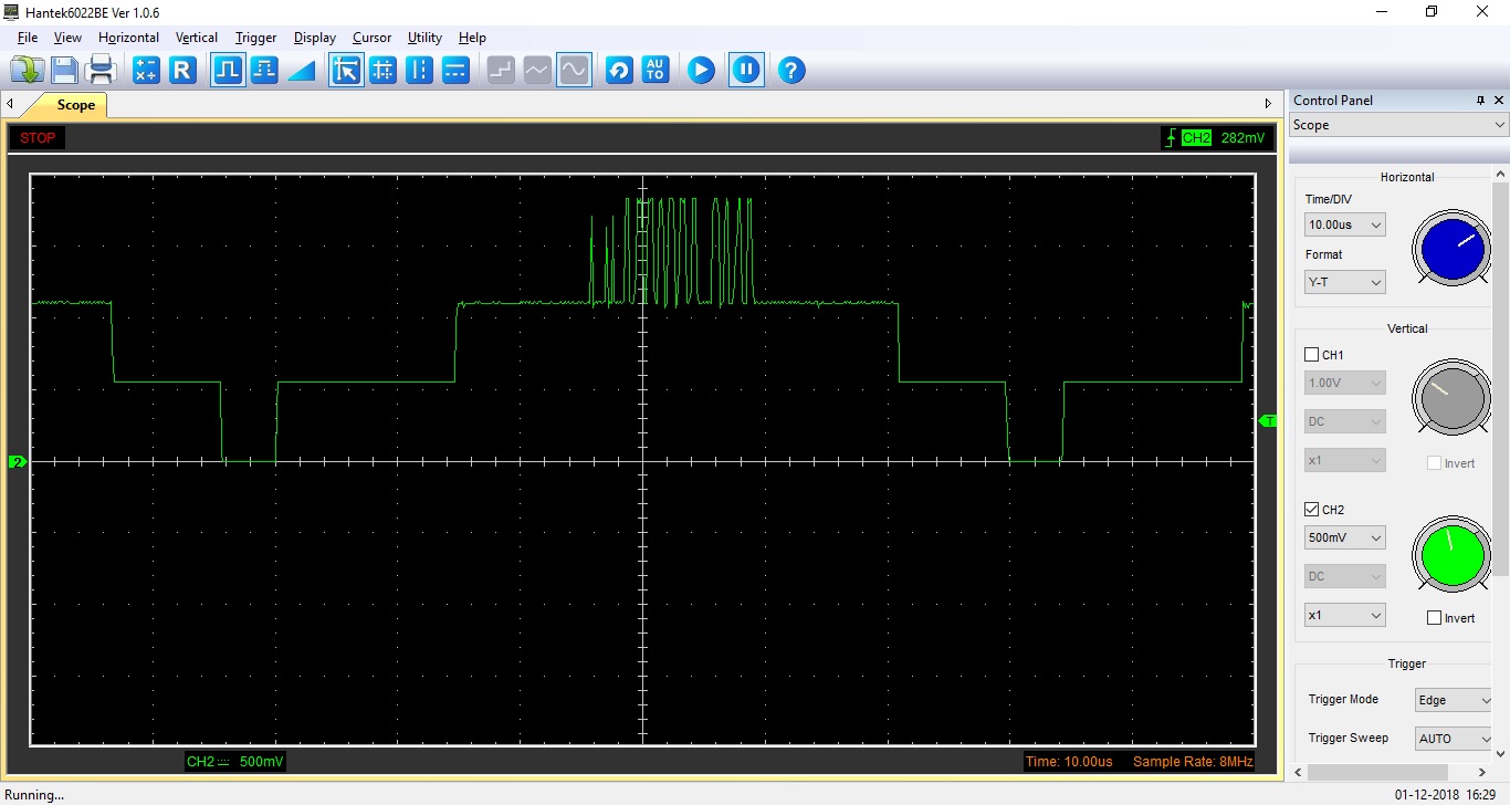

Now the unknown signal through my second MZ-821 (without composite signal):
Now wonder there is no color: no color-burst. There is also an interrupt "MONITOR <-> TV" but I got the same results.
So I guess the only way to get colors is doing so through the RGBI (DIN8).
