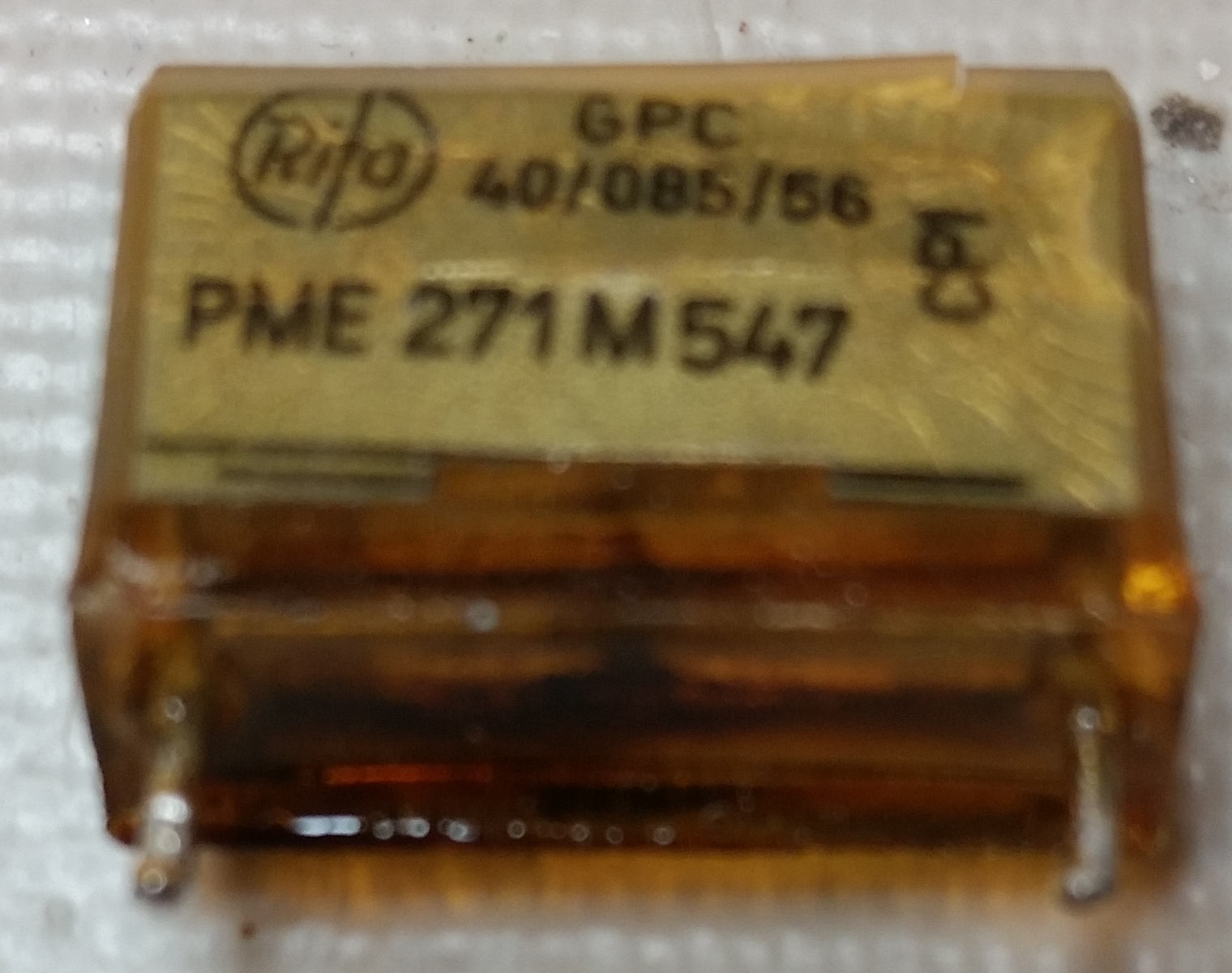

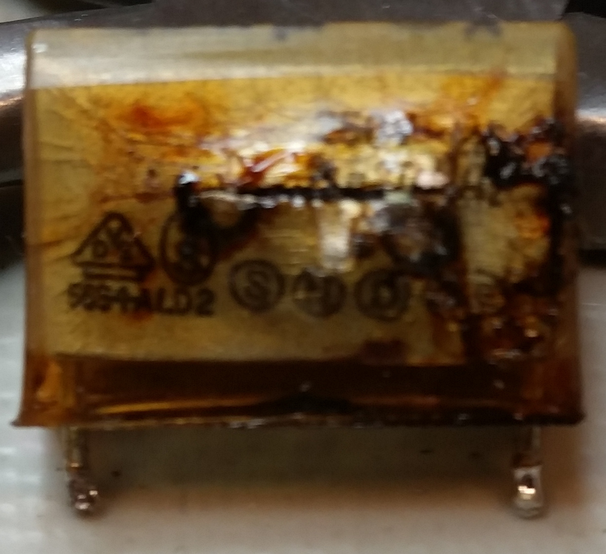

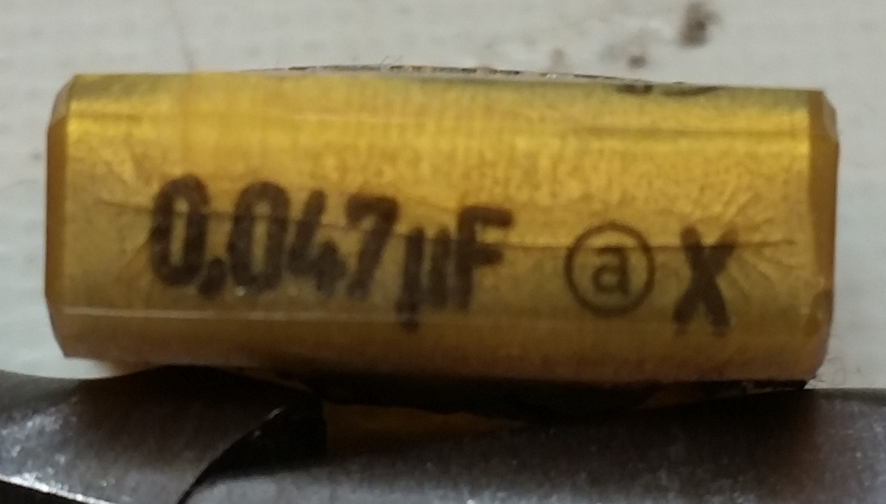

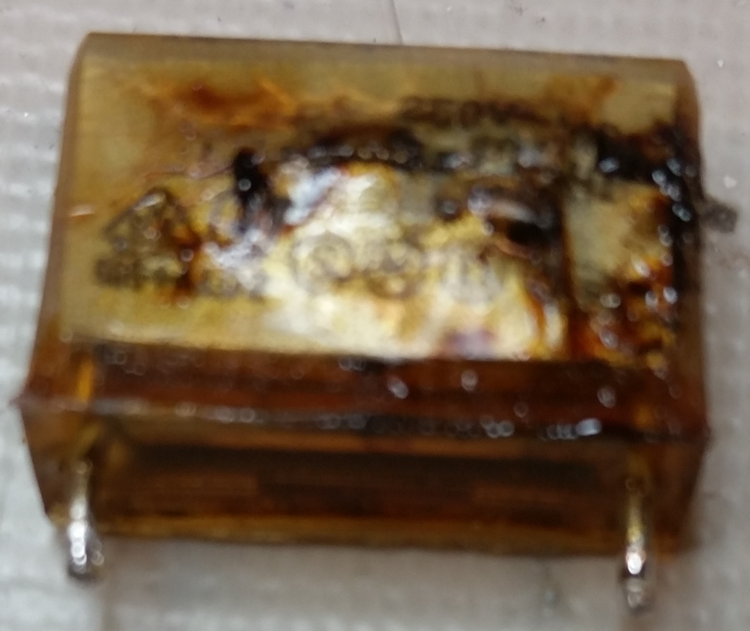

Not sure it is X2 (how do I know?) but it is X class, at least. The schematic only says 0.047 mikroFarad AC 250V. Here are some pictures:

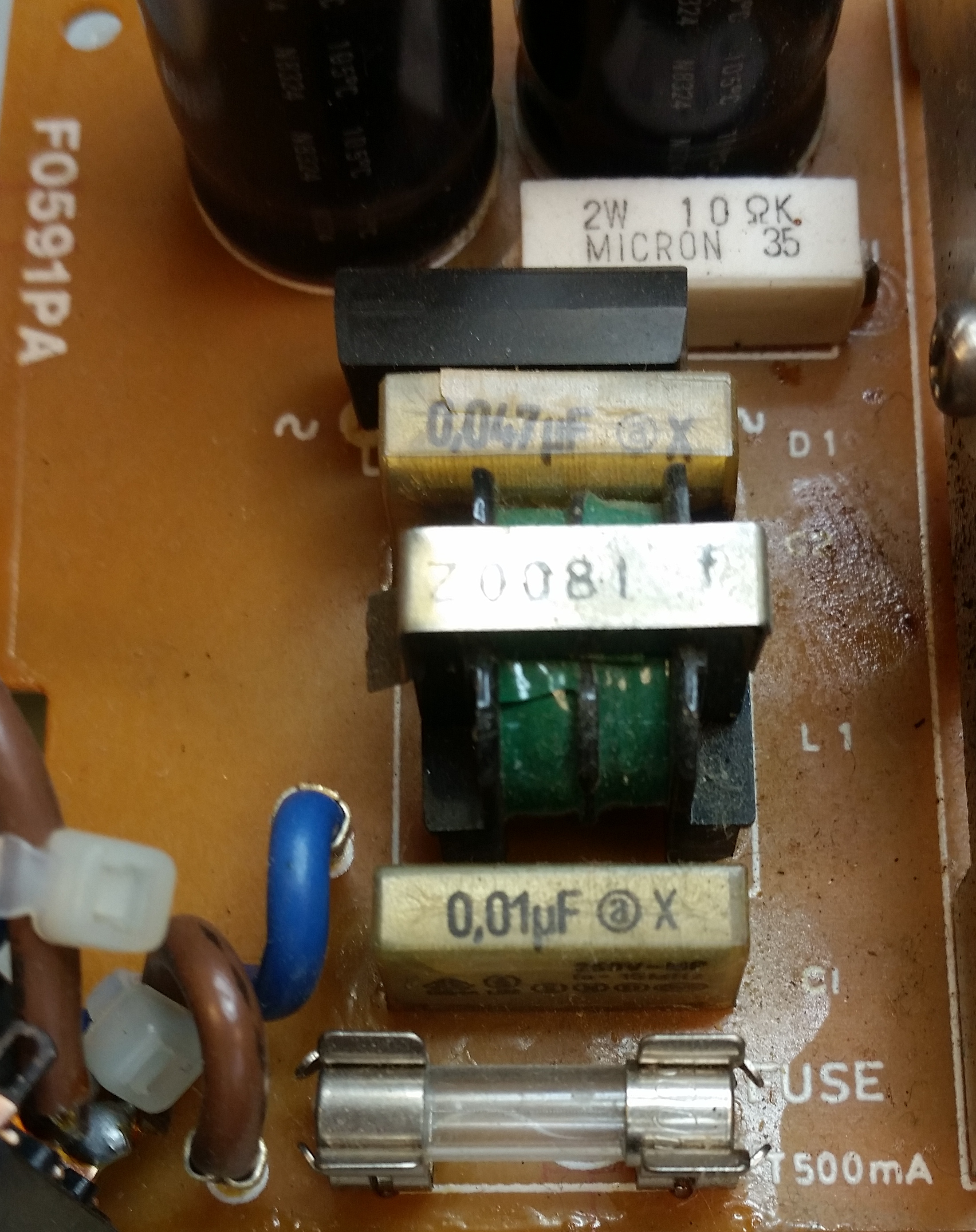

And C1 (the other filter capacitor) has traces of leakage around it, even if it looks ok. Maybe it has been replaced in the past:

It's the same as mine. You have a choice: just remove it or replace it with an equivalent one.
It is not necessary as it was just here as a filter which "cleans" the frequencies interferences especially with old CRTs around (so your neighbours may watch their TV set). Nowadays, it is almost useless. It won't prevent your machine from running well.
If you want to replace it, look for .047µF (47nF) - 275V - X2 on eBay: for instance, https://www.ebay.fr/itm/MKP-250V-275V-2 ... :rk:1:pf:0.

Yes, I have ordered new capacitors ( I ordered some for C1 as well) on eBay already. They will get here in some weeks time, hopefully. In the mean time my MZ-700 runs unfiltered

3 of the 4 MZ700s I have I've had to replace C2... fairly easy job.

Oops, I forgot - I've replaced C2 already. PSU is good as new now
