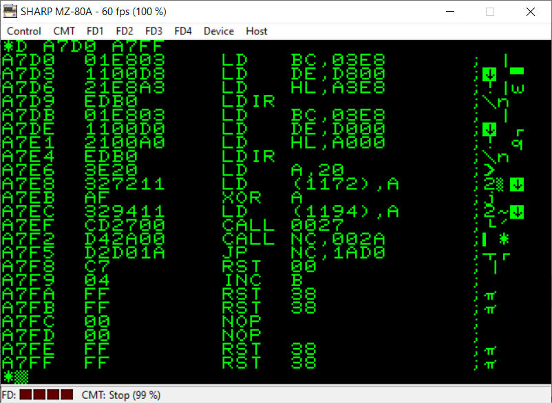

For anyone interested, I disassembled the loader for Star Avenger:
Star Avenger Disassemble.png (50.7 KiB) Viewed 49984 times
The reason for this is that I think there is some sort of primitive copy protection happening with it. I have the original tape (finally a working one) now and was trying to read it into MZF Studio but only the loader would load in. Not the main program. So I tried on my MZ-80A with Supertape 3 and found that after the loader program the 2nd data file just seems to be called "." with all of the tape header values set to $0000 so even Supertape 3 won't load that program in. Anyone know what the memory location $1194 is?

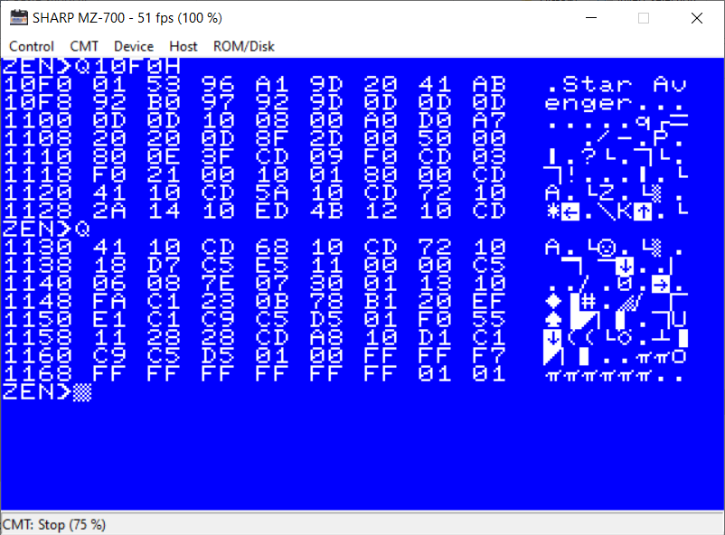

The plot thickens. I just noticed this in the loader file's header (first file on the tape with the title screen in) residing in the comments field from $1108:
Star Avenger Tape Header Comments.png (50.81 KiB) Viewed 49972 times
Unsure what's going on now. It's an interesting puzzle. I probably shouldn't be trying to copy the tape or read the tape on my MZ-80A anyway but I found that the game will load on my MZ-80A (but won't run obviously as it's a 700 game) if I load the tape from the beginning. However, if I try to load only the 2nd file on the tape without loading the 1st file then the machine refuses (tape stops). Will be experimenting more on the MZ-700 now, I think, rather than the 80A (it's just convenient for me on the 80A at the moment).

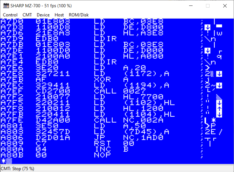

Ok this is pretty interesting, different results from disassembling the loader when I do so on the MZ-700:
Star Avenger Loader 700.png (56.22 KiB) Viewed 49964 times
Pretty odd to suddenly have a different result than when I did this on the 80A. But this gets me a lot further, this is more like what I expected. This is priming the tape header memory locations with proper data to load the main part of the program. This will be easy to crack now :)

I successfully rescued the complete game last night. However, the loading screen part failed to execute the main game. Very strange, so still more to work out on this one. I can load the main game on its own though (which you can't from the tape due to the primitive copy protection) because I altered the MZF header in a hex editor to remove the $0000 addresses (which the loader should be inserting) and put the correct values in manually. I may alter the "JP NC,$1AD0" in the loader to just a straight "JP $1AD0" and see if that helps (could be an emulator problem perhaps).

$1172 is part of the screen XY co-ordinates
$1194 is the tab counter
I think
Ist listing is from the preloader
2nd listing is from the program that the preloader loads
which load another header
modifies it
and then loads the program data.

I could not get it to work in the emulator with the -real- CMT header values in the main program file (i.e. all zeroes). I had to put the real values into the header even though the loader program modifies the CMT header and inserts the correct values. So strange (but at least that circumvents the 'copy protection') and at least I got the game off the tape and into a playable form.
