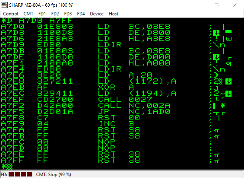

For anyone interested, I disassembled the loader for Star Avenger:
Star Avenger Disassemble.png (50.7 KiB) Viewed 50035 times
The reason for this is that I think there is some sort of primitive copy protection happening with it. I have the original tape (finally a working one) now and was trying to read it into MZF Studio but only the loader would load in. Not the main program. So I tried on my MZ-80A with Supertape 3 and found that after the loader program the 2nd data file just seems to be called "." with all of the tape header values set to $0000 so even Supertape 3 won't load that program in. Anyone know what the memory location $1194 is?

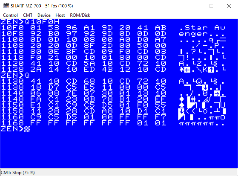

The plot thickens. I just noticed this in the loader file's header (first file on the tape with the title screen in) residing in the comments field from $1108:
Star Avenger Tape Header Comments.png (50.81 KiB) Viewed 50023 times
Unsure what's going on now. It's an interesting puzzle. I probably shouldn't be trying to copy the tape or read the tape on my MZ-80A anyway but I found that the game will load on my MZ-80A (but won't run obviously as it's a 700 game) if I load the tape from the beginning. However, if I try to load only the 2nd file on the tape without loading the 1st file then the machine refuses (tape stops). Will be experimenting more on the MZ-700 now, I think, rather than the 80A (it's just convenient for me on the 80A at the moment).

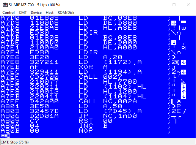

Ok this is pretty interesting, different results from disassembling the loader when I do so on the MZ-700:
Star Avenger Loader 700.png (56.22 KiB) Viewed 50015 times
Pretty odd to suddenly have a different result than when I did this on the 80A. But this gets me a lot further, this is more like what I expected. This is priming the tape header memory locations with proper data to load the main part of the program. This will be easy to crack now :)
