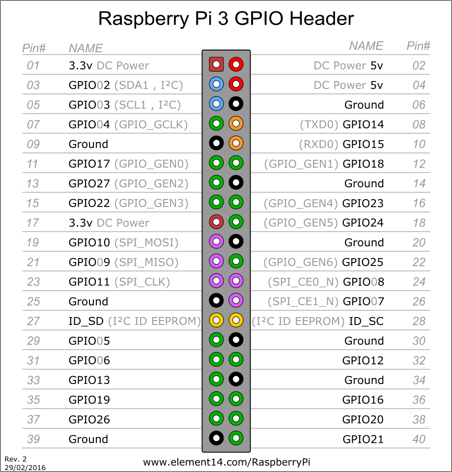

Question to all the people with more HW knowledge:
would it be possible to so some kind of Unicard-like Sharp Extension based on Raspberry Pi [Zero[W]] ?
The RPi should have more than enough power for most to all Unicard features, and it should be much simpler to construct some adapter card for MZ-slots. Surely some latches and 5V<->3.3V level convertes would be needed.
There are also some frameworks for RPi Bare Metal programming in C/C++ and FreePascal, so no Linux needed.
My main question: does the RPi have enough capable GPIO to hook up to the MZ extension bus?

RPI is based on Linux. I'm not sure it is quite responsive: if I'm not wrong, the µC is answering to I/O requests raised by the CPU through the BUS. I don't see Linux as a good candidate.

KnaxMax wrote: Wed Apr 25, 2018 1:41 pm There are also some frameworks for RPi Bare Metal programming in C/C++ and FreePascal, so no Linux needed.
Is that so? you would need to program more stuff missing. I won't consider that road as simpler.

You'll need to get access on the bus which means 8 DATA pins + 16 ADDR pins + a half dozen pins.
I count 26 GPIO, supposedly you don't need I2C, SPI, UART on them.
