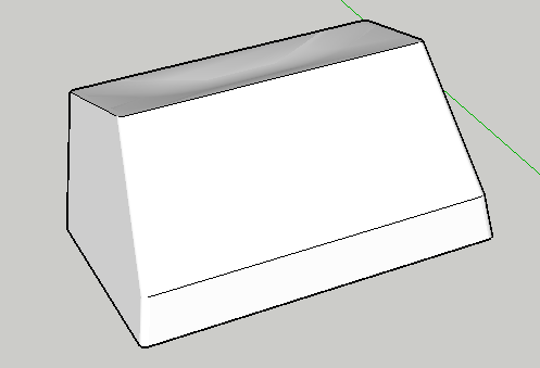

Jo Even wrote: Sat Feb 23, 2019 9:43 pmI will make an attempt, my first key will be the missing F5 on my keyboard.
First attempt, printing this right now:
MZ700 F-key 3D-printed.png (34.35 KiB) Viewed 55879 times
And yes, you can use the "extra" plungers on the shift-keys in a pinch. However, they might become a little wobbly. I could try to 3D-print some "dummy" plungers to replace them.

CRG wrote: Sat Feb 23, 2019 11:17 pmIf you fancy the job of making me a K and right arrow key I'd gladly pay for it.
First test was as expected, it did not quite fit. The outer dimensions were almost perfect, but the plunger hole was a little bit tight. Will make a second attempt tomorrow. If it works I'll have a go at the other keys. However, don't expect factory looking parts. My 3D-printer is rather basic.
CRG wrote: Sat Feb 23, 2019 11:17 pmIn terms of the broken plunger I was thinking again and the easiest option may be to recreate the top part of the plunger only then saw it off the base of the broken one and glue on the new. If you know what I mean.
Ok, so the plungers are just broken? Same as mine then, the top (Lego-shaped) part is broken off. Yes, I know what you mean. In fact, I have already modeled a replacement for the top part. However, I'm not sure if the 3D-printed part would be strong enough. We'll see tomorrow.

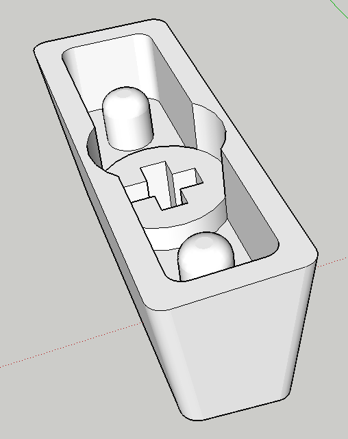

So the 3D-printed F-key was a success :) I have started on modeling the arrow-key, but there was not enough time to finish it this weekend. I hope to have it finished and tested on Tuesday.

First version.
MZ700 arrowkey 3D-printed.png (11.7 KiB) Viewed 55855 times

Looks really good. I'll have a go with the lego tonight and see if I can get something sorted with the plungers.
