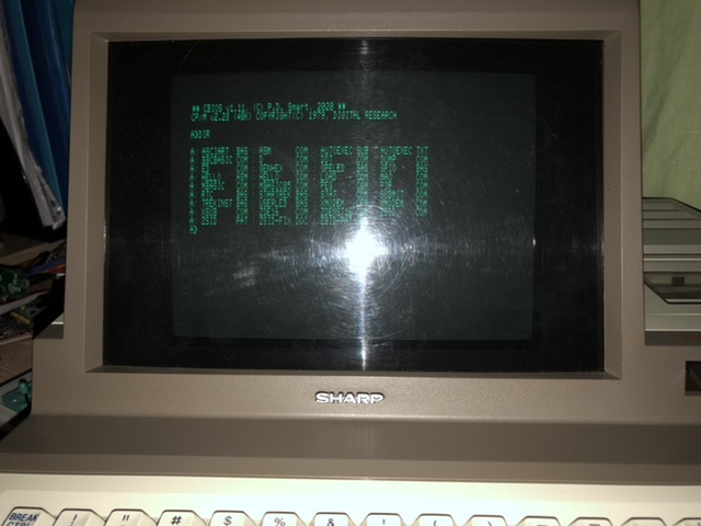

Some quick photos of CPM running.
- Attachments
- Booting from Monitor using RFS extensions.
- 5DC6A729-1D76-4198-8242-2F9791638780.jpeg (75.84 KiB) Viewed 62041 times

CPM booted using my CBIOS and a 1.44Mb floppy.
- Attachments
- CPM booted using my CBIOS and a 1.44Mb floppy.
- FEAD1556-9401-4E1D-B3B4-B50EADEC35C7.jpeg (71.03 KiB) Viewed 62041 times

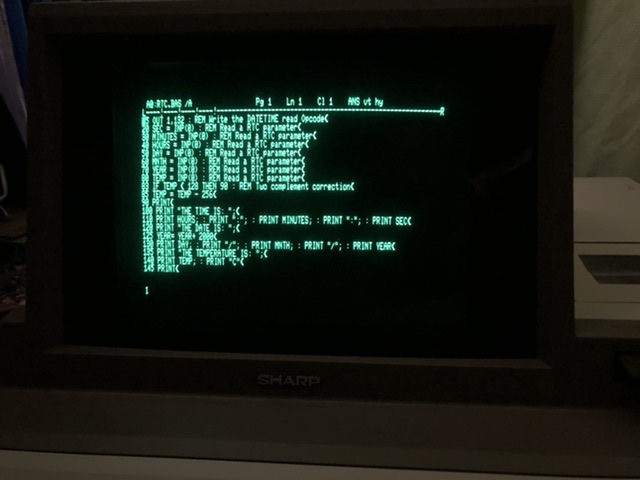

ZDE16 running under inbuilt Ansi Terminal emulator.
- Attachments
- ZDE16 running under inbuilt Ansi Terminal emulator.
- C484FFE5-2800-42C3-A4FF-3A9C8F6BA56A.jpeg (54.7 KiB) Viewed 62041 times

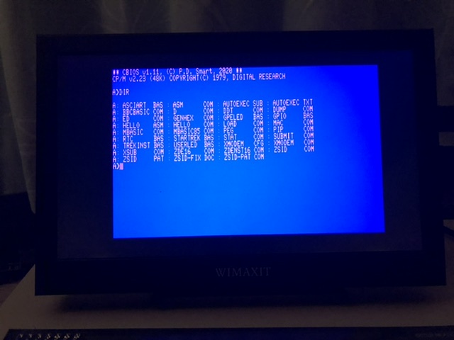

Colour output from MZ80A, Ansi Emulator needs updating to add colour support.
- Attachments
- Colour output from MZ80A, Ansi Emulator needs updating to add colour support.
- 96364482-8CDD-4EC1-8147-729BFA217BC8.jpeg (57.65 KiB) Viewed 62041 times
