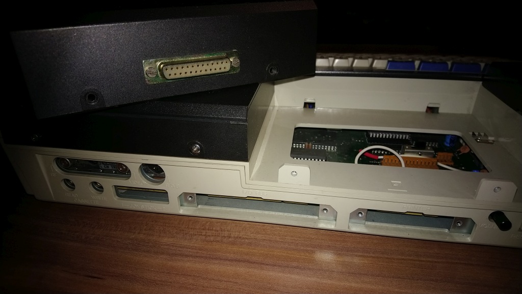

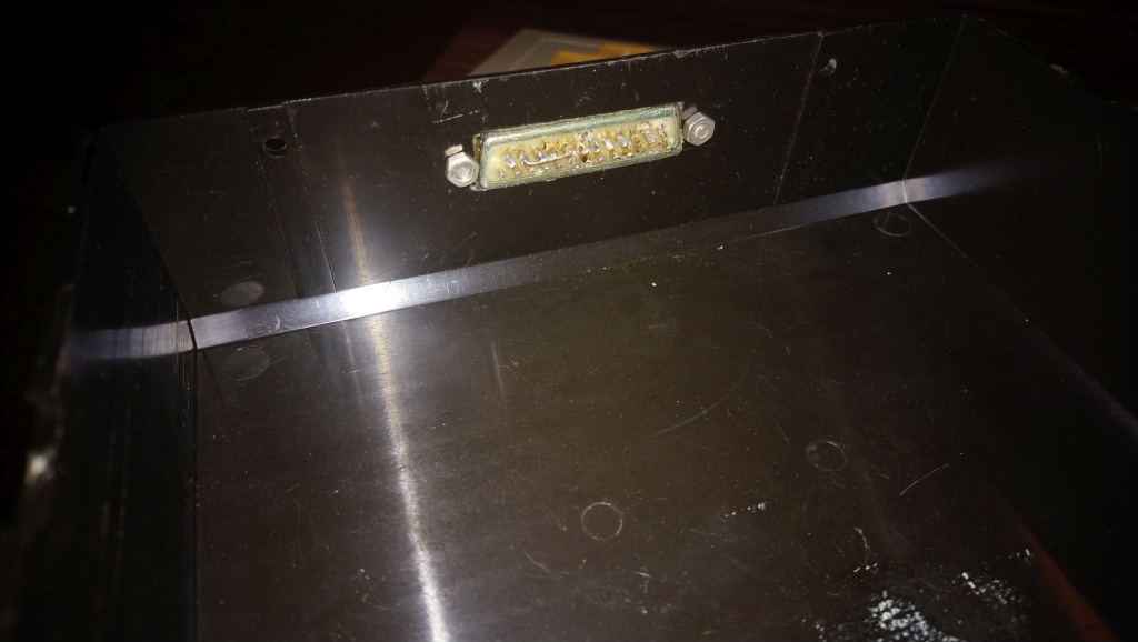

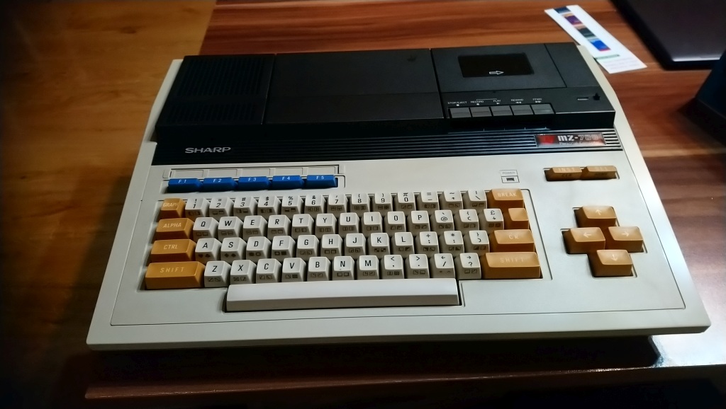

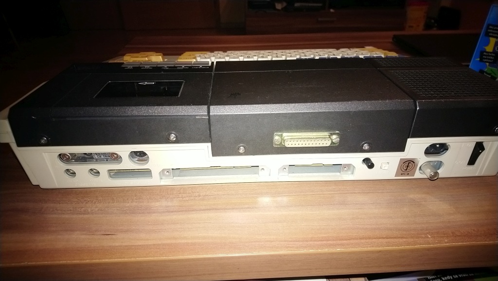

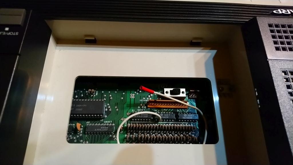

So I bought this MZ 700. Unfortunately the connector is not connected. There is some wire connected to motherboard.
Any idea what it was used for?. Looks like there was some card behind the connector.

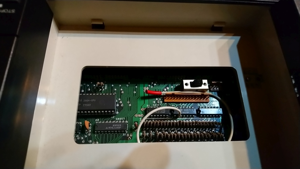

another picture from inside of the connector

2H (7417) pin 2 = RD3 (printer bus). It should have been connected to the right pin of the rear connector. I also notice GND pins are all connected on the rear connector. No doubt it was for a printer. So I suspect one of the previous owners removes the rest of wires.
