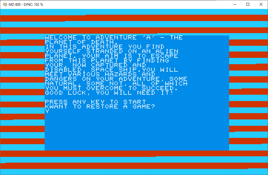

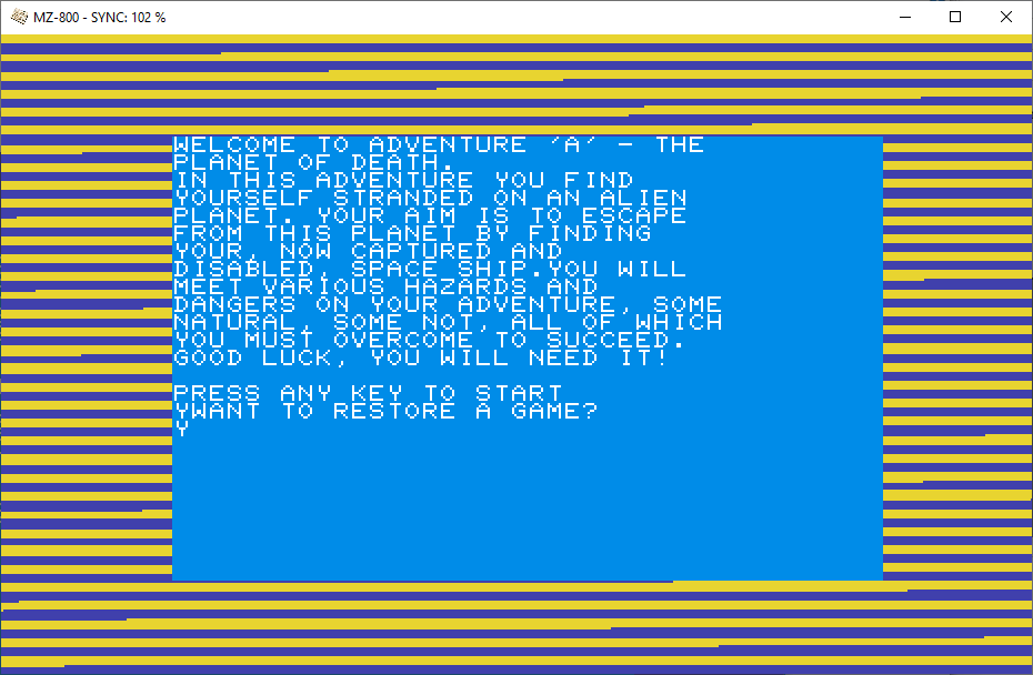

This morning I'm pulling in a routine in z88dk able to load data stream in ZX Spectrum format.
The loader calibrates its speed by probing the monitor to understand whether it is running on a Sharp MZ-700 flavor or an earlier system.
In the latter case it assumes it is a 2Mhz CPU.
When run on the MZ800 the border effect is visible.
The possible "level up", after this concept, is to borrow the "extra turbo" loader I prepared for the ZXSpectrum on z88dk-appmake.
