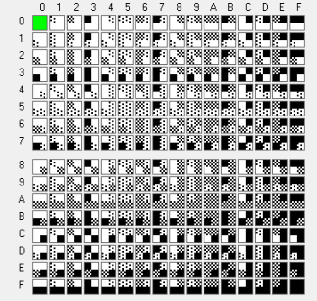

Just as an example for my 1024-character set board in my MZ-700 (using D3 to expand a 512-character set into double). I added that 256-character set as semigraphics 4-level 2x2 blocs:
mz-700 CGROM-G.png (110.21 KiB) Viewed 23354 times
I always found the original 16 "2x2 square dot" blocks ugly.
The character format is:
D0-D1: "Color" of upper left "pixel"
D2-D3: "Color" of upper right "pixel"
D4-D5: "Color" of lower left "pixel"
D6-D7: "Color" of lower right "pixel"
Color: 00 is full background, 01 is almost background, 10 is half foreground, half background and 11 is full foreground.
