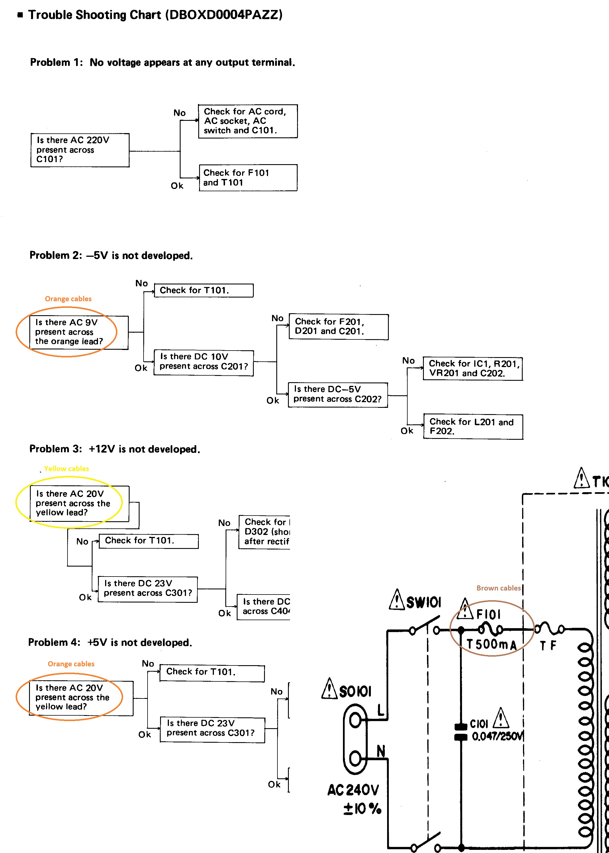

ozzybetts wrote: Thu Jun 11, 2020 5:56 am I did notice in this picture on the link posted by hlide that the fuse in question plus the 2 orange wires are not soldered in, while the voltages are being read...a bit odd?
https://www.nightfallcrew.com/13/01/201 ... ly-repair/
You mean the first picture (#1)? he was just doing some tests: as you can see fuse F101 (with brown cables) is still connected and the 240V passed when he tested. He was testing the 12V output voltage by just using the yellow cables. If you look at picture #5, every cable is in place.
Re: MZ 80K repair project
The yellow cables are for 20V -> +12V/+5V.
The orange cables are for 9V -> -5V.
The brown cables are for 240V through the fuse. Note that in the picture #1, the current runs in the fuse when testing!
Edit: I made a mistake in the pciture: +5V uses yellow cables, not orange ones.

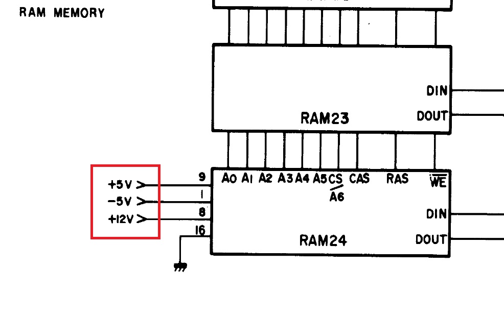

Gortho wrote: Wed Jun 10, 2020 9:28 pm *edit*
And +12V rail is used only in display unit. So you might have to look for shorts there.
Nope, DRAM chips DO also use +12V as -5V as well.
I know it because I had to replace them on my MZ80 K.
Gortho
Posts: 42
Joined: Thu Mar 22, 2018 3:53 pm
Location: Poland
Post by Gortho »
hlide wrote: Thu Jun 11, 2020 10:44 am
Eh indeed, did not notice them on schematics. And forgot about those old drams ;)
