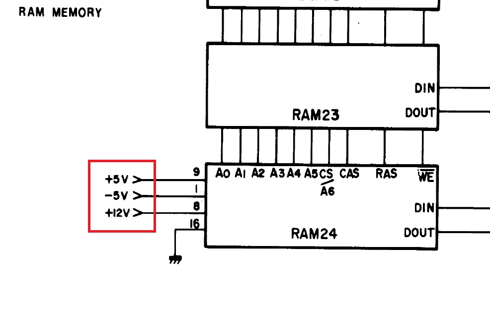

Gortho wrote: Wed Jun 10, 2020 9:28 pm *edit*
And +12V rail is used only in display unit. So you might have to look for shorts there.
Nope, DRAM chips DO also use +12V as -5V as well.
I know it because I had to replace them on my MZ80 K.
Re: MZ 80K repair project
Posted: Thu Jun 11, 2020 5:41 pm
by Gortho
hlide wrote: Thu Jun 11, 2020 10:44 am
Eh indeed, did not notice them on schematics. And forgot about those old drams ;)
