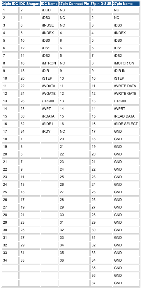

A bit confusing as you look up 34pin IDC on the web and it gives various pin layouts, the one I found and mapped to was linear, ie. 1-17 on top row, 18-34 below.
Looking up Shugart, you get the more general even numbers on top (bottom having the locator tab) and odd numbers at the bottom, ie: http://marcosim.homepc.it:8080/sites/Ma ... Pinout.pdf
So re-jigging the table you get the following:
Screenshot 2021-05-15 at 23.30.32.png (79.63 KiB) Viewed 26150 times
Basically 2nd column to 4th column mapping of note:
Pin 2 IDC - /DCD not connected
Pin 4 IDC - /DS3 not connected
Pin 6 IDC - /INUSE not connected
Pin 8 IDC - /INDEX goes to Pin 4 37pin D-SUB - /INDEX
Pin 10 IDC - /DS0 goes to Pin 8 37pin D-SUB - /MOTOR ON
Pin 12 IDC - /DS1 goes to Pin 6 37 pin D-SUB - /DS1
Pin 14 IDC - /DS2 goes to Pin 5 37 pin D-SUB - /DS0
Pin 16 IDC - /MTRON not connected.
Pin 18 - /DIR goes to Pin 9 - /DIR IN
Pin 20 - /STEP goes to Pin 10 - /STEP
Pin 22 - /WDATA goes to Pin 11 - /WRTE DATA
Pin 24 - /WGATE goes to Pin 12 - /WRITE GATE
Pin 26 - /TRK00 goes to Pin 13 - /TRK00
Pin 28 - /WPT goes to Pin 14 - /WPRT
Pin 30 - /RDATA goes to Pin 15 - /READ DATA
Pin 32 - /SIDE1 goes to Pin 16 - /SIDE SELECT
Pin 34 - /RDY not connected.
Not sure where I got this layout but it works fine with the Lotharek HxC. Like yourself I was stabbing around for connections back then as a typical 1-1 mapping didnt work!

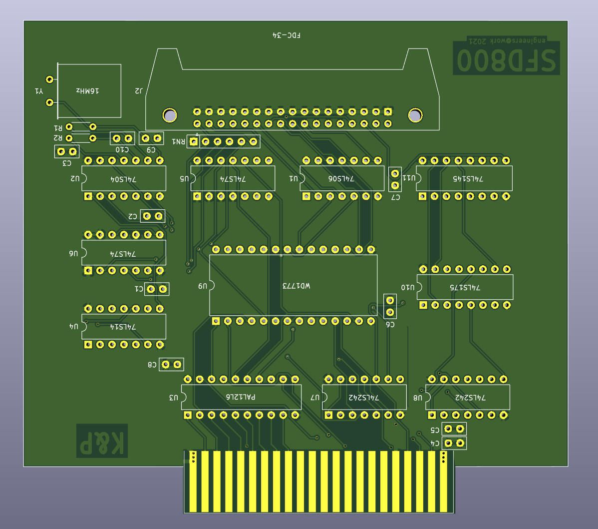

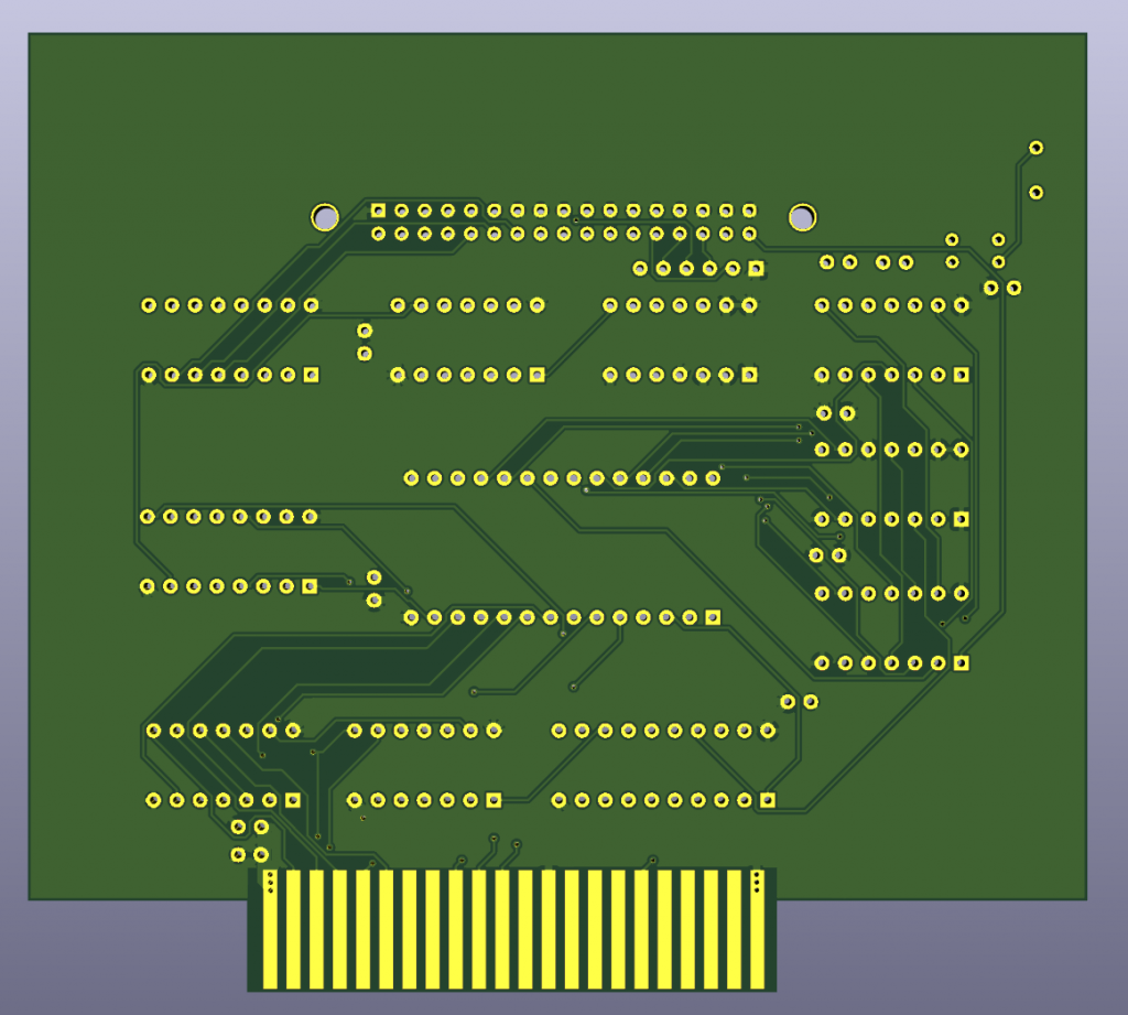

There are a few anomalies for sure with the Sharp FD boards. I've just finished duplicating the SFD800 and ordered up the PCB's, during some board layout checks I discovered that the 34pin IDC on the SFD800 card is reversed, pin 34 is where pin 1 should be, this explains why I have to reverse the connector going into the HxC!! Either this was a K&P production error or another difference in the FD implementation at the time!
The replicated SFD800 boards:
Re: MZ-80b FI/O to HxC Cable
oh put me down for one of those. I assume all the ICs are still available?
