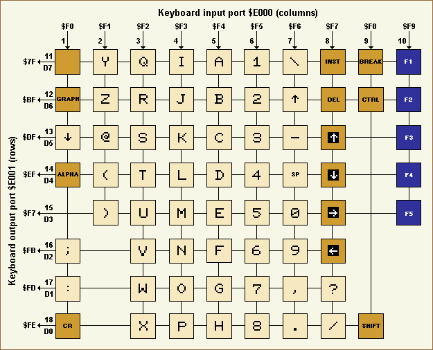

Confirm if you can, that my understanding of the matrix is correct. It appears that if I write a column value ($F0 to $F9) to address $E000, then read back the row value on address $E001 and CP against the key of interest ($7F, $BF, $DF... $FE), I can confirm whether the key of interest was pressed or not. True?
jejump
Posts: 31
Joined: Tue Jun 04, 2019 9:32 pm
Re: Assembling Z80 source using TASM or similar
Post by jejump »
YES! I was correct. I added this to my program and now I can see the hexadecimal numbers $F1 to $F4 correspond to F1 to F4 keys respectively. Lovely learning experience!

:roll: And AGAIN!... I forgot there are FIVE function keys.
