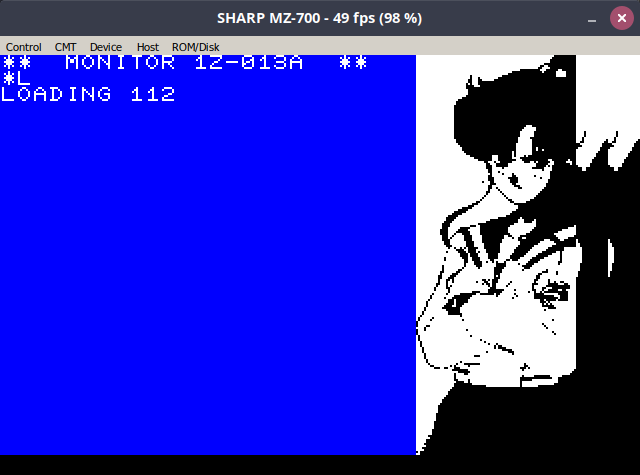

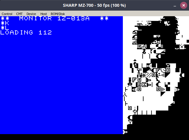

I modified EmuZ-700 source to make a PAL version with PAL timings (borrowed from EmuZ-800). The purpose was to test my current game which is written to use the PAL timings. I tried several demos (including yours) I could find on Pouët website. There is only one demo (neotokyo) which fails on the last part (the one with graphics), be it with PAL or NTSC EmuZ-700.
Re: MZ-700 demos
Here is the link to the binary package offering both PAL and NTSC version of EmuZ-700: the PAL version runs the CPU at the expected frequency (17MHz/5 and not 14MHz/4), the FPS will be capped to 50 instead of 60 and the video timings are those given in the PAL MZ-700 service manual. I maybe miss something as things in EmuZ-700 tend to be hardcoded though. It is no clear the video capture is really capturing 60fps or means a full capture (and so 50fps in fact).
The handling of BLNK signal doesn't seem to be emulated strictly as the document says: /BLNK is shorter than /HBLNK and should have a shift that I don't see in the emulator. I wonder it may explain the bad result with neotokyo at the end.

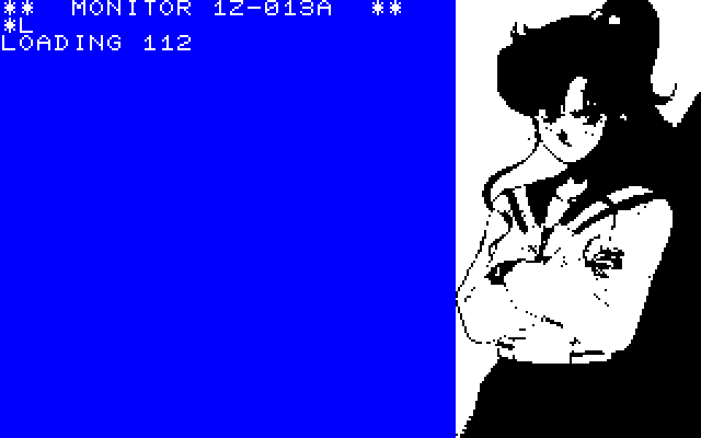

I made a quick test by adding a extra push/pop to the line update. It worked but the last word is repeated as I ran out of registers.
Capture d’écran du 2020-05-24 16-33-09.png (13.34 KiB) Viewed 78413 times
I tried to save the penultimate hl but it's taking too long.

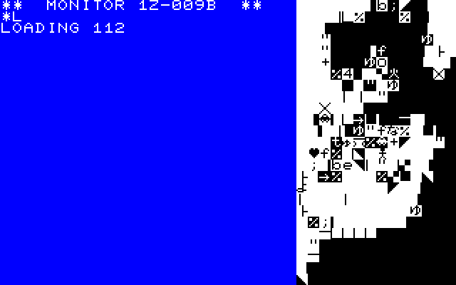

macro raster_update, index
Capture d’écran du 2020-05-24 16-37-28.png (13.3 KiB) Viewed 78411 times

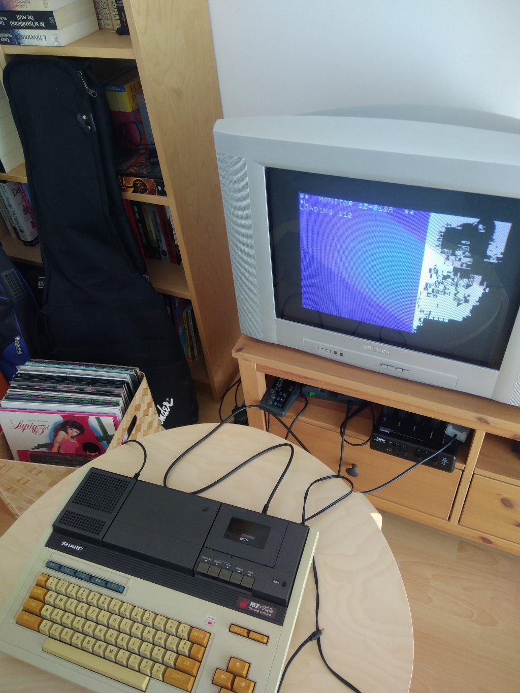

And... it doesn't work on a real mz700.
