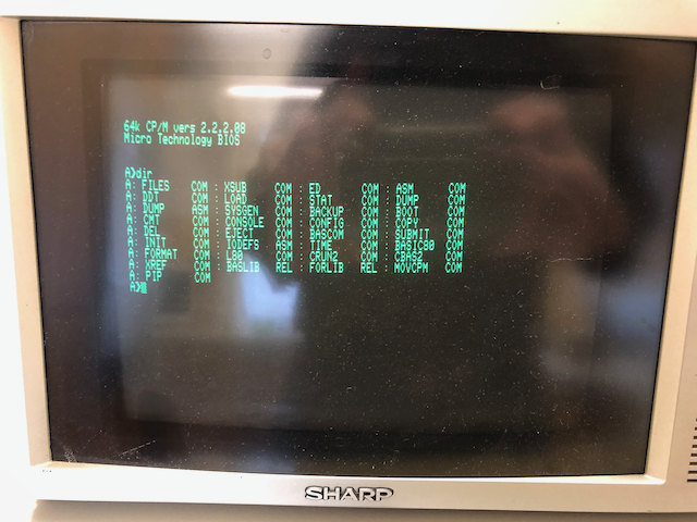

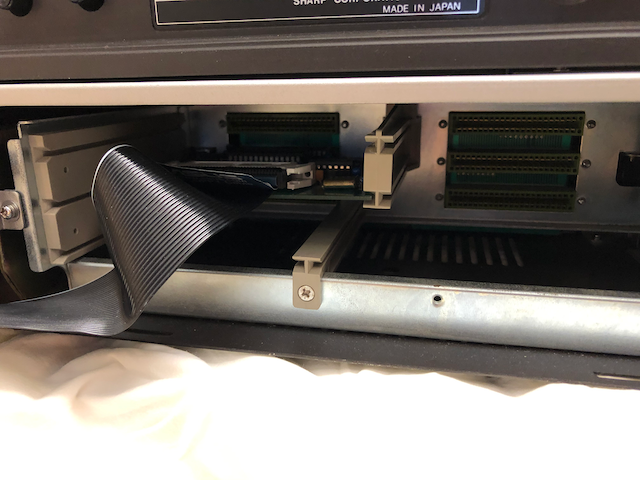

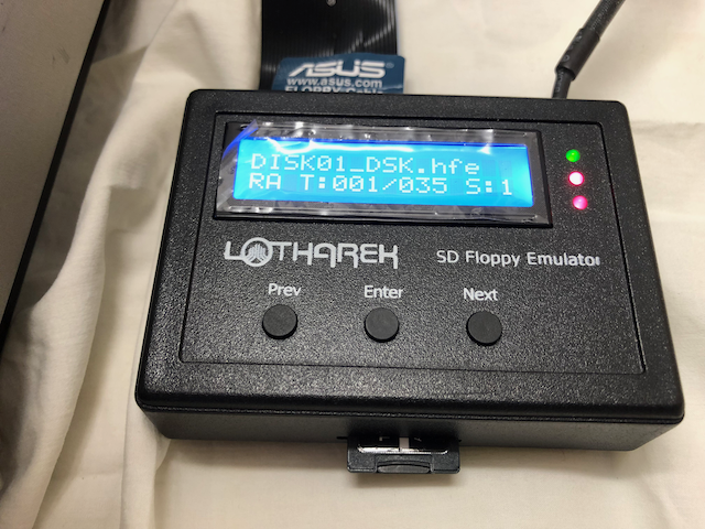

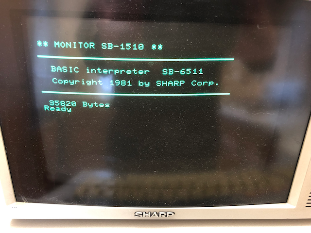

Tested the SFD800 on the MZ-80B today using the HxC, an ASUS twisted floppy cable, the disk images from original.sharpmz.org and the new GAL and as can be seen, everything works, CP/M + DISK BASIC SB-6511. If you dont have joy with your HxC then the Floppy Disk Interface card will be the culprit.

ps) The Lotharek HxC may be a floppy emulator, but it makes some of the right noises :)
