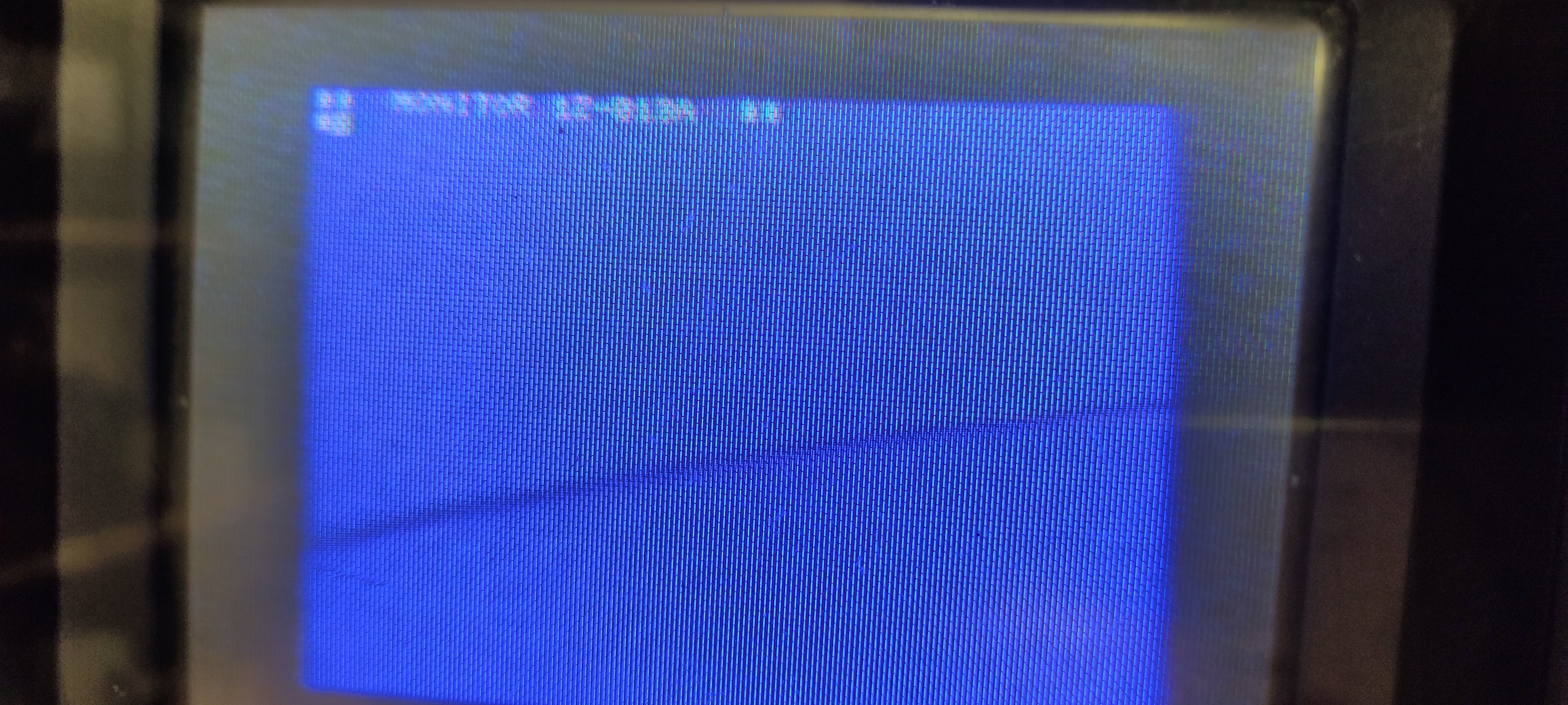

Hold that thought... scoped up the 5V around the board... there was a lot of crap on the rail around the MB8264-15 memory IC's... changed C82 and C86 ....
Bingo... I'm going to change the rest of those electrolytics, and there's a tant there too, and my hatred of tants goes back to the 70's...

One of the first things I do is check the voltage as some of the MZ-700's have been down to 4.69V, a tweak of the var-resistor in the PSU sorts it out. The tantalums of the era are known for going short circuit and the electrolytics drying out, cool analysis.
I re-capped an X68K and an MZ-2500 last week, 100's of elecs and tants, what a job and the X68K is a real pain, multilayer PCB with large power planes and no thermal pad grading!

Most of the RF output transistors I do as a day job have zero thermal relief on the pads, as the tab of the transistor is soldered to a large copper land in lieu of a heatsink. Hit it hard and fast with a metcal and a darn big bit usually results in them coming out without wrecking the board. *usually* ....

The X68K I tried multiple tips until I found a balance, not too fine or thick, 400'c, nip the tantalums off, wet it with fresh solder and solder suck - pulled a land off on the first few tries but once I got the method it worked reasonably well.

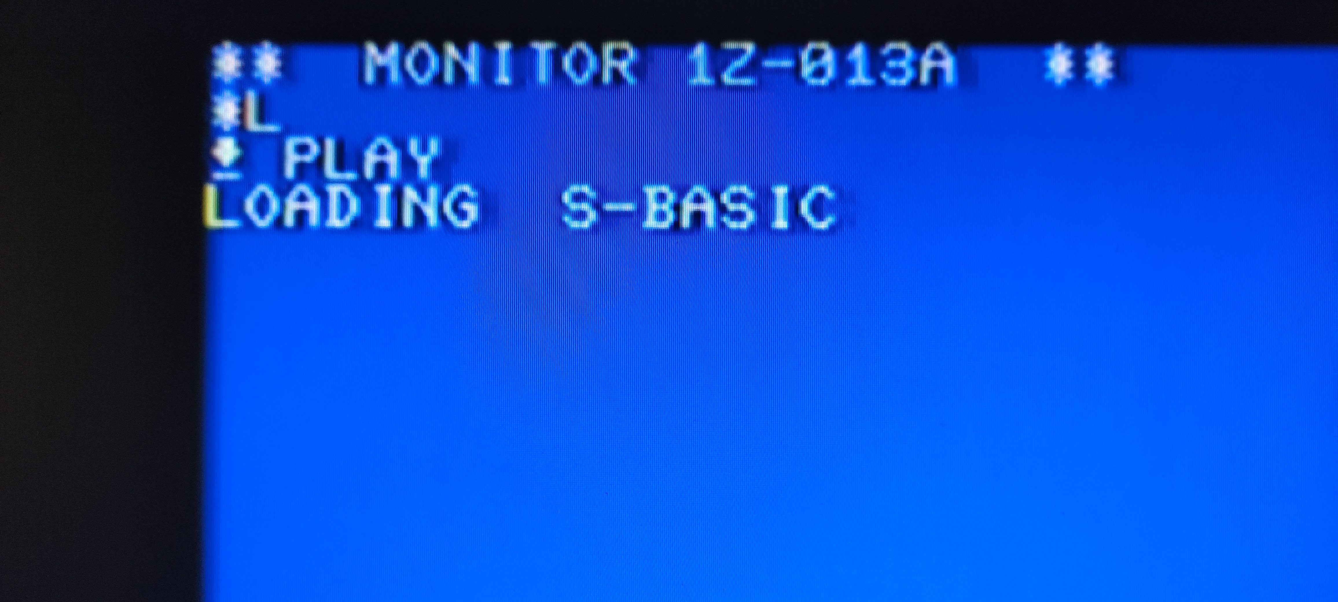

OK, got all the 8 caps replaced, repaired the keyboard connector (all the keys work, no one is more surprised than I) , changed the belt and the take-up reel table rubber to get the cassette deck to operate, and I'm now a shade stuck. A while back (and I forget where I got it from) I downloaded a wav of "Z80 BASIC V1.0" , which my friend nathan stuck on a tape for me.
I type L and CR... and hit play , everything seems good, but nothing changes on screen ... should it display "found xxxx" or something?

Hold the press ... I was too hasty ... I'd never got the "press play" thing before ... now I'm getting there !

The MZ700 cassette decks that have passed my way, especially if I've changed the drive belt, need calibrating with a 4KHz alignment cassette. The odd deck has needed azimuth setting too, this manual, page 17 https://original.sharpmz.org/mz-700/download/sm700.pdf details the procedure. It suggests using 8KHz for the tape speed and 3KHz for the azimuth, my alignment tape only has 4KHz so have managed with that.
Also, your friends tape drive, if not setup recently can be an issue too. I have quite a few tapes which came with a machine but not readable on an adjusted deck! One suggestion, albeit needs patience, set the tape speed and if it doesn't load, tweak the variable resistor a bit till you find a position it reads the cassette! You could setup your drive, borrow his cassette drive, load up S-BASIC on his drive, swap decks and run the tape copy procedure at 0x1108 so you get a good master.
When you type L, it should, within a few seconds output 'Loading XXXX'.

He recorded it on a Nakamichi Dragon I set up and calibrated for him a couple of years ago, it should be good
I can't get any further, and I'm going to hit the hay. I'll get out the cal tapes at some time and set the deck up.
