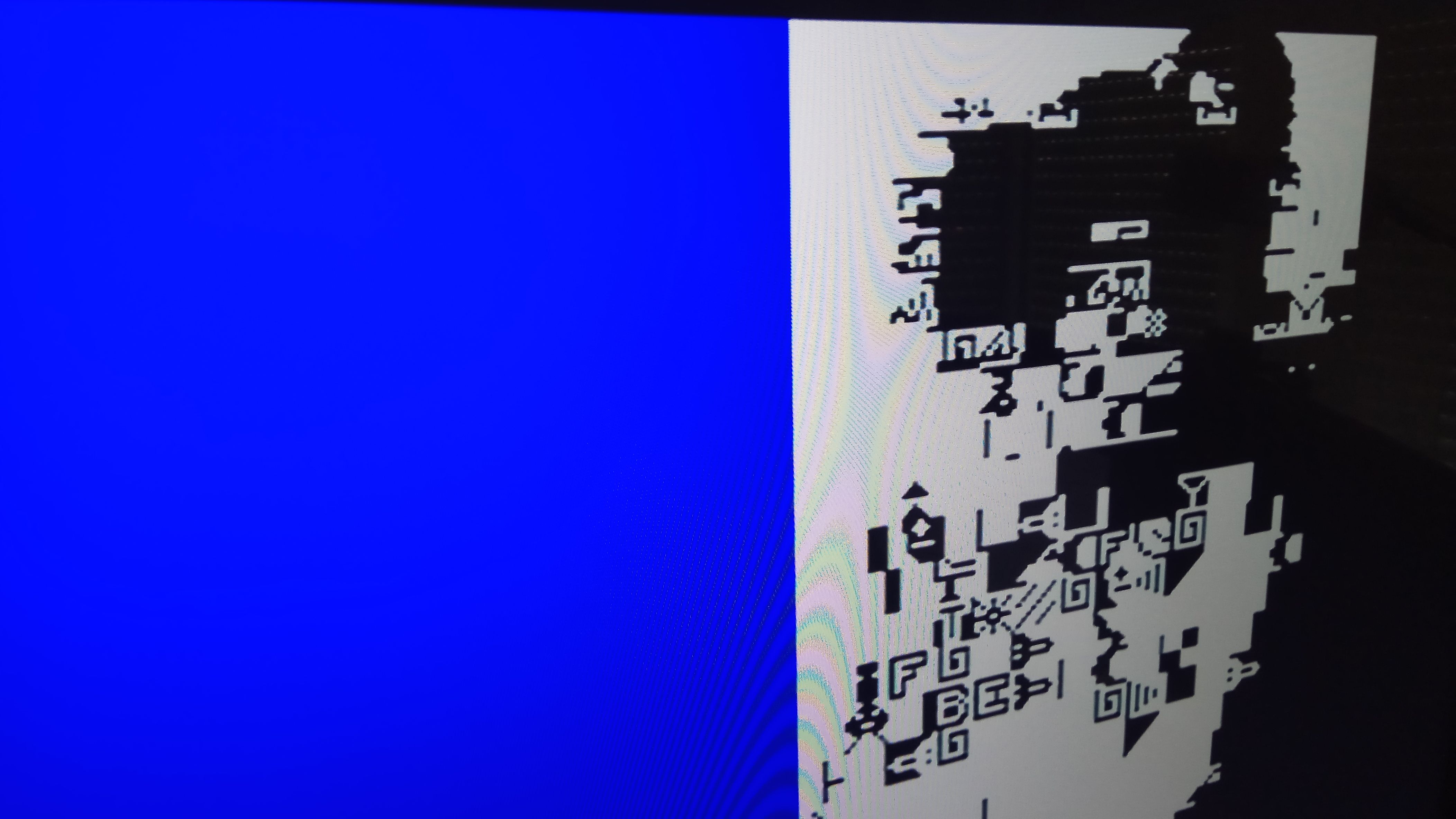

Et sinon, je vois un début prometteur sur ta photo puis ça se gâte à la deuxième ou troisième ligne de caractères.
The timings appear a little off after several raster updates so the issue is probably the length in cycles of your raster code which is two close to the end of the raster and makes the next raster to miss the BLNK synchronization at one moment: after that you only will get characters displayed.

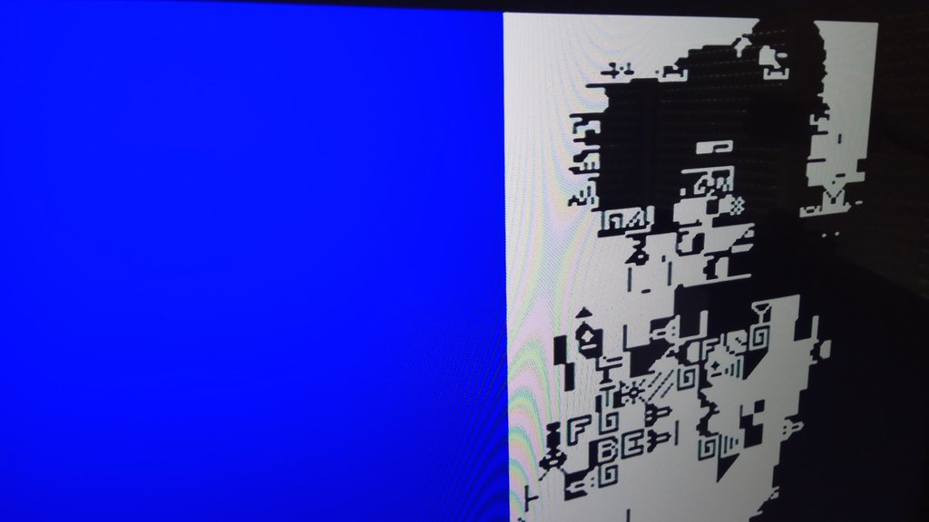

I tried two ways through my Unicard.
VGA output from Unicard: the timings is totally off. Just plain characters. It looks like the VGA output of Unicard is a no-go for games/demos using display precise timings.
SCART output from MZ-700: there is a rough mix of characters at the first lines, mostly like yours indeed. Ok the first lines are not exactly the same ones as expected as in my previous post.

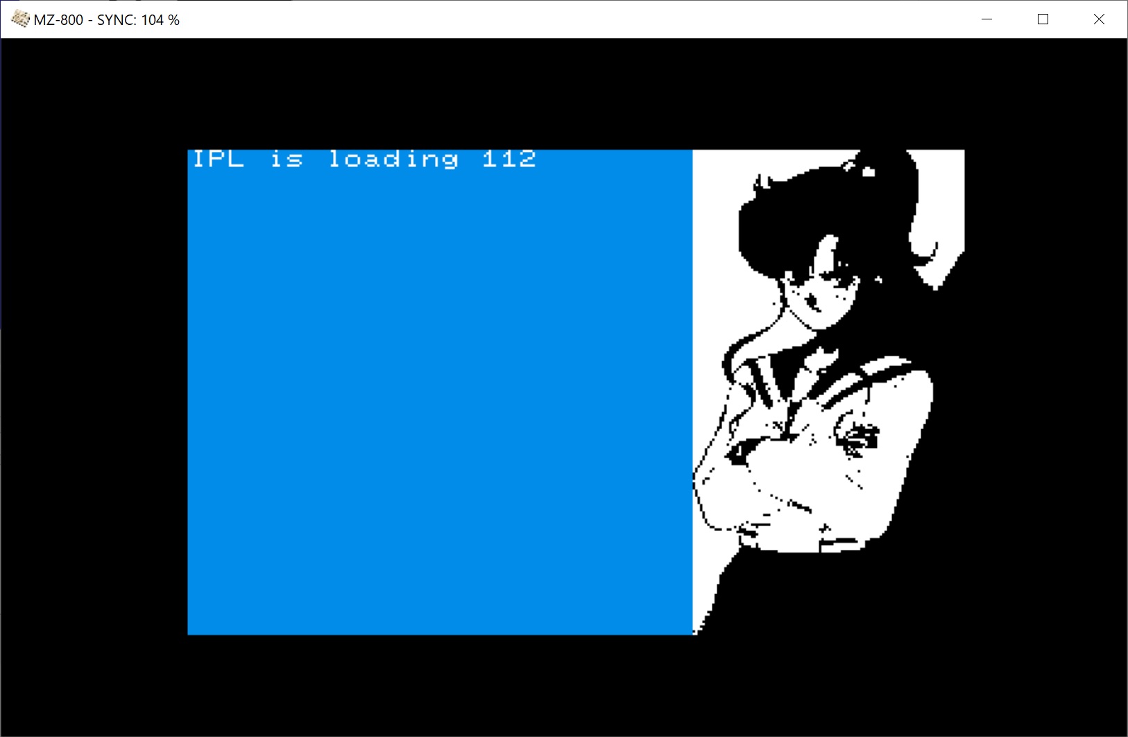

At least it works with mz800emu from Chaky :
