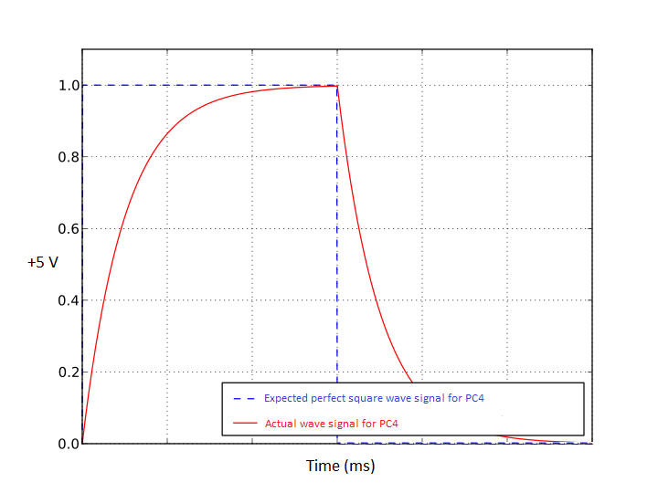

I have an issue with reading PC4: my oscilloscope shows me the signal is not working as a perfect square wave signal but something like that:
if the period is small, PC4 has no chance to reach the high level (1), the more I grow period, I'm getting more chance to reach it but it seems to be around 3s for my "UltraFast" mode in MZ-700 to be able to capture all the transmitted bits and to run loaded program (you need to keep the high and low levels stable a consistent time).
