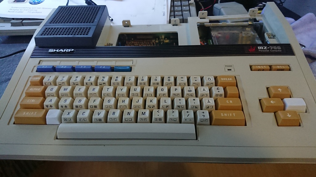

MZ700 new keys.png (866.13 KiB) Viewed 61585 times
PM me your address and I'll send you your new keys :)
I can't remember which of the arrow keys you needed, but don't worry if it's not arrow right, they are all identical.

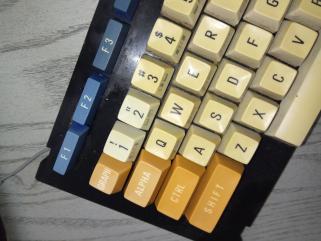

I tried to retrobright some MZ-700 keys without UV using only H2O2 and heat through a sous-vide cooker (not sure how to call that machine).
im01 (1).jpg (7.97 KiB) Viewed 61502 times

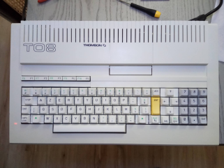

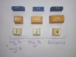

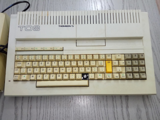

But I got a better result with TO8 keys as I could refine the experiment.
Before:
img3 (1).png (106.37 KiB) Viewed 61502 times
After:
Re: Mz700 repair project
Posted: Tue Mar 19, 2019 9:02 pm
Good work, another MZ brought back to life. Careful with retrobrighting it, looks like the key lettering fades just as quickly as the yellowing on the MZ-700.
Posted: Tue Mar 19, 2019 9:45 pm
The lettering is not fading but I have doubt about color : unlike TO8 keys the color keys on MZ-700 appear to be sensitive where there is a yellowish taint. The part where there is no yellowish taint has no changes. The lettering looks better indeed.
