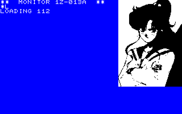

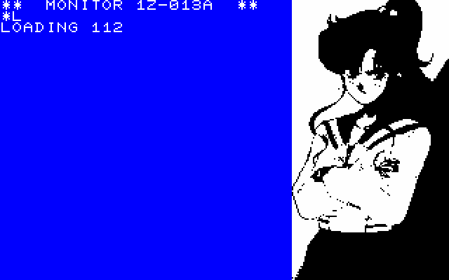

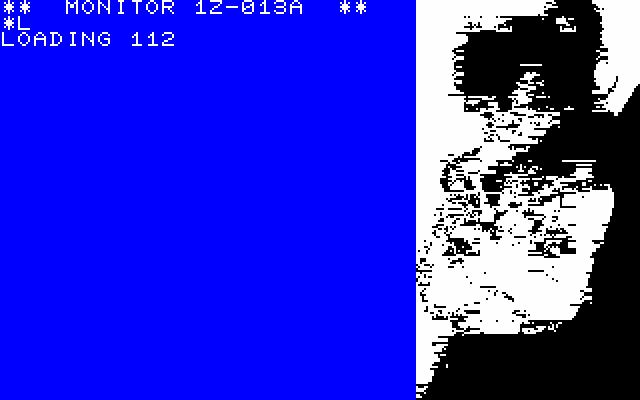

Inverting the /HBLK and BLNK signals in the vertical line event is making things complicated so I just add BLNK signal with its shortest period: it does solve the 112 issue I had with PAL EmuZ-700. But I still get around 13s instead of 16s.
What I had beforehand:
What I had if I reduce the character lines to 19 instead of 25:
What I have now with a full 112x200:
What I got when trying to invert horizontal period as shown in the logical analyzer:
