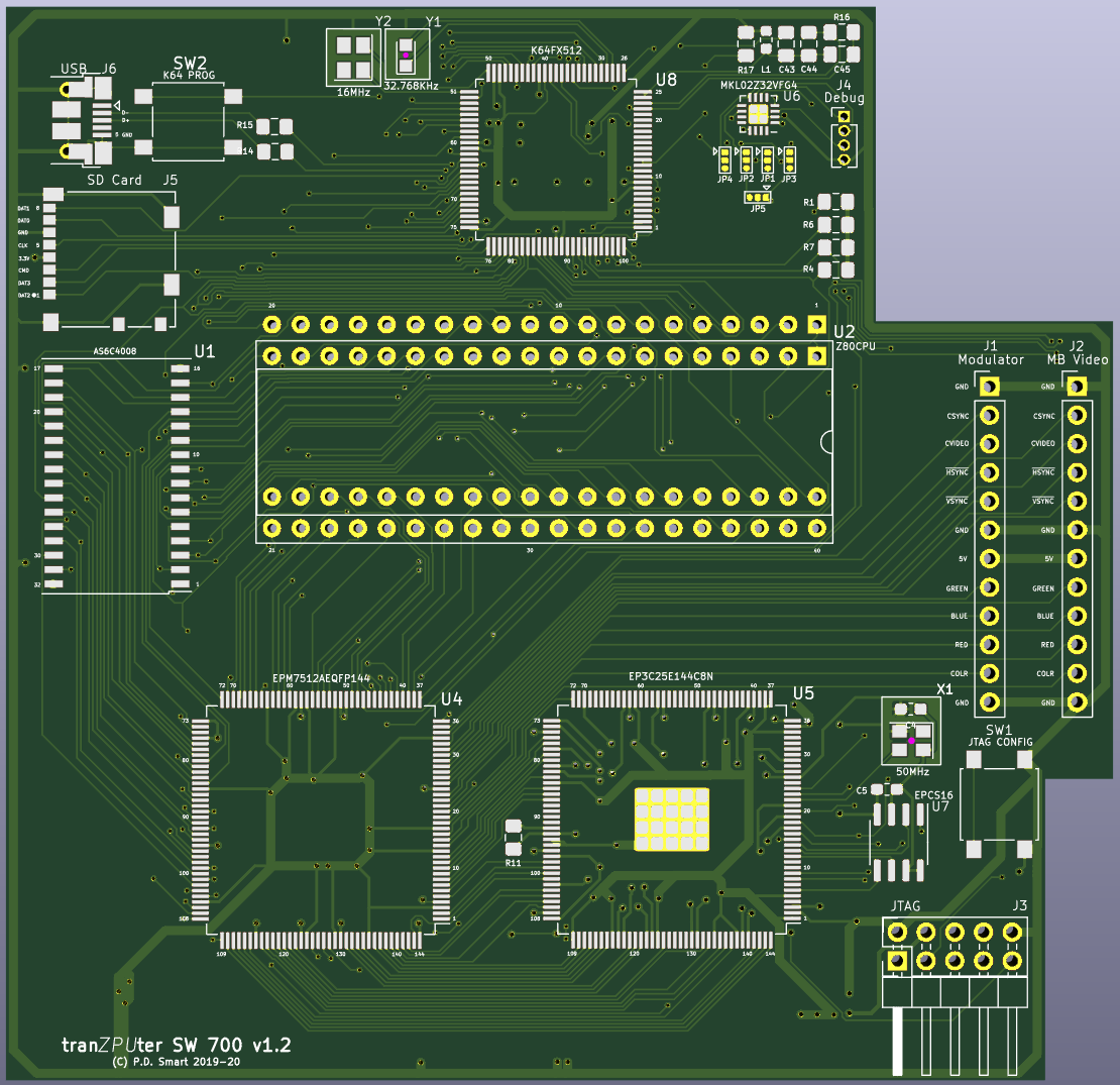

Welcome as well. It is probably easier just to write your own video hardware in VHDL, that way programming it can be as hard or as easy as you deem fit :) - ie. The board Im making below, recreates the MZ700 (/80A/80B) video hardware in the FPGA along with 640x200 pixel graphics 8 colour (due to lack of RAM inside the FPGA, otherwise would be xxx colours).

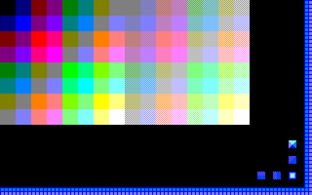

may I suggest a thing? when I was on BrickBuster game, I was trying to get more than 8 colors without hardware add-ons. The idea was chang
ing the color between frame in a similar fashion than http://www.aaronbell.com/secret-colours ... HoV_Gui5wA . But the issue is modern TV has their own frequency and it doesn't go well.
Here are two videos to show you the issue: the top window is my emulator that emulate the hardware color blending while the two bottom windows are just doing software color-blending. My TV being a 60Hz, even the NTSC version is not totally in phase.
- https://www.dropbox.com/s/b2kj1vsr0n5d5 ... 8.mp4?dl=0
- https://www.dropbox.com/s/sovwflbytozwk ... 0.mp4?dl=0
So why not to offer the ability of color-blending with your video output by adding a flag to set to activate it?
Technically, we want colors A and B in a frame sequence ABABABAB...AB to be CCCCCCCC...CC. AB or BA should give us the color C through a fix palette. C is among 36 colors (8x8/2 + 8). Just computing (A+B)/2 as it was in the emulation is not great. Having a more refined palette would be awsome.
And now a picture what it gives when you mix two different characters between frames using color-blending:

One of the advantages using the FPGA is you build the frames and can manipulate them, harder to do in physical hardware as your encountering. In the FPGA I have a frame-buffer which I render during the blanking periods (H/V) at 120MHz, either 320x200x3 or 640x200x3, the number of frames per second depends on the driving vertical frequency, the VRAM/Attributes get read and rendered into the frame-buffer and blended with any existing direct pixel writes during this rendering period. All the memory is dual port so as not to cause snow/tears. The video output is made in a separate process and if driving an external VGA display I make basic pixel duplication (ie. 320x200 on a 640x480 doubles the H and V pixels).
It should be easy enough to instantiate a palette register which adjusts the colour of the pixels based on the technique you mentioned, just keep a counter on the frame being rendered and then adjust the pixels being written to each of the RGB frame-buffers according to the palette value.
I started to look into it but then discovered a design flaw in my Video Module which Ive been trying to resolve! Once resolved will look further at this technique.
Regarding the MZ-700, the RGB signals are digital from the mainboard and are routed direct to the 8pin DIN. Inside the modulator, after buffers, they are converted into analogue using a resistor network before driving the modulator/Composite video.
On the MZ80A Video Module I used a 4x3bit RGB signal to allow for true palettes but on the MZ700 board Im working on I overlooked the above observation (8pin DIN being driven directly from the mainboard connector), so I will make some updates to add 4x3bit RGB and this will allow driving an analogue RGB monitor/VGA monitor.
If you don't have much success with your hardware palette resolution I can let you have one of my boards when complete (no cost) if your interested. I'm not making any of these for profit, just for learning and Im tending to make at least 2-3 as it is still quite tricky working with the QFP packages, you never know if you have a software/vhdl or physical issue when a bug occurs, so being able to swap the boards around helps. On some of the previous boards Ive had to use flux and a hot air gun on some of the QFP packages as the solder type/quantity during the SMD stencilling isn't as reliable as I would expect, would be nice to have a pick n place machine for these devices!!! If you look at the boards I've started putting pin numbers on the QFP packages to make it easier due to the hours spent connectivity testing.

Just a quick update, I've been in Austria for the last few weeks so I haven't completed everything yet, but the pictures will give you an idea. All functionality works so far but I have still to make several changes to the VHDL in the FPGA/CPLD for the graphics. At the moment, standard video works,the tranZPUter part works so loading from SD card etc. Probably end of month but will update my website www.eaw.app and forward a board to you.
