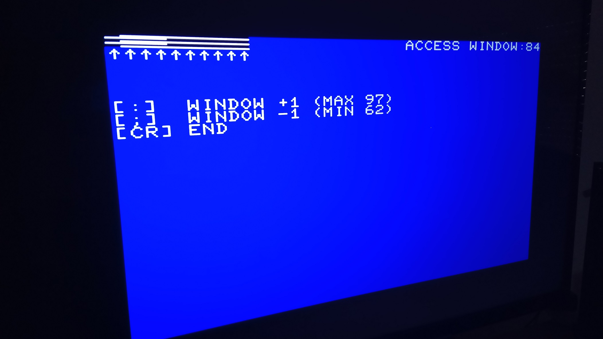

Genuine MZ-700:
PAL EmuZ-700:
Now why the genuine MZ-700 can accept 83 cycles while the logical analyzer says the BLANK is 80 cycles? In fact when you execute a PUSH, you have 4 cycles in fetching the opcode which is not blocked by the /WAIT state. So I think we have up to 83 as 80 + 4 - 1.
Wait for BLANK==1 ---> First PUSH is blocked and so it and the rest are countable in the 80 cycles (what my logic analyzer gives me)
v
[PUSH:11][PUSH:11][PUSH:11][PUSH:11][...:n-44][PUSH:11]
Wait for BLANK==1 ---> First PUSH is executed and then set /BUSREQ to 0 because it tries to access VRAM whan BLANK==0
| Second PUSH is now blocked and so it and the rest are countable in the 80 cycles
v v

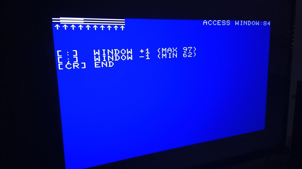

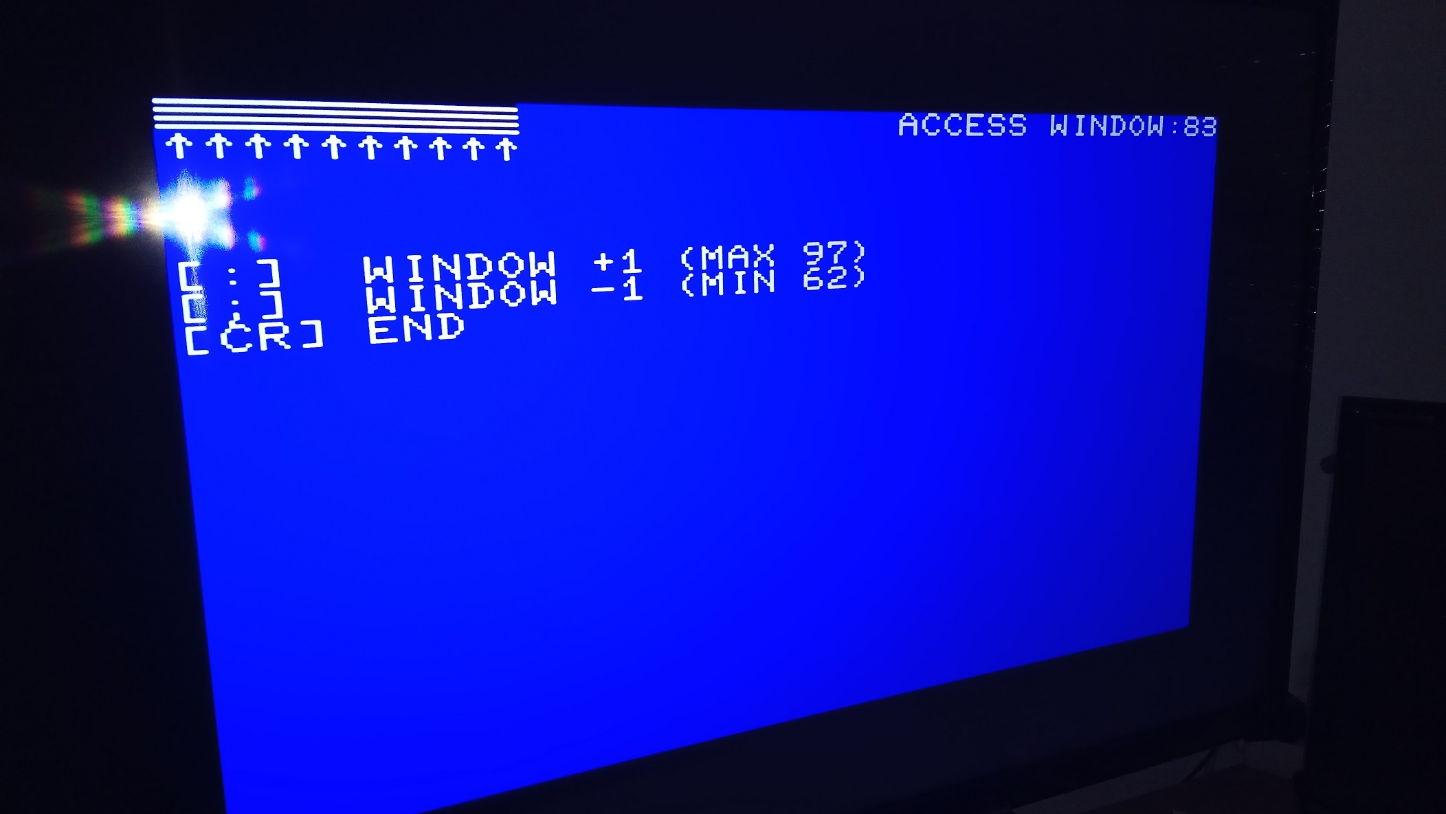

Re: MZ-700 demos
@Sdw
As you said 82 cycles was the max working I had a doubt. So I tried `wt` on my genuine MZ-700.
83 is the max working (phew!) Higher than 83 shows a permanent disruption. So that confirms my equation: N cycles are working if N - 4 < 80. For NTSC, it should be N - 4 < 60.
Now let's compute for a PAL genuine MZ-700:
21000000 / (312 x 83 x 50) ~= 16.2ms
Now let's compute for a PAL EmuZ-700 (`wt` gives me 91 as the highest accepted value):
21000000 / (312 x 91 x 50) ~= 14.8ms (I rather got 13ms on my chronometer)
On PAL EmuZ-700:
Now temporaly removing 11 (PUSH INSN) - 4 (PUSH OPCODE FETCH) cycles in BLNK period to mimic the genuine MZ-700 when executing wt.
-> it does behaves the same as genuine MZ-700 with `wt`.
But if I want to test with `emutest`, I must handle LDIR instead of PUSH so now removing 21 (LDIR INSN) - 4 (LDIR OPCODE FETCH) when executing `emutest`.
-> Bingo! 16ms!

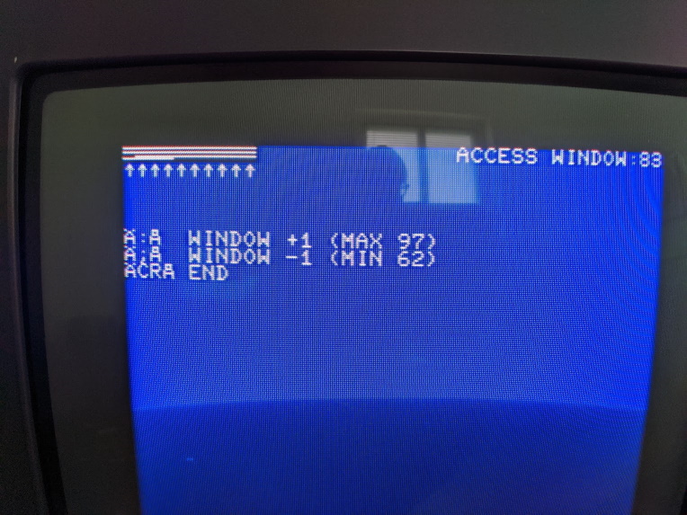

Re: MZ-700 demos
It's interesting that you machine is stable at 83 cycles, I get stable no-bug at 82, but flickering bugs at 83 already.
Anyway, what I gather from your investigations is that:
1) Emulator had wrong number of free cycles from the begining (91 vs 82/83)
2) Even with corrected number of cycles, it will not work properly, since Z80 is emulated at an instruction level, and the locks can happen on individual T-states within the instruction. You have verified this by hardcoding a static decrease in the number of available VRAM-cycles that corresponded to the test program you wanted to run.
If haven't looked at the source code yet, but how is the Z80-emulation vs. VRAM-locks handled? Perhaps some kind of look-ahead could be added, instead of checking "are we in a VRAM-locked state" before running the instruction, do a "will the number of cycles this instruction takes put us in VRAM-locked state".
Maybe I'm just rambling, I probably should check that source first!
