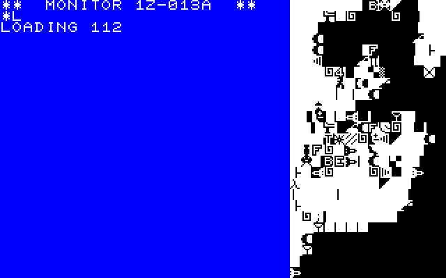

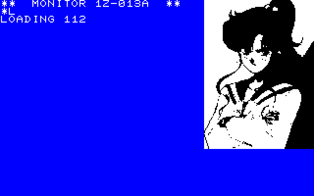

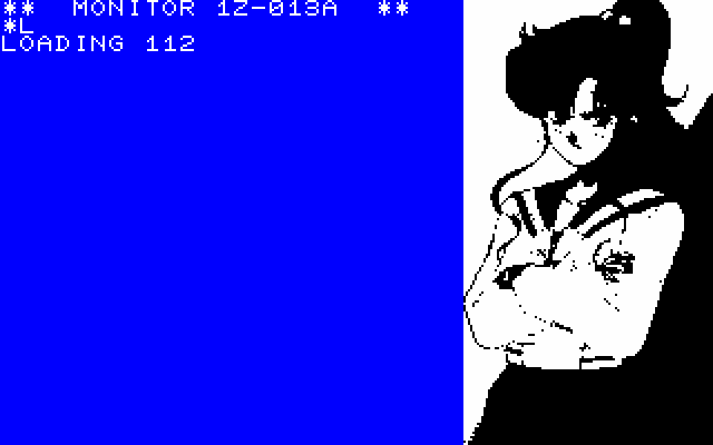

Inverting the /HBLK and BLNK signals in the vertical line event is making things complicated so I just add BLNK signal with its shortest period: it does solve the 112 issue I had with PAL EmuZ-700. But I still get around 13s instead of 16s.
What I had beforehand:
What I had if I reduce the character lines to 19 instead of 25:
What I have now with a full 112x200:
What I got when trying to invert horizontal period as shown in the logical analyzer:
I cannot say I'm satisfied. The EmuZ-700 made some silly choice about how to handle wait states I don't agree with. I also don't agree with the choice with using /BUSREQ to handle VRAM access because of the poor way to handle wait states.
Not only that, the way to handle the BLNK counter (PIT CLK1) is not even synchronized with the BLNK signal. And the /HBLK signal is not even used for the MZ-700 joysticks ports (well I guess EmuZ-700 is not even handling any analog joystick, so it is less a surprise).
