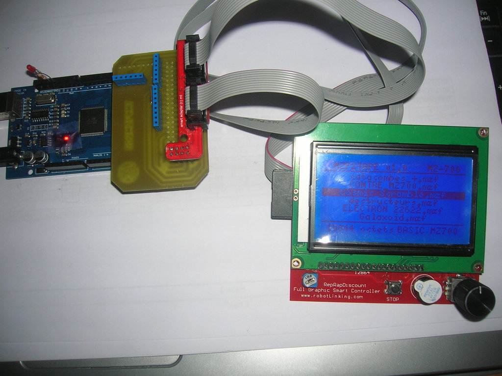

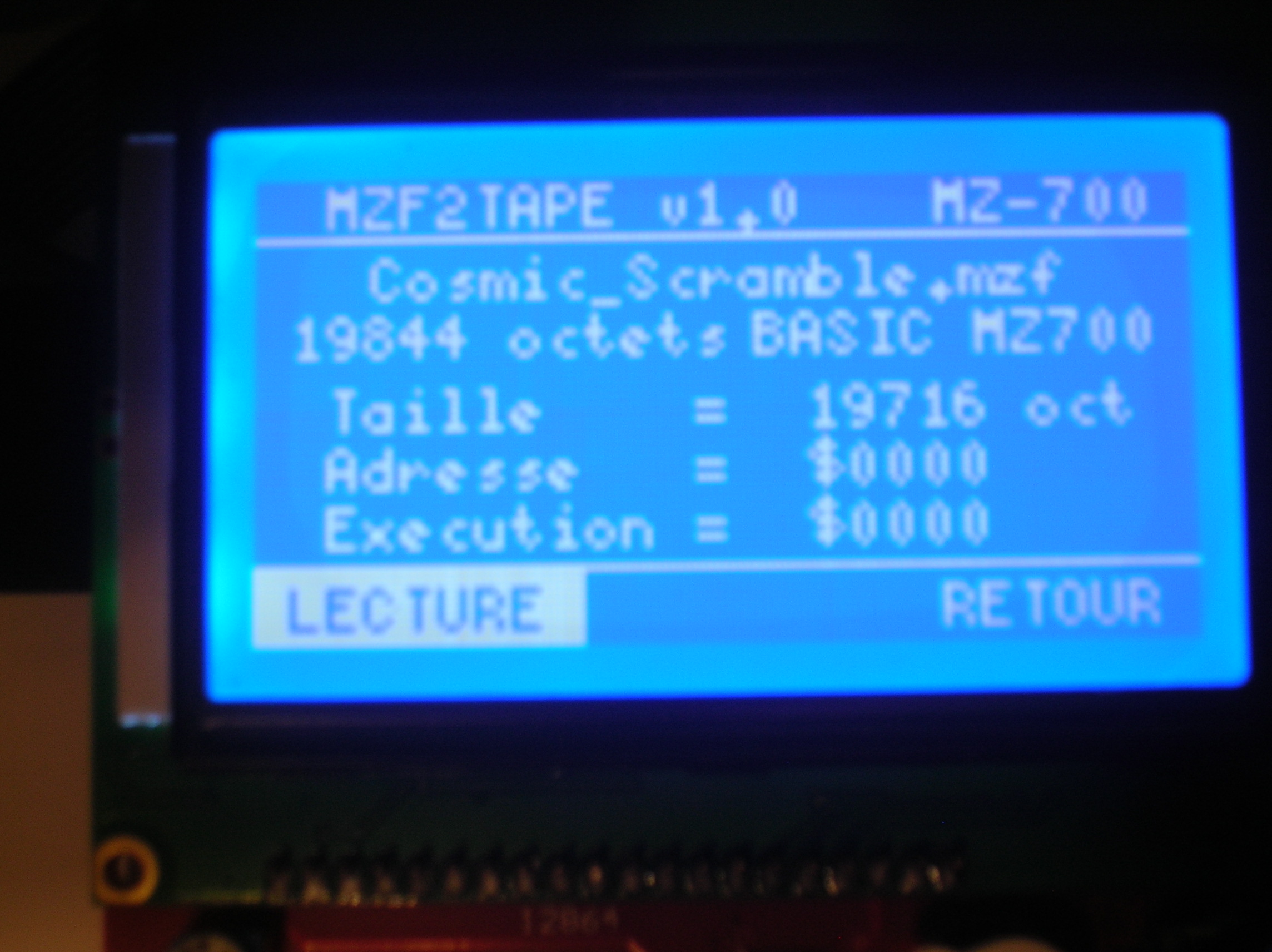

Hello to all the community,
I took over the work of hlide to be able to offer an interface for reading the files MZF, M12, MZT, BIN using a graphical display reprap discount full graphic smart controller. It contains a built-in SD drive and connects easily to an ATMEGA2560.
I planned to use several profiles.
I have not finished the project yet, but I can read any file under monitor 1Z-013A and under sharp basic 1Z-013b.
I will post all the work very soon: PCB card, ino program and connection diagram.
Vu d'ensemble
Vu d'ensemble
Détails
Détails

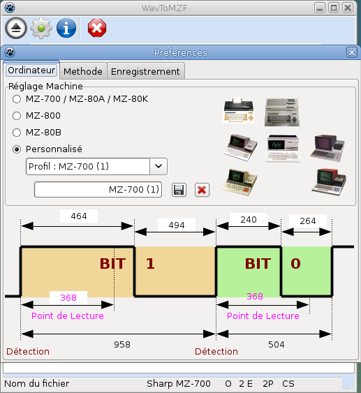

J'en ai plein sur cassette et vais aussi diffuser un programme de traduction de fichier wav vers programme MZF, qui pour l'instant m'a permi de récupérer l'ensemble de mes programmes enregistrés sur des cassettes originales.

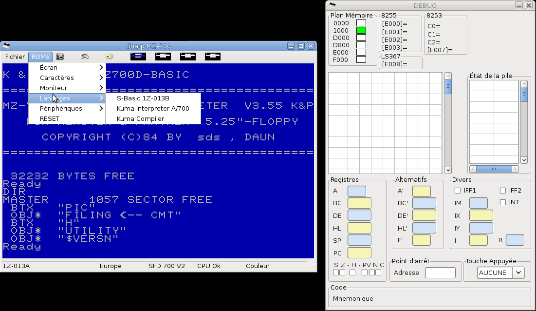

Emulator Sharp MZ-700
WAV2MZF automatic
WAV2MZF automatic
