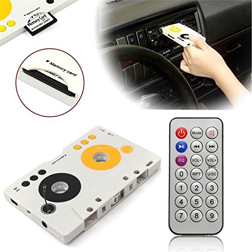

Never tried but that kind of device may work with the real tape device. Put an SD card on that cassette and just play it. But the price is quite... not cheap. Obviously, you need to convert MZF files into MP3 files if not WAV files.
https://www.amazon.com/Promotion-Vintag ... SA17CBYQXC

Looks like a great idea, i might give it a try.

I bought one of those sd card cassette. Unfortunately all I got when I try to load a tape is "Check sum err".

MP3 files are compressed and when played back they are not good enough.
Try a MP3 Car Cassette adaptor and play WAV files from the phone jack of your PC at 20% volume.
