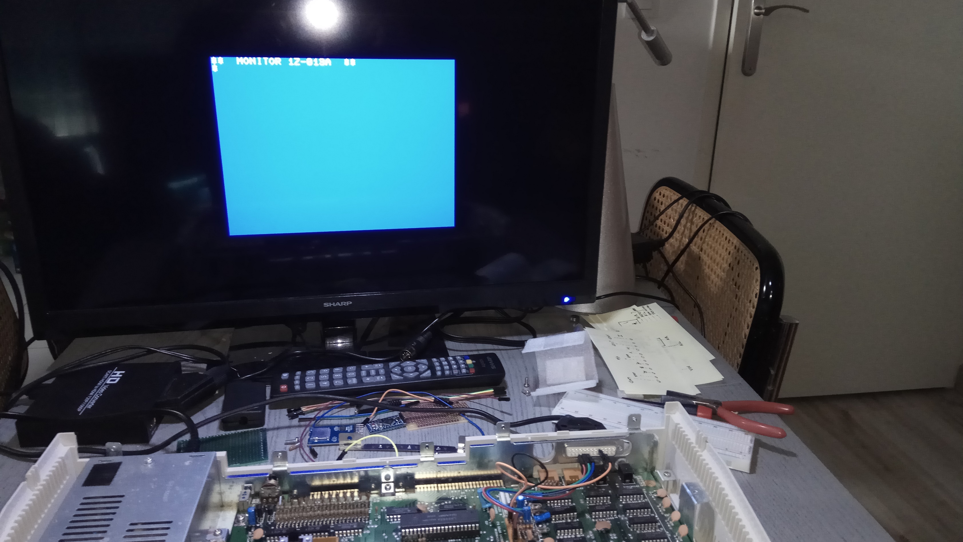

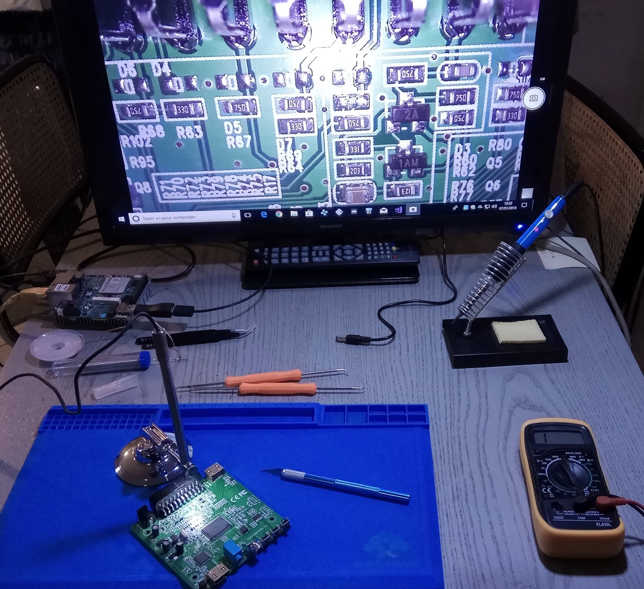

Here is my work environment:
You can see I have an endoscope plugged into an embedded PC which displays on my modern TV. The circuit of the converter is quite small so this camera is a handful device.
The idea is to use this converter to provide fast switching with the voltage that goes well so that the TV receives well in RGBS.

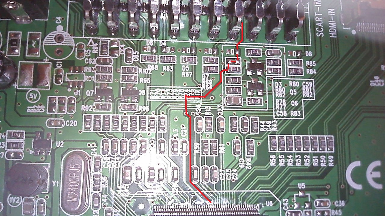

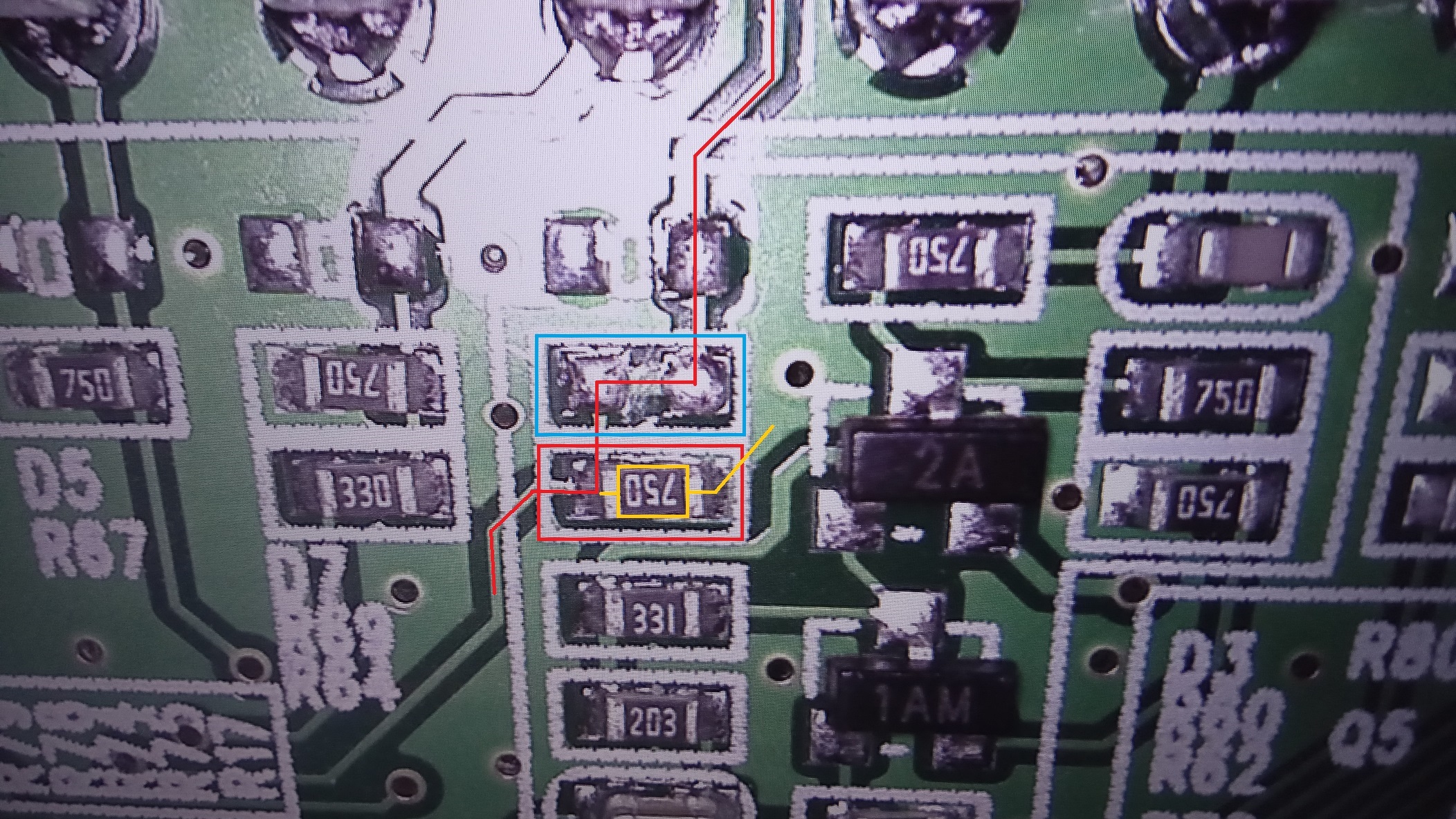

But there is a problem. The circuit of the converter has obviously changed since the last update of the tutorial I link here. The link states that a trace must be cut between the fast switching pin and the first 75 Ohm resistor connected to the ground in parallel. Just after this resistor, there is a ZD1 diode where we must add a wire connected to a source of 5V with a serial 100 Ohm resistor. Now, this diode is no longer!
So I tried to follow the trace: it goes through the same 75 Ohm resistor connected to the ground in parallel. So I guess I just have to cut it. However, on the other branch in parallel, there is no more diode and the trace drives straightly to a pin of the big processing chip.
The circuit with the 'FAST SWITCH' trace drawn in red:
The voltage applied to FAST SWITCH must range between 0,3V and 3V so the SCART should use RGBS signals and not composite ones.

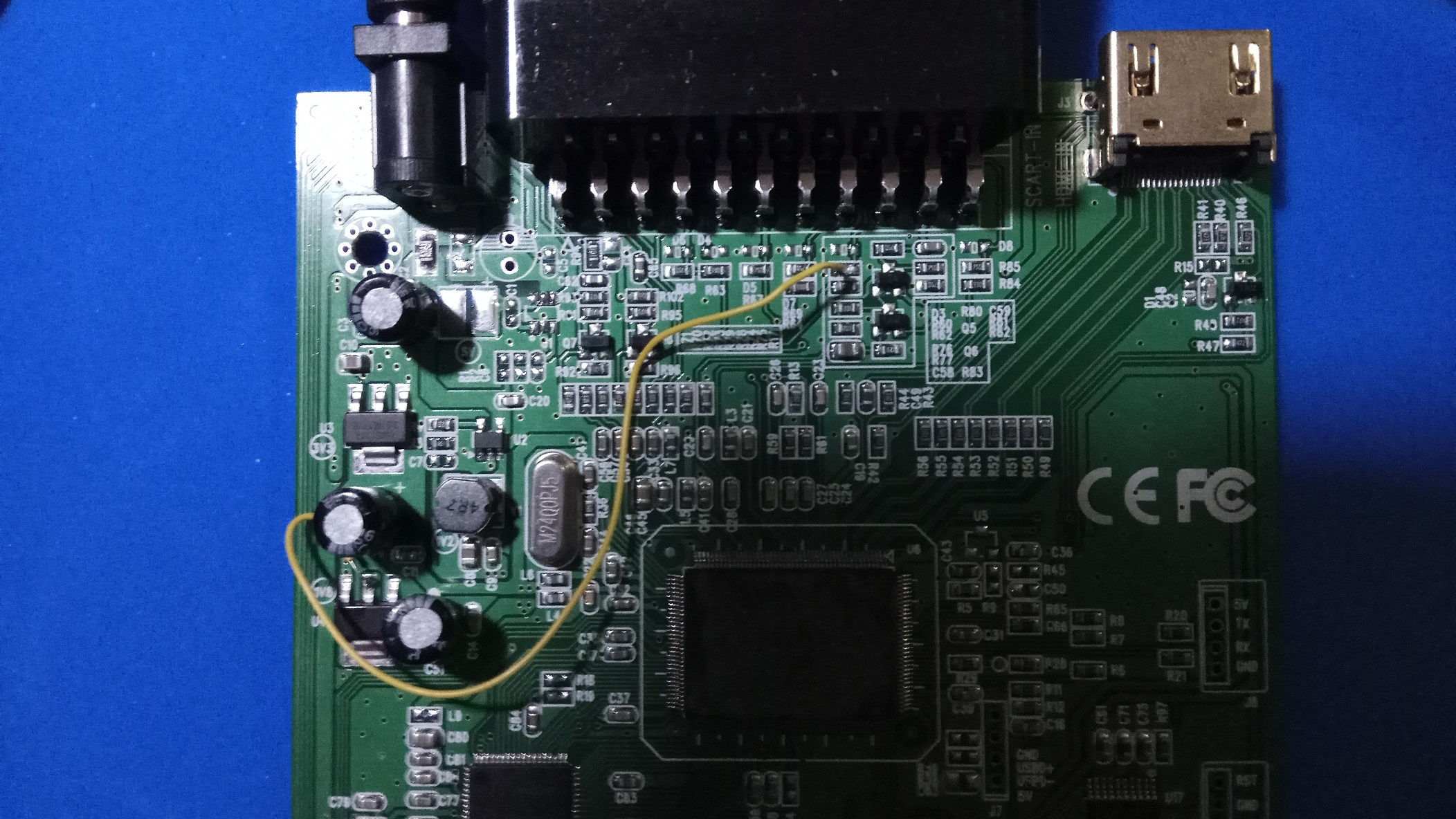

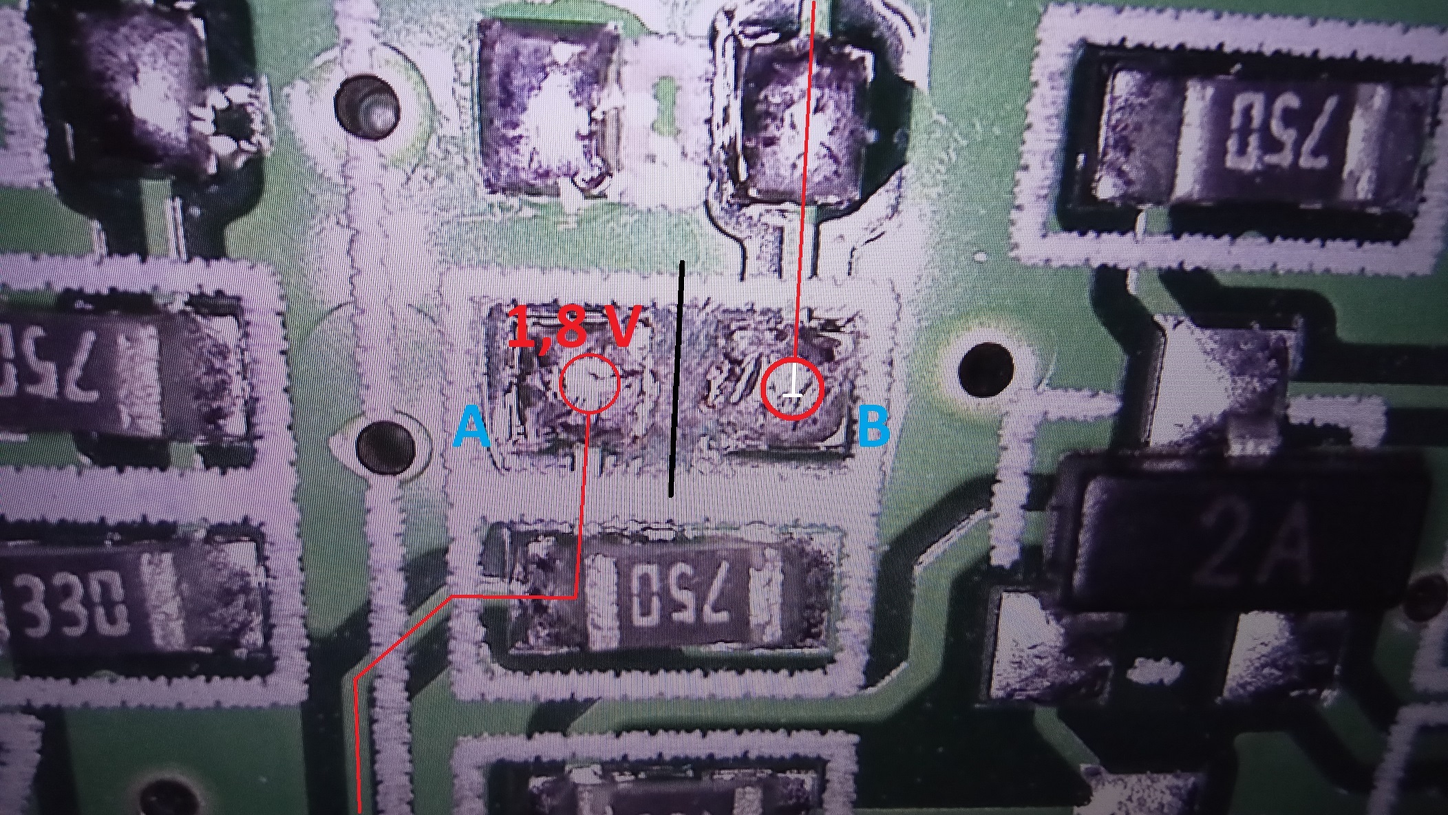

2) Steal a voltage from a regulator:
There are several regulators
But 1.8V U4 is the best choice for soldering and voltage range matching.
I chose the second solution.
I noticed that there were two pads just above the 75 Ohm resistor and a trace that connected the two pads. If I want to be able to go back to the origin, I just need to connect these two pads and remove the wire:
- cut the track between pin 16 of the SCART (fast switching) and the connection point between two branches, one of which has a 75 Ohm resistance connected to ground.
- connect the 1.8 V output of the U4 controller to the connection point of the two branches with a wire.

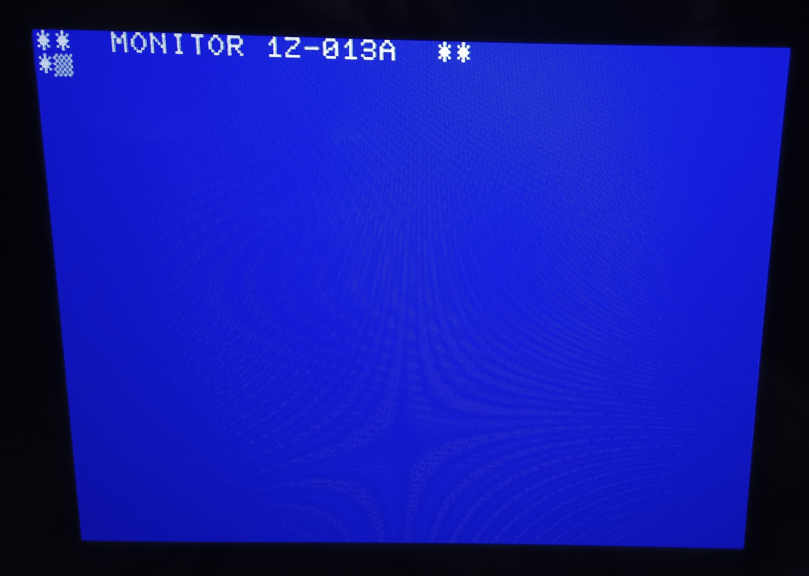

Let's see the result!
Note: my converter is outputting 800x600 and my TV is currently in a special mode which allows showing one source pixel into one destination pixel in a centered window so the monitor screen may look tiny on my TV. The display and text are really much crisper than the one I got with composite or RF signal.

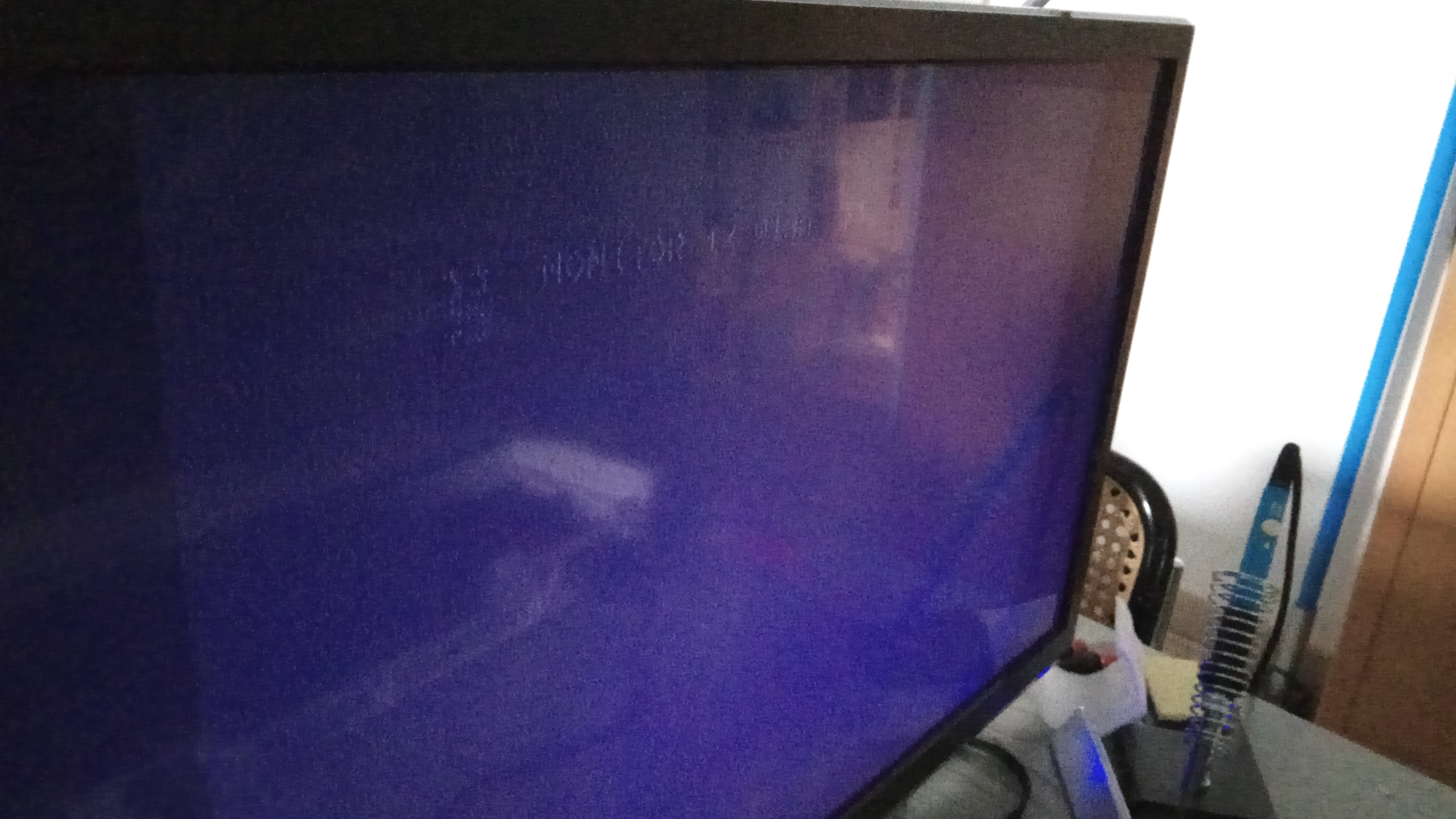

If I try to plug the SCART cable to my TV instead of the converter, TV looks for the best signal and chooses a CVBS signal in the end. Here is what I got:
And closer:
I also tried with my first SCART>HDMI converter which isn't modded and got the similar result.
To compare to the output given by the converter with the proper modding:
