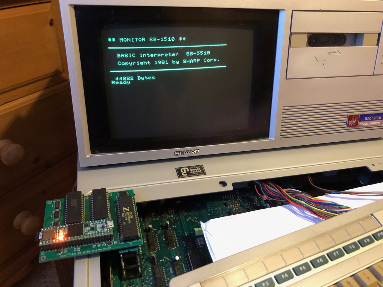

I have an MZ80B with the SB5510 tape but no idea how to copy it, on the MZ80A and MZ700 it is easy as the BASIC has a built in copier. Im more than happy to make a copy and post it if anyone could advise how. Alternatively if you have see the post above for software to allow you to create a tape.
The MZ80B uses a fully automated tape deck, it rewinds, fast forwards, plays etc automatically, on switch on if you press C it will load then rewind the tape.
On my MZ80B and all the other machines I have, I performed complete strip downs to the minuscule parts, all electronics were washed in Isopropyl alcohol and gently rubbed to remove dirt and grime built up over the years, all plastic parts were subject to a full soak in detergent. On the 80A I had to do a bit of retrobrite-ing as the cassette deck lid had yellowed but this wont be an issue on your 80B as it is nearly all metal or silvered plastic! Certainly the power supply capacitors need to be replaced, they are the suppressor capacitors on page 41 of this document: https://original.sharpmz.org/mz-80b/dow ... 80b_sm.pdf, C101 and C102. The electrolytic's are surprisingly robust, but if any of them appear to be bulging best to replace them. The cassette deck will need a good clean, at minimum clean the capstan rollers and heads with a cotton swab and isopropyl alcohol, also the drive belt pulleys to get better grip.
In terms of the floppy disk card, there was one on Ebay a couple of weeks back but it's gone now. I have the K&P 700 card which is a description is on this link https://original.sharpmz.org/mz-700/download/sfd700.pdf. Reading the threads, seems a number of people have been after cards over the years, if none appear on Ebay it may be an idea to make one.
I've been making a few upgrades for the Sharps, I tested one of the boards I made for the MZ80A /700 on the 80B yesterday, the board works but will need re-designing to fit the 80B, has to be opposite direction and low profile. This board adds SD card amongst other capabilities.
If you cant source a tape/make one then drop me a message and I'll have a go at duplicating mine.
If you havent researched yet, a good site to get documents and software is https://original.sharpmz.org/ - it has all the manuals, service manuals etc as well.

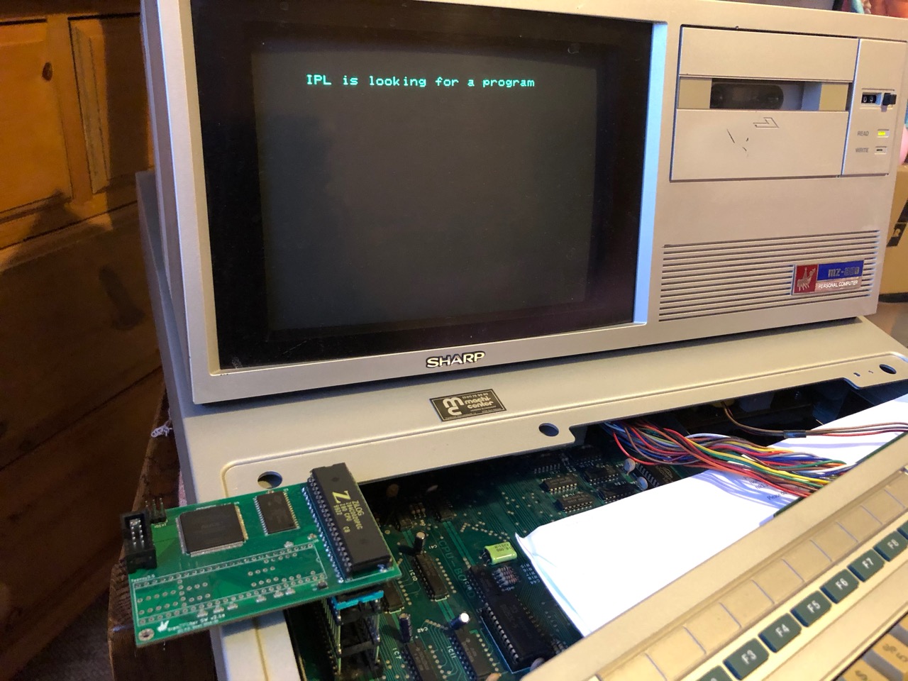

Smaller newer design which will fit just CPU is wrong way around!
