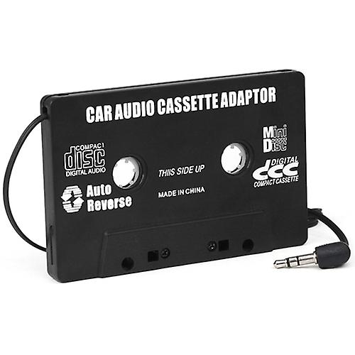

Have you tried converting a "fastloaded" program to WAV and load it using a PC and a cassette adapter like this one?
Re: Sharpworks Fast Loader
Yep. And it worked :)
Although I would usually use one of those for transferring from laptop to Sharp.
When I'm transferring from Sharp to laptop I usually use a hi-fi separates tape deck with USB soundcard.
MZF Studio is capable of reading the fast WAVs as long as it's set to MZ-80B import mode :)
It won't read the standalone compiled ones though as they contain a sort of bootstrap to load the fast data.
