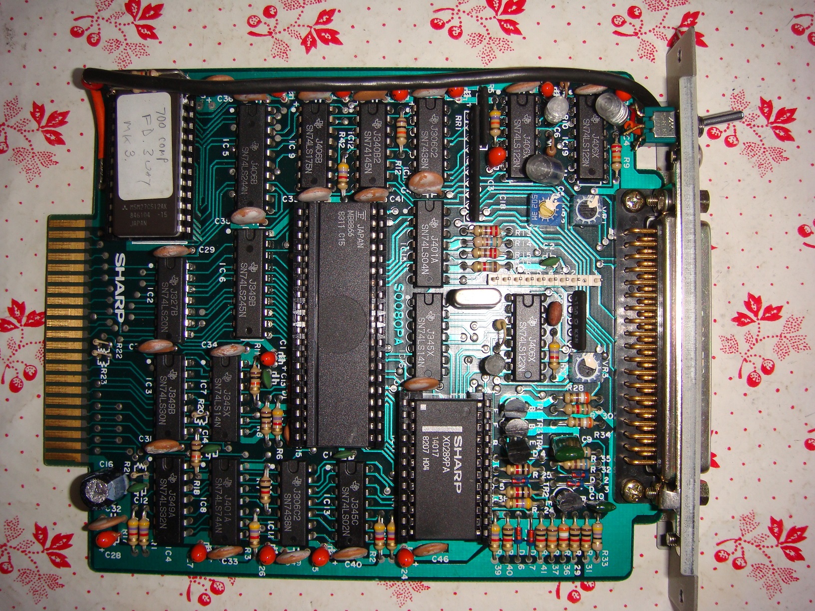

The MZ-1U06 contains 2 daughter boards (sorry I can't attach 2 files in this post, else the second vanishes !), one is MZ-1E19 but I can not identify what is the second board.
As you can see on pictures, the second board was modded with a switch fitted on it. The 1U06 case has a sticker which explains the 2 positions of the switch : Left is "MZ-2Z009" and right is "K&P".
Can you help me understand the usage of this board and its switch position ?
Suppose I want to connect a HxC device as a disc drive to the MZ-700, do I have the required interfaces to do so ?

So far no luck on the net. A bit strange if it doesn't have a Sharp part number on.
Due to the marking on the ROM and the switch I'd guess it is a FD interface.
A dump of the ROM might help to identify it if everything else fails.
It could of cause be a pre series board or a board that isn't for the MZ-700 initially.
/UncelBod

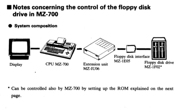

Be aware that those cards are adapted for MZ-700. I believe MZ-800 uses another card without the need of the I/O expansion. Moreover, it seems MZ-800 has a ROM already fitted to handle QDisk: this link uses that fact to emulate QDD with an Arduino MEGA and an SD card reader.
A QDD is in a bid here but the price is escalating.
As for floppy disk, you need an MZ-1F02. Maybe the K&P version allows other floppy disk drives but reading this link is not making me confident about the possibility without modding.

hlide wrote: Mon Oct 01, 2018 8:42 pm The second card seems to be an MZ-1E05 for interfacing a floppy disk drive. The ROM seems to be modded to get two different ROM contents.
The strange thing is that neither the layout nor the amount of chips on the board fits with the pictures I've found of MZ-1E05, and one of the pictures is from https://original.sharpmz.org/mz-700/dow ... _sm_gb.pdf, which is the official service manual.
That, and the fact that it is marked with a Sharp logo, but no visible part number near the logo, get's me to think it might be a prototype board. It could also be a non Sharp board that got marked with the logo anyway.
Since the connector seems to be the normal Sharp FD connector I would guess it will work with a Sharp disk drive.
I would guess that the switch changes pin 21 (4 from top on the right side of the EPROM )between 5v and ground.
In that case it is a s hilde wrote, a way to choose between two different programs.

I'm not sure it is a prototype. They may be two revisions of the MZ-1E05 with a different layout.

It is MZ-80AFI floppy disk interface. It is a predecessor of MZ-1E05. It looks like it has dual ROM adapted for MZ-700.
https://original.sharpmz.org/mz-80a/dow ... i_diag.pdf
