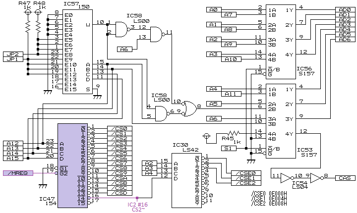

Hi to all you out there!
I have a question about MZ I/O address range:
I want to experiment with a DIY serial interface using 167c550 for MZ80K.
I have examined carefully the MZ80k service manual and designed the folloing schematic :
ΝΟΤΕ: this circuit HAS NOT been tested yet!
My question is I want to use IORQ pin of the expansion . What is the IORW address range I can use in MZ80K memory map?
As I have already connected A0-A7 the range will be $F8-$FF. Is it accessible or not?
Thank you in advance as I could not find a specific memory map for the MZ80K.
(* I want the interface to be accessed via basic)
Alex

Re: [MZ-80 K] Serial interface through I/O ports $F8-$FF
Posted: Wed Dec 05, 2018 10:11 am
Beware! $F000-$FFFF are used for ROM like floppy disk drives.
On MZ-80 K, $Ex00-$Ex27 is the I/O memory mapping, so you can get an unused /CSEy signal where its address range is [$Ex00 + y*4, $Ex03 + y*4]. 'x' means whatever the hexadecimal digit in place, you'll get a mirror of $E000-$E027.
Since you need to access 8 registers, you'll need two /CSEx. Let us say you use /CSE8 ($E020) and /CS9 ($E024). So you will get $E020-$E027.
However, if you keep your IC3A as such, it will turn the address range for your device into $E0F8-$E0FF, which is outside.
That's an issue indeed. On the other end, having /CSE on IC47 #16 should be enough.
Connect /CSE (IC47 #16) instead of /IORQ to CS2~ (IC2 #14). An active /CSE already includes an active/MREQ.
Your IC3A output connected to CS1 (IC2 #13) and A7 connected to CS0 (IC2 #12) will constrain the address range to $E0F8-$E0FF which sounds perfect for me.

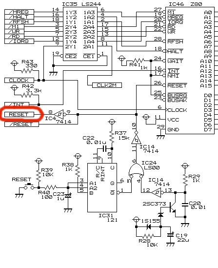

The schematic comes from here: http://www43.tok2.com/home/cmpslv/Mz80k/EnrMzk.htm.
Notes:
- Z80 RESET is active on low level! So be sure IC2 wants a /RESET and not RESET!
- If you can grab the /CSE which isn't accessible through the extension bus, the rest is a piece of cake.
Posted: Wed Dec 05, 2018 10:50 am
Revised my last post as I made a big mistake in the way to handle /CSEx. In the end, using /CSE should be enough.
Posted: Wed Dec 05, 2018 12:34 pm
by dat-alex
I had been informed about this decoding scheme but with your clear explanation I finally understand it. Thank you.
But , as I want to use only expansion port without the need of soldering inside I can use the MREQ with the following address decoding acording the new schematic below:
I know this ,but as I am not going to use a FD I think this sould be fine.
I think this is not a problem either as according to your (perfect) page link as you can notice expansion port is feeded with a logic high OUTPUT RESET signal , isn't it?
Posted: Wed Dec 05, 2018 1:46 pm
RESET: you're lucky! :) I didn't check it and wasn't sure because in numerous schematics or tables about SHARP MZ you can read some signals named without negative marks while they are active negatively. So always double check as you did ;).
