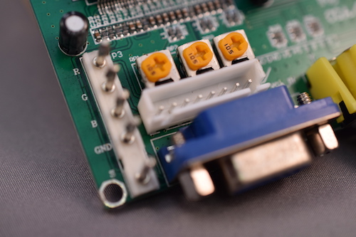

https://www.retrogamingcables.co.uk/GBS ... -CONVERTER
You can see pins R, G, B, GND and S: you can connect then to the R, G, B, VIDEO and GND of MZ-700:
This card has several connectors you can use.
If you want HDMI, there is a way: SCART>HDMI but with a mod to do.

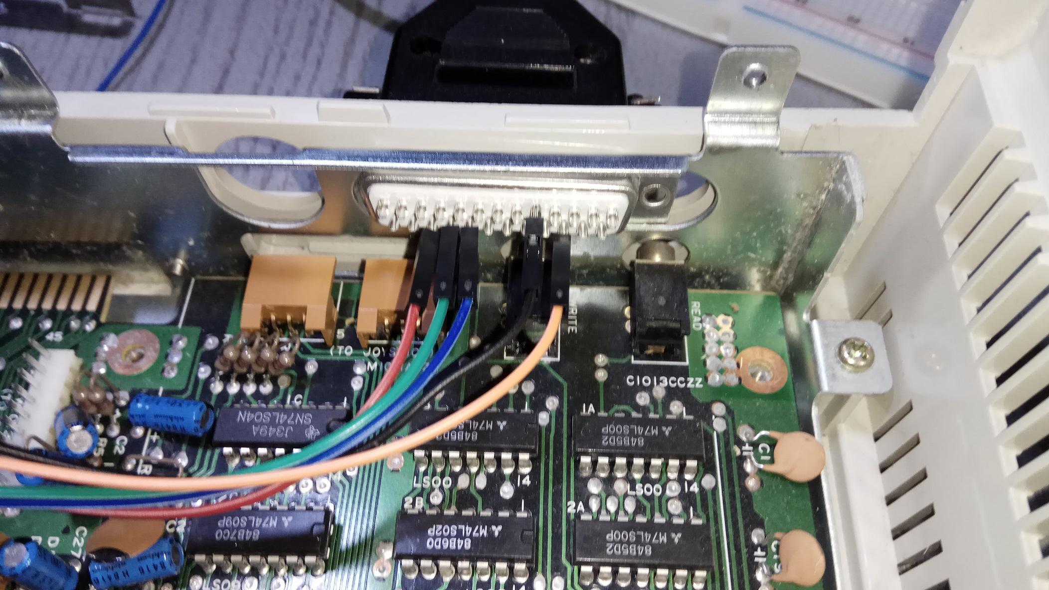

Re: MZ-700: is there an easy way to get a modern video output?
If by SCART > HDMI, you mean RGBS > SCART > HDMI, be aware you may need a mod.
On the SCART you have two pins #8 and #16.
- Pin #8 is said to select a 4/3 or wide format according to the voltage.But you can leave it not connected as a modern TV allow for you to force the 4/3 or wide output.
- Pin #16 is said to select RGBS or composite output according to the voltage. In fact, it is always composite but when setting appropriate voltage you can allow picture-in-picture using RGBS. However, most modern TVs have issue with this line if RGBS is not set permanently. I had the issue with an Atrai 520 STE because it uses HSYNC to feed pin #16 and with MZ-700 because pin #16 was not connected.
So it is important to find a way to connect the pin #16 with a voltage ranging 1V and 3V. I believe 2,5V is a good compromise because you can capture 5V and use voltage divide bridge with a resistor of same value for each branches and then feed 2.5V to pin #16.
Regarding SCART wire, I simply use an Amiga RGB SCART I had in tons - that could be a good start for testing.

hlide wrote: Thu Dec 06, 2018 3:29 pm https://www.retrogamingcables.co.uk/GBS ... -CONVERTER
I have tried this card with my MZ-700 but could not get it to produce a stable picture.
