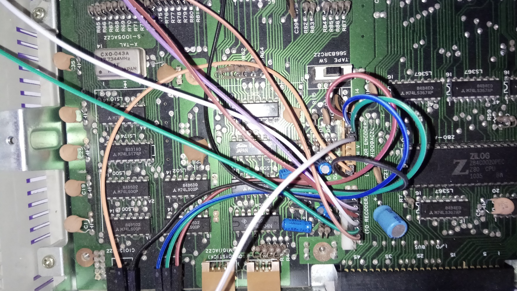

I have finally been able to test the MZ-SD2CMT with my MZ-721. I removed the data recorder and wired up the Mega2560 to P-12 like this:
P-12        Mega2560
 4 Motor - SSI  16 MZT_MI
 5 Sense - SSO  18 MZT_CS
 6 + 5V
 7 Write - SDI  15 MZT_DI
 8 Read  - SDO   3 MZT_DO
 9 GND   - GND
+ 5V on P-12 is not connected; I use the usb to power the Mega2560 as I need to use the serial monitor in Arduino IDE for the time being.
The wiring is like this in the source code; I also tried changing pin 3 (MZT_DO) to pin 17 as the README file says. But - the MZ-SD2CMT doesn't work.

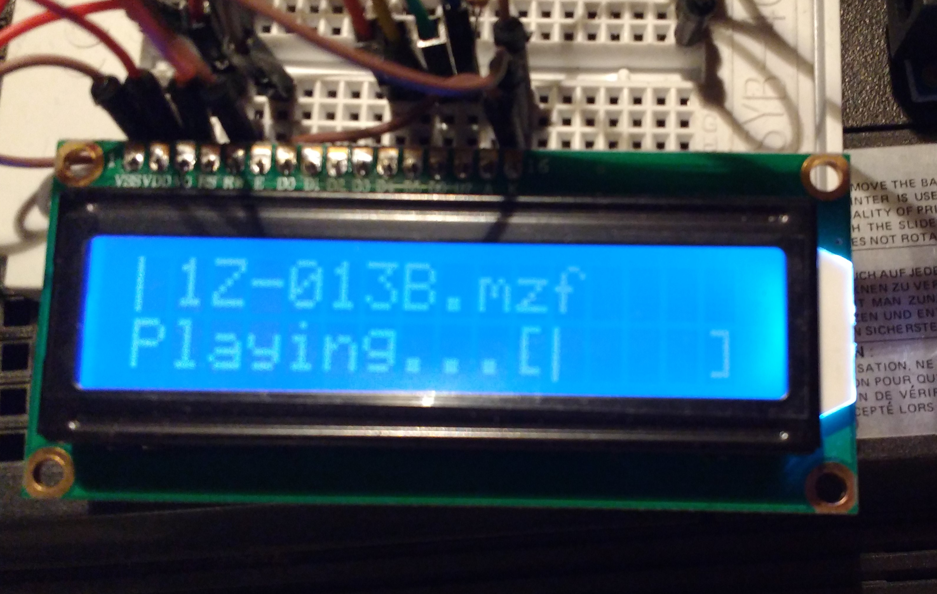

I press 'L' in the monitor, the select button on the MZ-SD2CMT (I used 1Z-013B.mzf as a test file), the display on the MZ-SD2CMT shows the playing message and nothing more happens.
I have also put back the data recorder and verified that it works; I can still load basic from real tape.
Any hints?

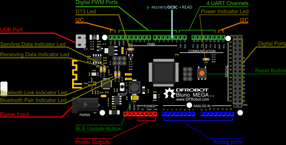

The source is working. The README.md is not updated. You need pin #3 because I use it to emit a one-shot pulse (PWM).

This is the CYAN line (3 - PE5/INT5/OC3C -> READ)

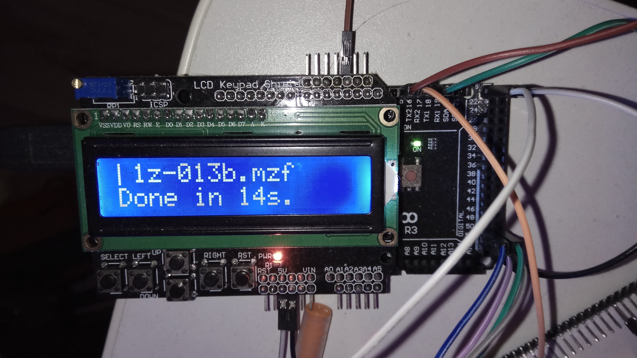

Here is my video showing my MZ-SD²CMT loading BASIC 1Z-013B in ultra-fast mode.
I navigate to 1Z-013B, press RIGHT button to activate ULTRA-FAST mode, then SELECT button to launch loading. After 14s, BASIC runs.
https://youtu.be/KOKyJIB4FTE

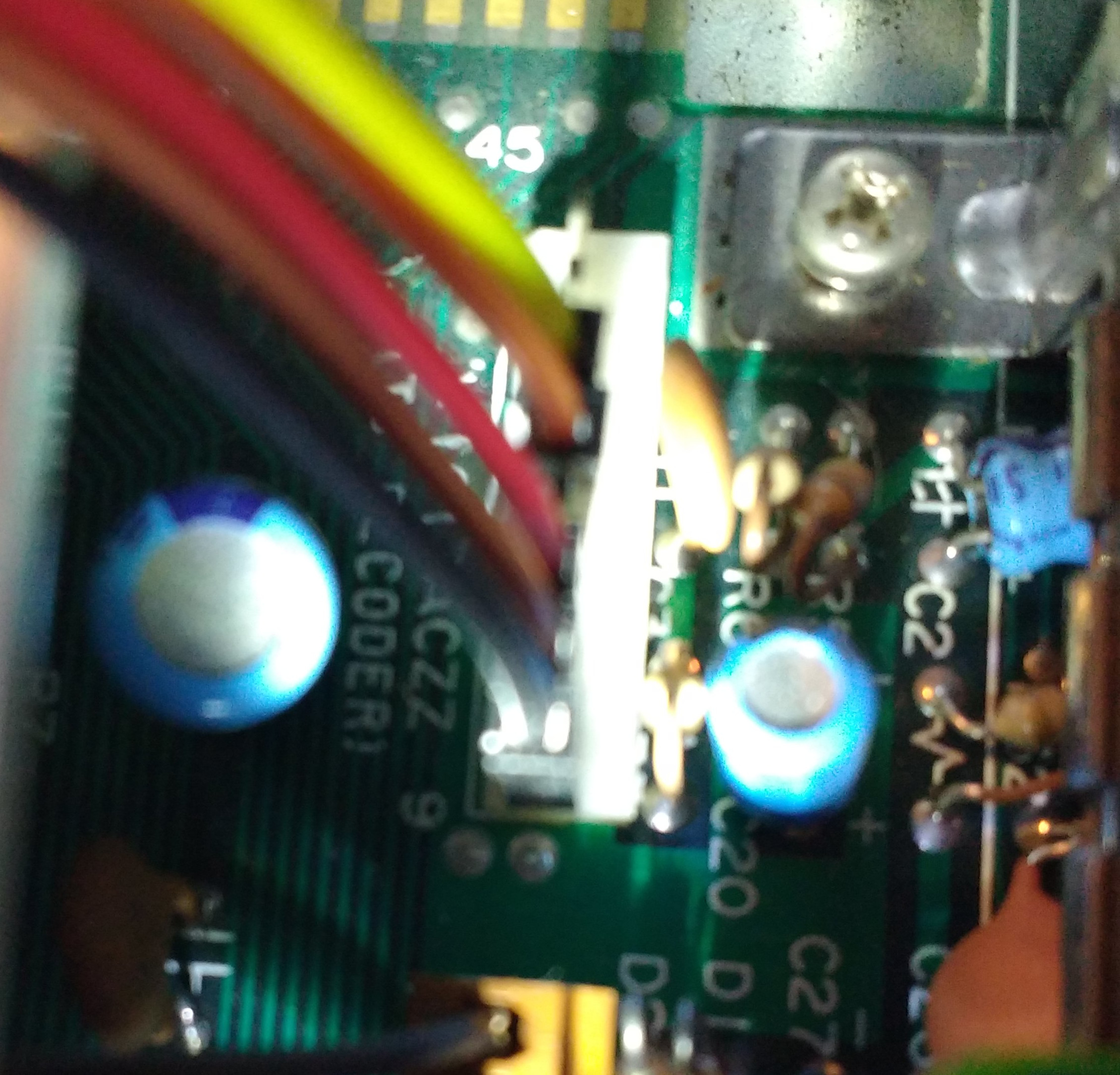

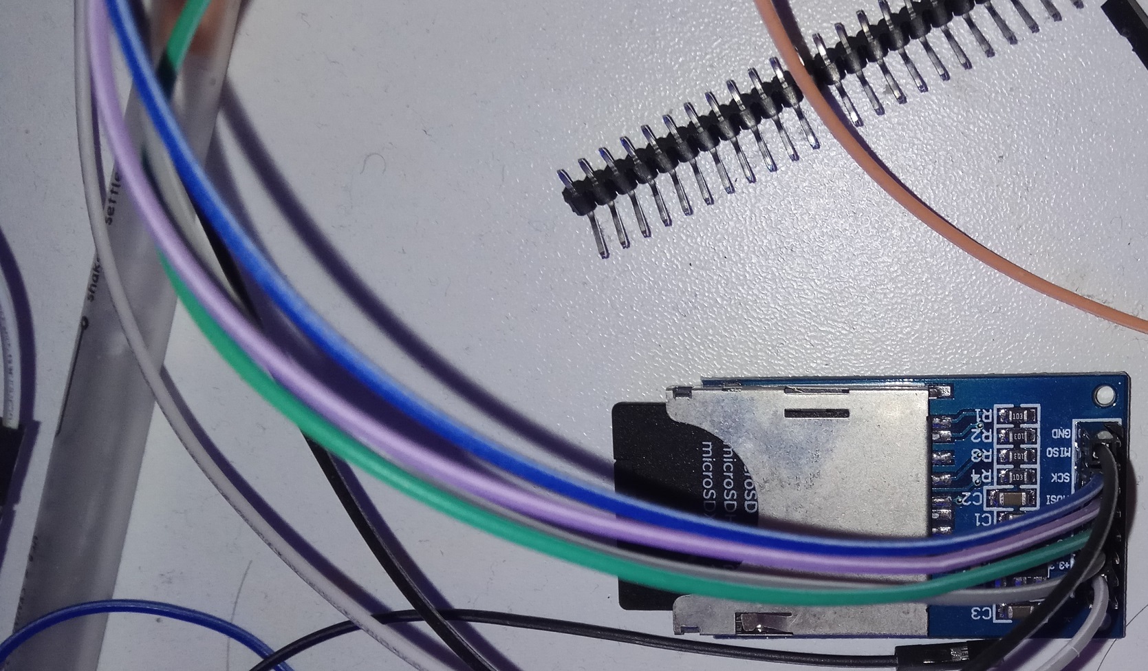

Some pictures show how wires are connected:

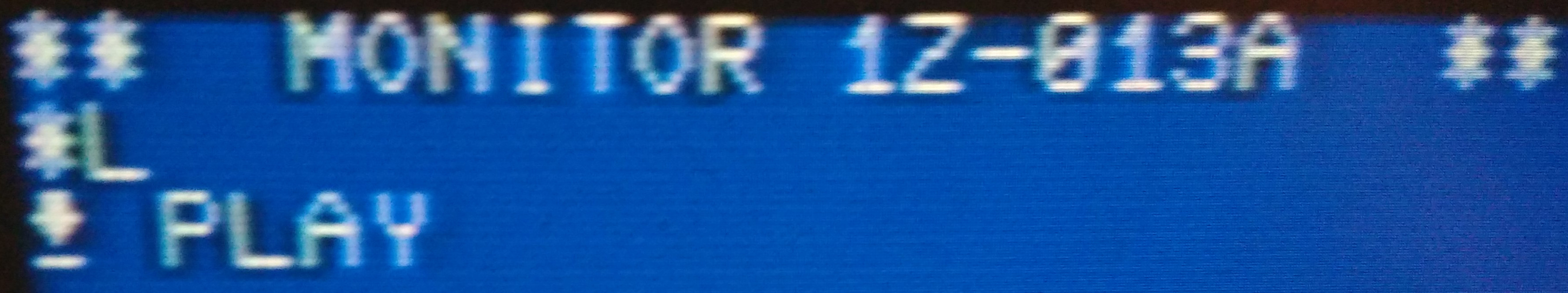

This afternoon I tried again. Checked my wiring - it looks ok

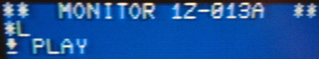

Testing it - I do the same as you; I press 'L' + CR in the monitor:
navigate to the file on the mz-sd2cmt and select it:
(it doesn't matter if I select ultrafast mode or not)
The problem is that nothing more happens after that.
no "Loading" message on the MZ-700
no progress bare updates on the mz-sd2cmt display
