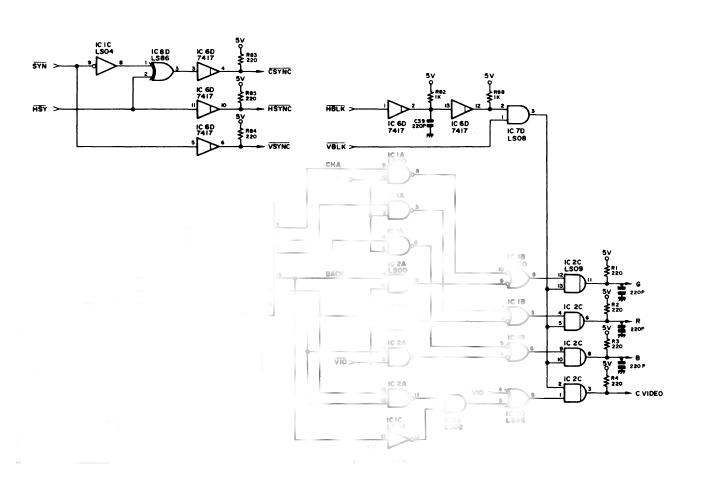

Argh... you're right. For some reason, I thought my SCART cable was using CVIDEO but I checked again the connection and it is /CSYNC indeed as it makes more sense here. What annoys me is the difference between CVIDEO and /CSYNC as I would expect/CSYNC be mixed in CVIDEO.
But the schematics says /CSYNC is an XOR of very short signals /SYN and /HSY while CVIDEO mixes an AND of very long signals /VBLK and /HBLK.

/SYN   | /HSY   | /VSYNC | /HSYNC | /CSYNC
0      |  0     | 0      | 0      | 1
0      |  1     | 0      | 1      | 0
1      |  0     | 1      | 0      | 0
1      |  1     | 1      | 1      | 1
That looks correct: either /SYN or /HSY must be low to get /CSYNC low. If both is low, then /CSYnc must be high so the TV can still detect their changes.

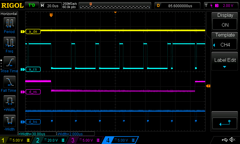

PAL /csync:

Lovely scope output, is that a PC based scope or standalone? I use a Micsig 4 channel standalone device which is excellent too, just great to have such detail. Gone are the days of the old analogue Tektronix (which I still have but has so many spider webs and rust, I doubt it will get used again!!!!)
