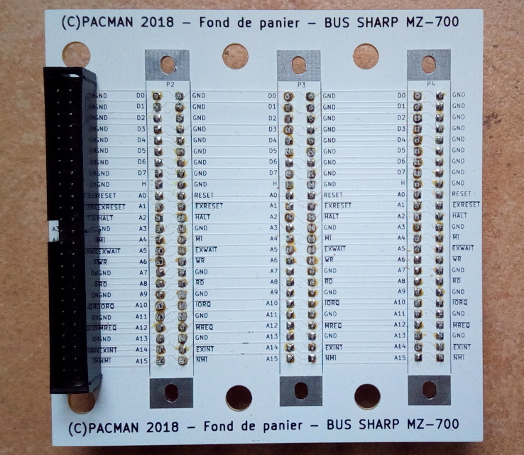

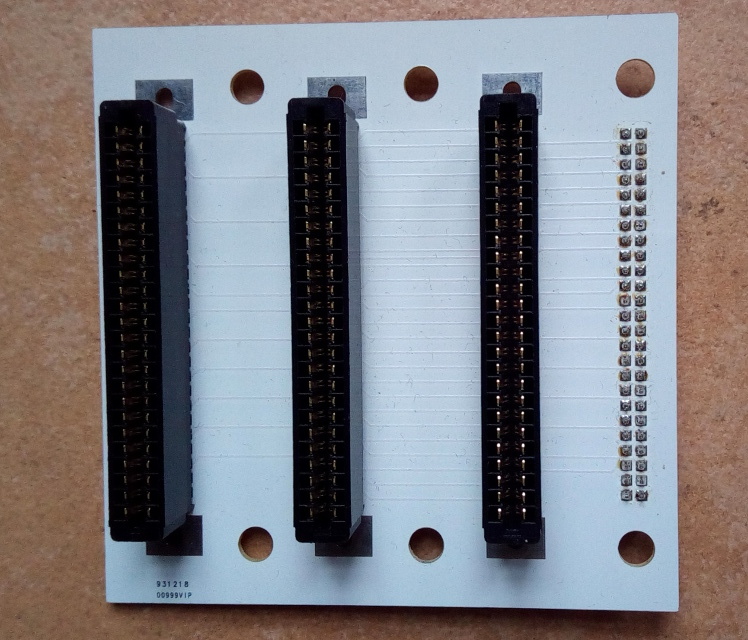

Here's a small expansion card for a Sharp MZ-700 backplane. It measures 10cm x 10cm, double sided and can hold 3 cards.
I will publish the KiCAD plans soon.

below / dessous
below / dessous
Above / dessus
Above / dessus

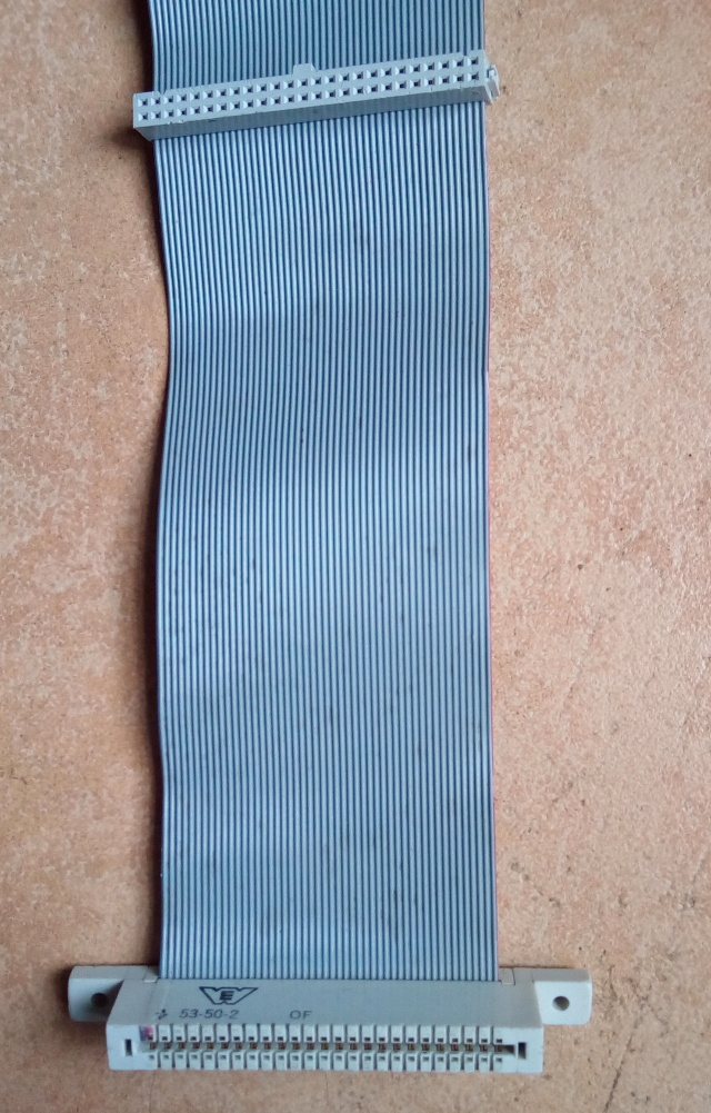

Sharp MZ-700 Connection / Connexion Sharp MZ-700

As for me, I ordered 5 of them to JLCPCB:
They are normally for Amstrad CPC (I also have them) but they should be totally compatible with MZ-700.
